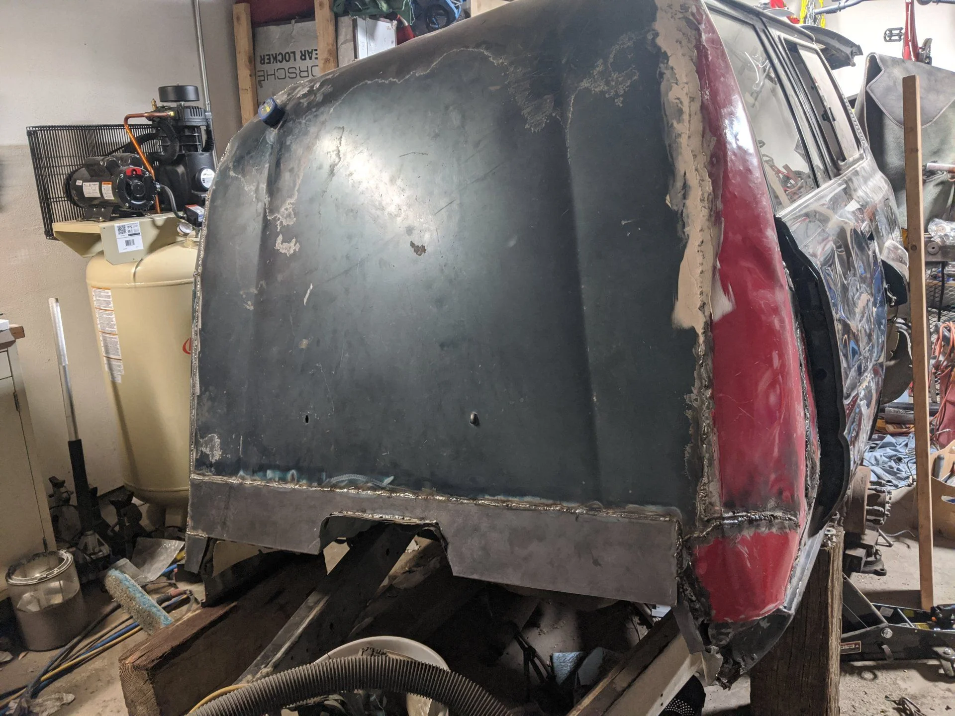

Here's a few more pictures for you all.
Things I found out:
I don't weld sheet metal very well, but that's because I don't prep well. I found out that I don't prep well.
Other things is that the gas tanks actually attached to the body of the car not the frame oh, so I waste some time looking into that.
Anyway things are coming along.

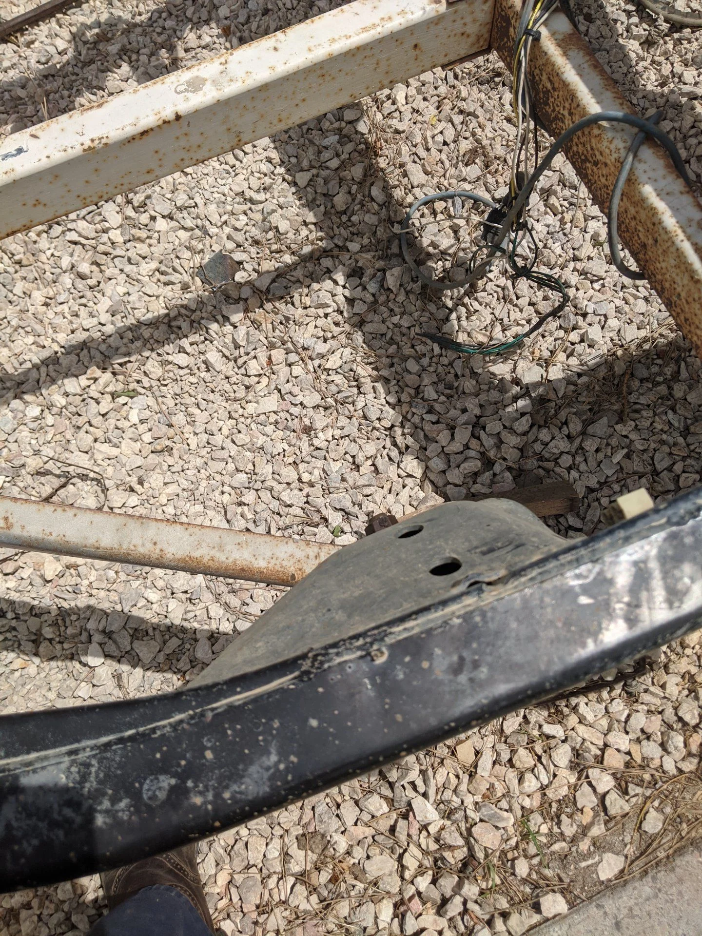

I'm still planning on using the gas tank as a sort of reserve tank. One thing I'm going to do different than my original plan is to use a MUCH lighter weight frame to mount the trailer on, and use a trailer axle with brakes on it. I was planning on just using the frame like an old pickup trailer, but I ran into a couple of problems:
1: I sold my go-kart, so I have a trailer frame, that is registered in my name taking up room in my driveway
2: My State is kinda a PITA for home-made trailers. I asked a cop yesterday if I could just ditch the flatbed and mount the body on that and he said it would be fine.
3: Doing brakes on the trailer properly would be expensive and a PITA as well
4: I can have an extra axle laying around should I need it, and I will scrap the frame ( I already cut the S____ out of the front, so it's no longer usable (Changed my mind a little late on this one. ) Anyway, it will be closer to the setup seen posted earlier. I will likely weld on the factory mounts to the new trailer frame. As soon as I do that, and waterproof the thing, I can have my garage back again!
I will need to buy an axle with electric brakes, but that will only be around 400 bucks out the door. I do plan on using stock wheels for a more legit look. I still have a ton of bondo to do and little bit of welding, but I think I am getting closer by the day.
Okay, here's how far I've gotten so far. I finally got the frame pulled out from underneath the rear of the vehicle. I'm definitely going to ditch the super heavy rear axle and associated hardware for a lighter trailer axle. This is a very preliminary mock-up. I'll probably chop the frame at the third mount because that's the last one on my cab. I have some brackets to make. Probably going to upgrade the leaf springs and axle, especially to one with an electric brake.

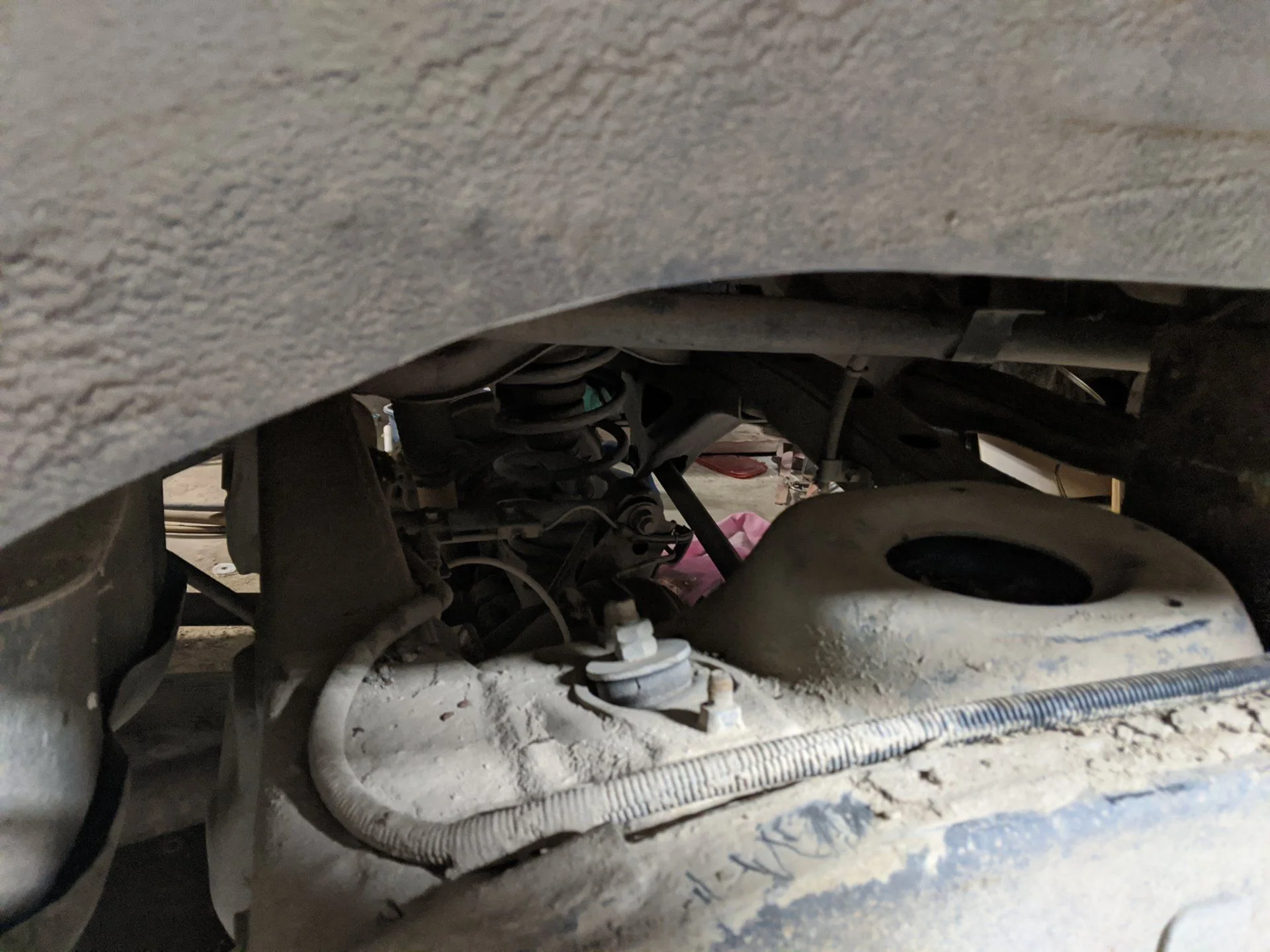

If there was some way to retain the rear suspension by cutting all the mounts off the rear axle and putting them on a straight axle the rear suspension on an 80 Works real well off road. To me that would be a perfect setup just depends on how much work you want to do.
You can also leave the FF rear axle on if it's a 93+ and remove the differential and axles, just plate the rear bearings and plug the spindle and your golden.
Keep the springs, shocks, control arms, etc, with less weight.

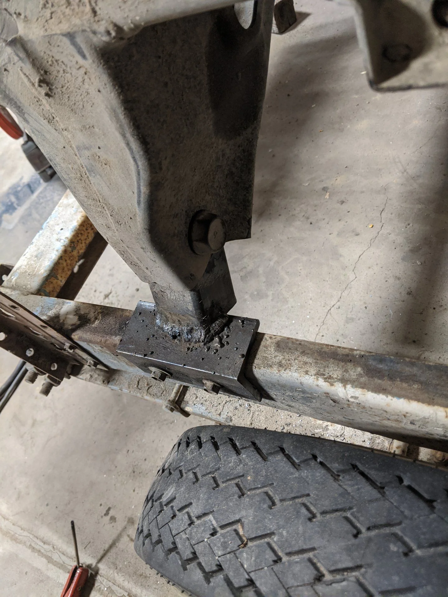

Big day yesterday. Solid 10 hours of work. So the front mounting points are just a little modification to the frame setup. Actually worked out really well, alignment wise. Once the was done,. I pulled the trigger and cut off the front of the frame

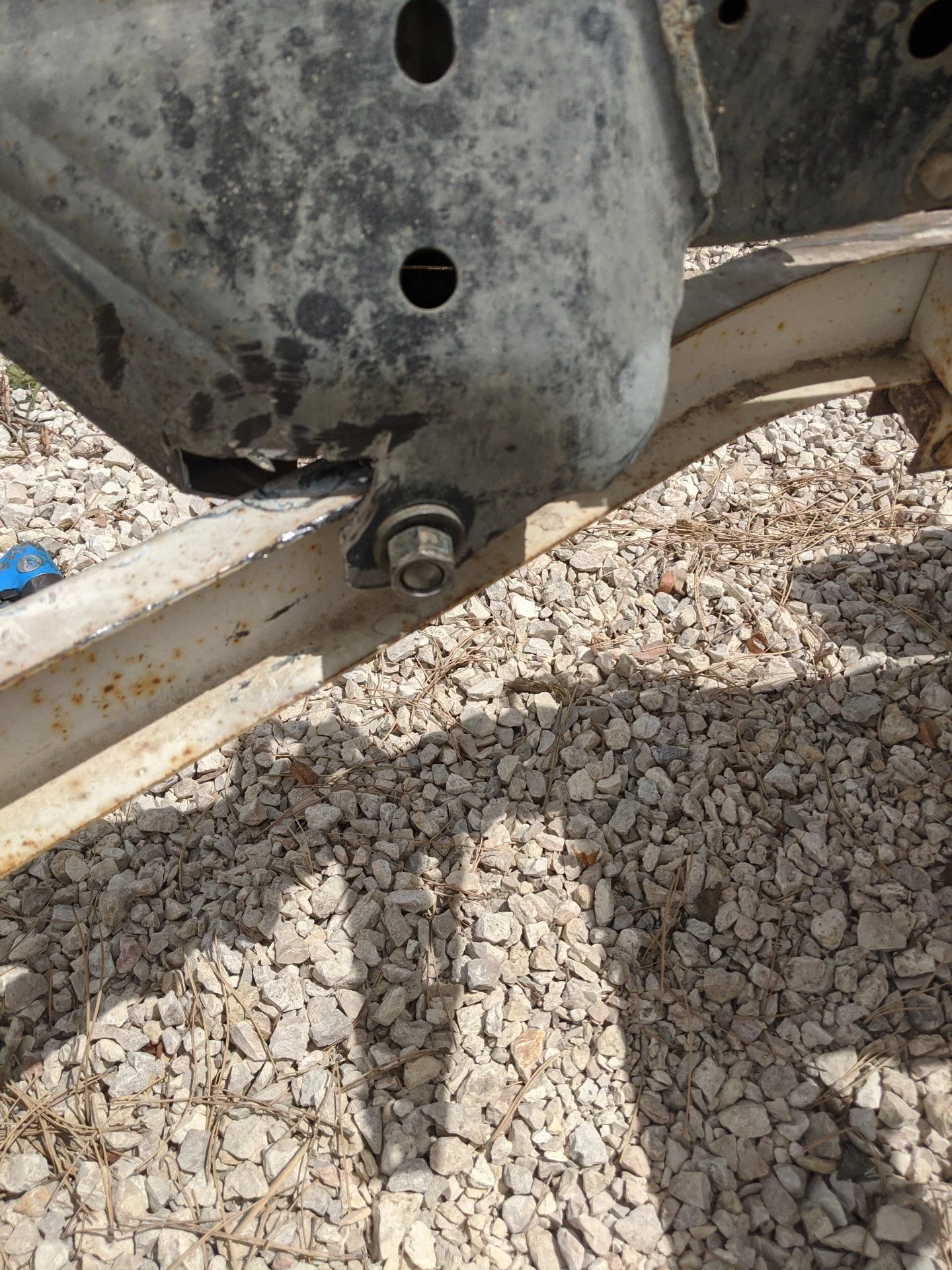

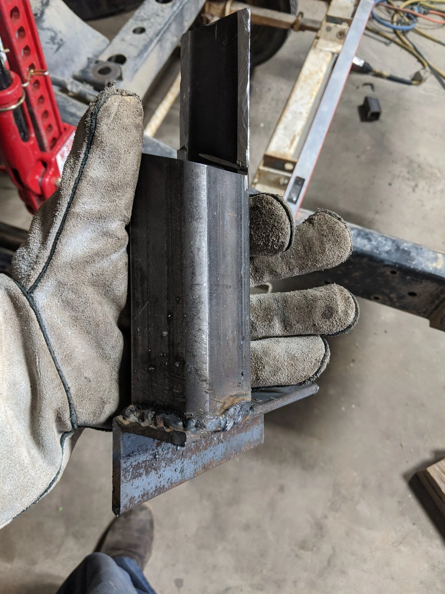

Next was the rear mounts. I pulled into the garage too get some shade, and started fabricating. I wanted to use the existing hardware as much as possible, so I well that amount that fit the first suspension crossmember brace.
Since the other side doesn't have that brace I just had to make something that went straight from the trailer frame through the frame of the truck. For all the hardware on the truck side I just reuse the bolts that hold on the suspension pieces. Very stout.

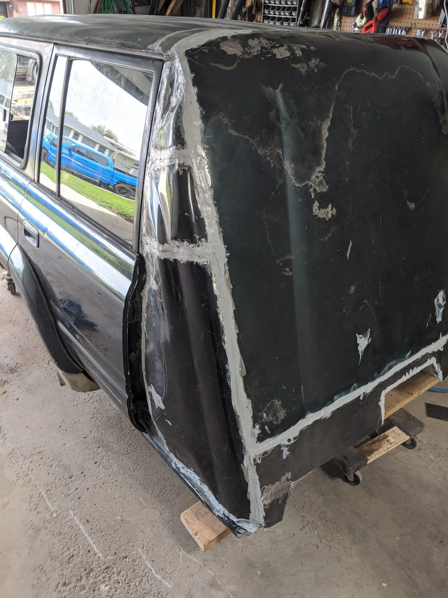

The night before I took some Sikaflex after grinding down all my ugly welds and sealed off my front of the trailer. The stuff works really well apparently. I guess it's paintable after a while as well so that's what we're going to do next.
