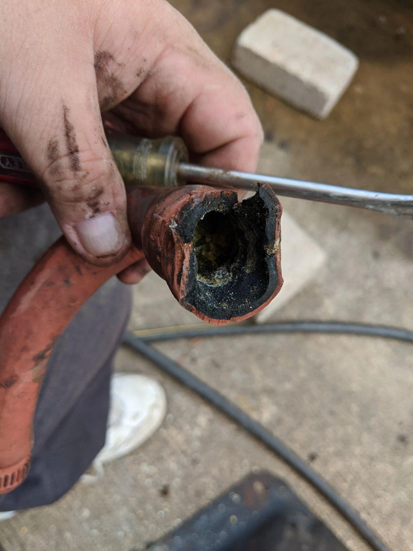

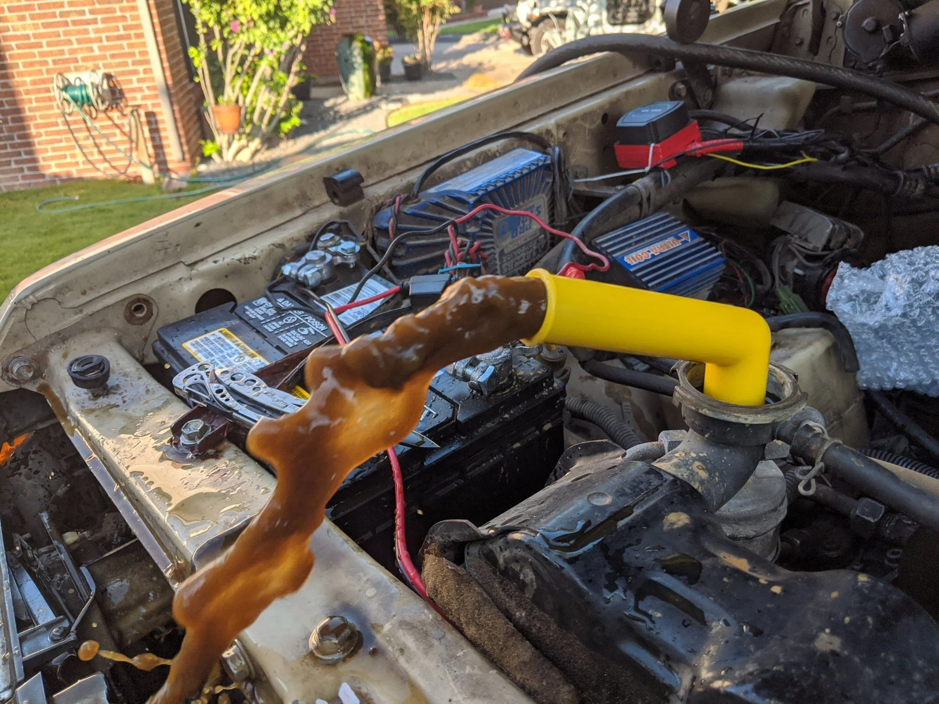

Flush the tar-nation out of the coolant system,

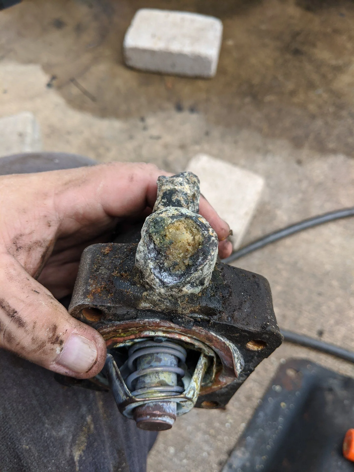

Remove upper therm stat housing to find nasty concretions and a damage upper housing.

You certainly have a lot of 'tar-nation' in your cooling system. Wow.
Upper thermostat housing
Upper thermo housing
Got new housing, going to install it, need to take the head off and check the internal cooling passages
Put vinegar straight on it, no bubbles at all, so what ever it is, it's not Texas hard water lime deposits.. Trucks been in Texas its whole life.

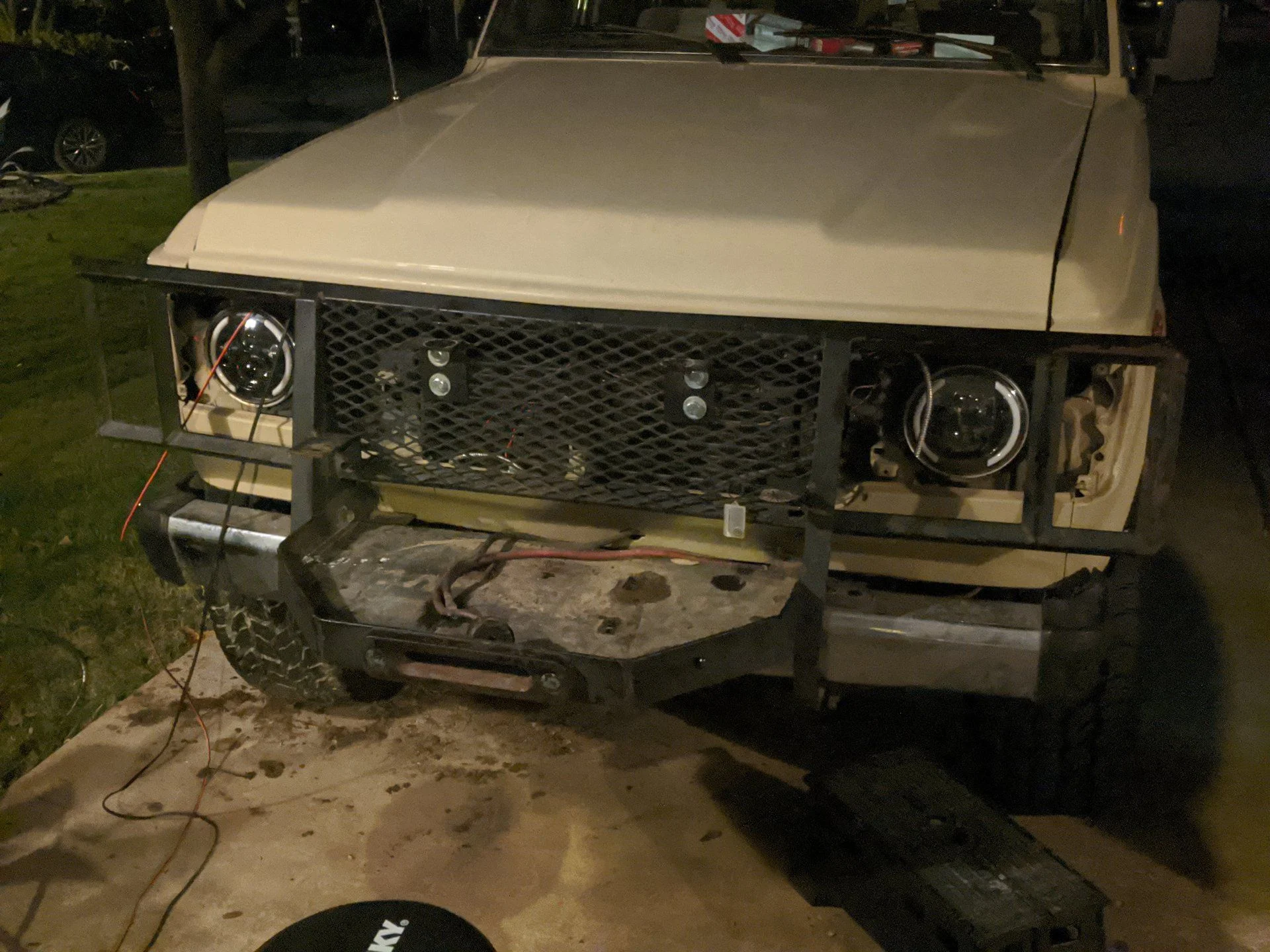

Need to get a radiator, taking off the brush guard. Too hard trying to work around it.
Last 4 bolts are
Carriage bolts that of course are spinning, hate to grind a slot in them, but that's my plan for tomorrow

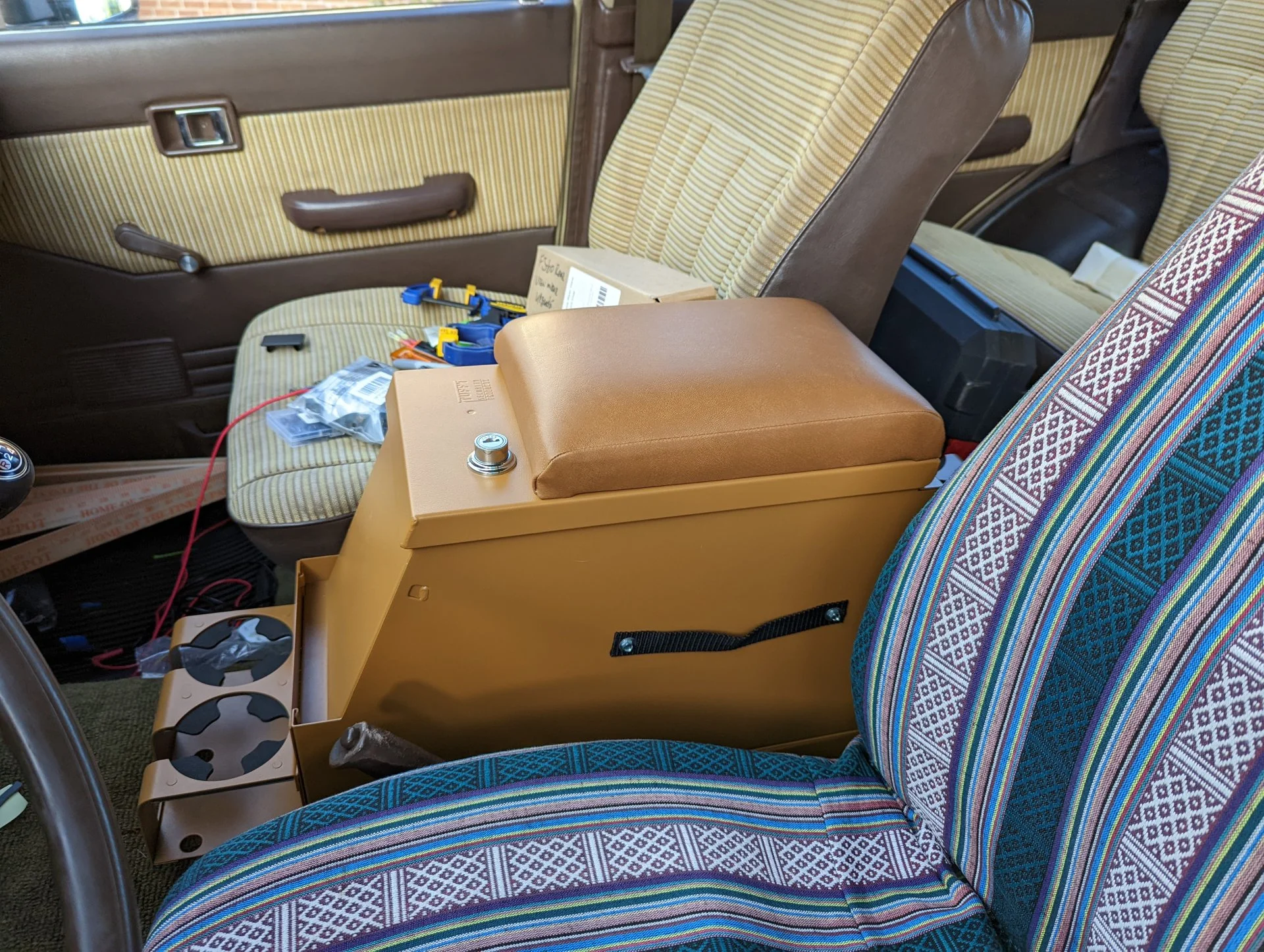

Putting in a tuffy console and a magnetic kill switch.
