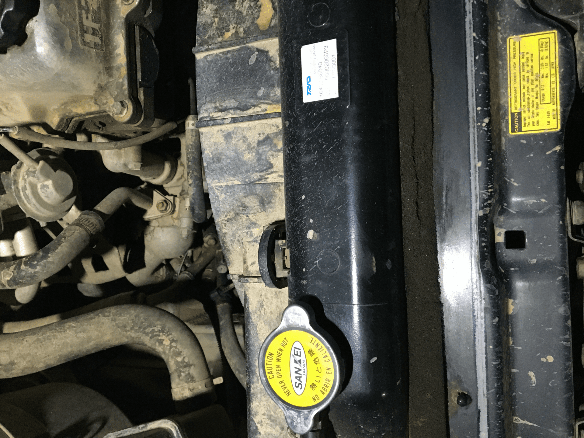

Jumping in on this thread too, to note, I've been experiencing, noticed this bubbling in my cooling system. Notice it overflows only out of my overflow tank, which just happened when traveling to Carmel Valley and back home. I just ordered a new OEM radiator cap, thermostat and thermostat gasket. Will try the radiator cap first and see where that gets me. I've replaced every coolant related hose over the last year and a half, including that PHH, which is a PITA. :)
I'll update on how things go once I replace the radiator cap. FWIW - I have a TRAD radiator and San Kei radiator cap.

TRad is the factory OEM replacement radiator.
Definitely get an OEM cap and that will help. May even do that and wait ion the T-Stat. It may solve the problem.
