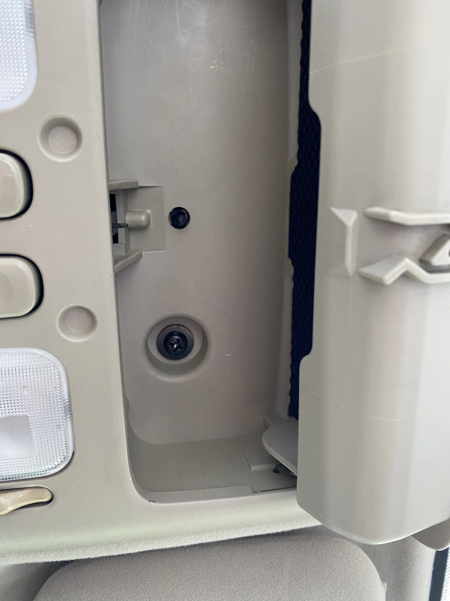

Popped off the overhead console. First was to remove that screw. Then use your trim tool to lightly pop it down from the top. You'll see the clips in the next photo. It needs a decent amount of force.

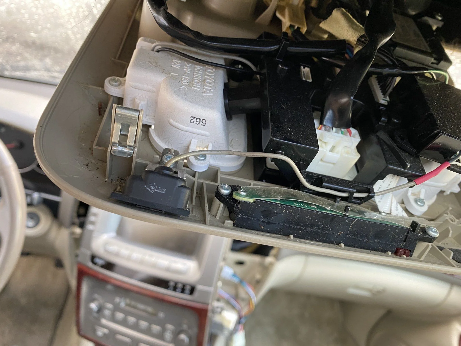

Factory mic in factory location. I started to loosen the clip but wanted to snap a photo so thats why the metal clip looks a little loose. Normally that thing is snug.

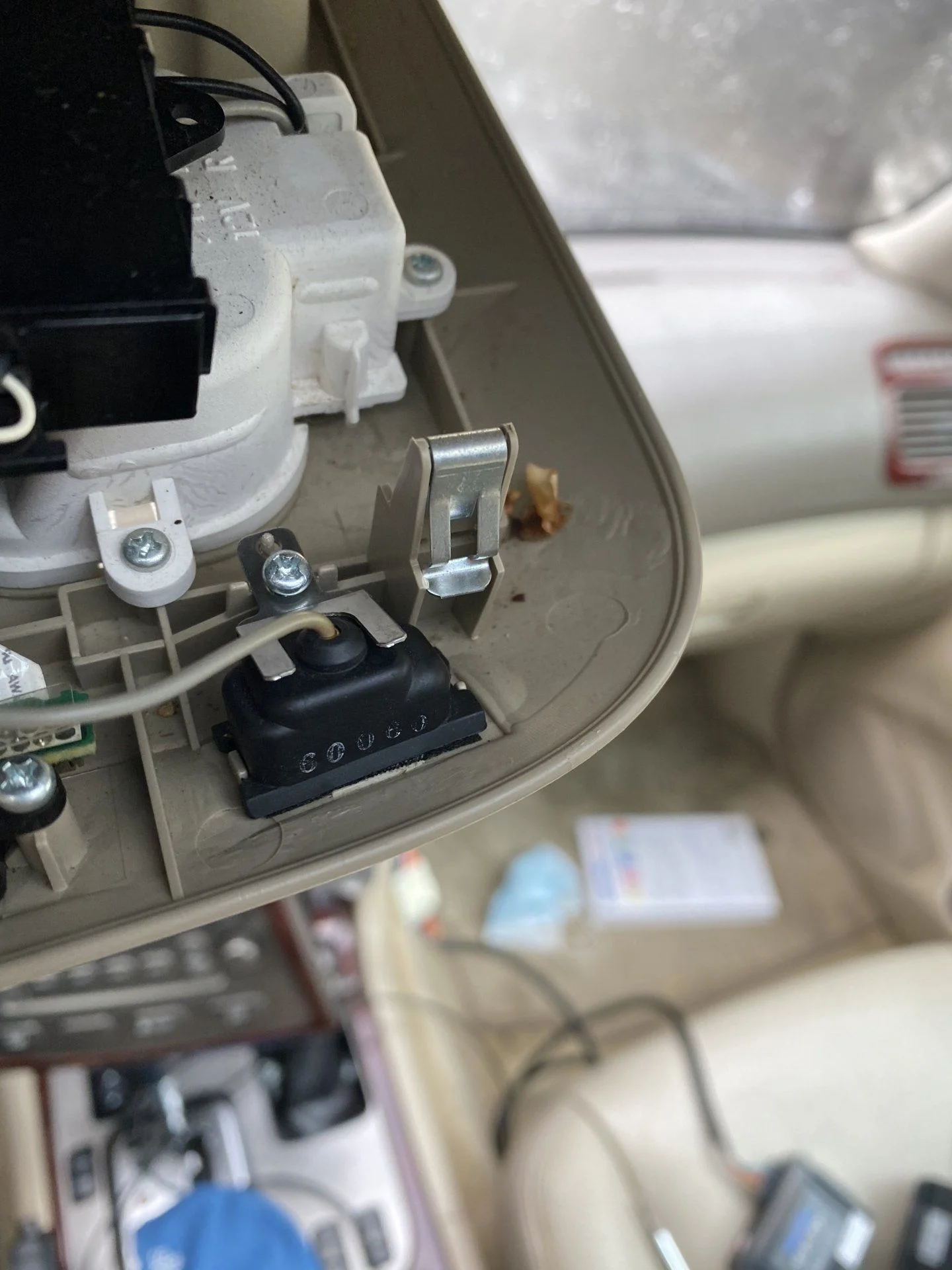

My plan is to place the BT45 Mic where the factory mic was. First, I moved the factory mic to the right side. It looked like that the left and right side mirror each other. I'm sure for Right Hand Drive LC's, the mic goes there. So I put it there just in case I get handsfree to work in the future? I don't know, just felt good to put it over there. I used that clip and install the factory mic on the right.
The factory mic clip in the right hand drive side. Ok, enough talking about this, its pretty unimportant.

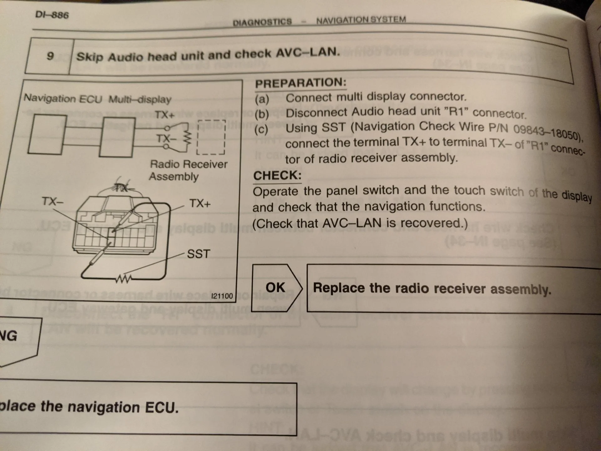

Issue: My luck I get a MFC error "check temperature connection" which seems odd given I'm switching out stereo connections.
Solution: The "68 ohm resistor" trick across TX+ and TX- (in my case wires for pin 9 and 10). 68 ohm resistor can be purchased on Amazon in pack for a few dollars.
There are so many different wiring connections for the LX and LC depending on yr, stereo, and w or w/o MFC. Mine looks like the attached. The pink w black stripe and blue in same position on next row are the ones I connected with resistor. With this, everything seems to work fine.
