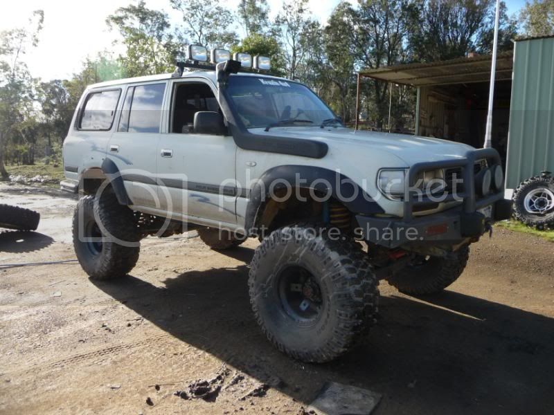

I found this pic, it looks like the arm is mounted above the axle, but it's not a great pic so it could just be the angle being deceptive. It also looks more front than top.
