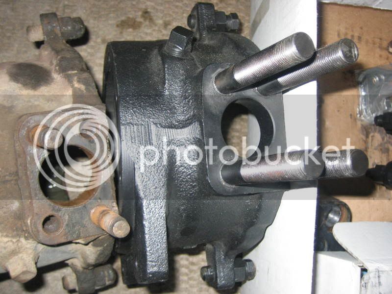

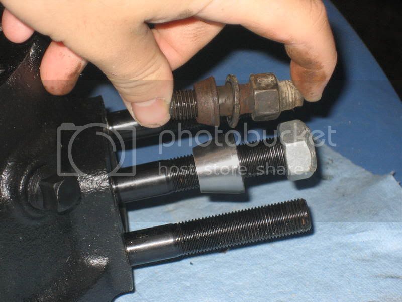

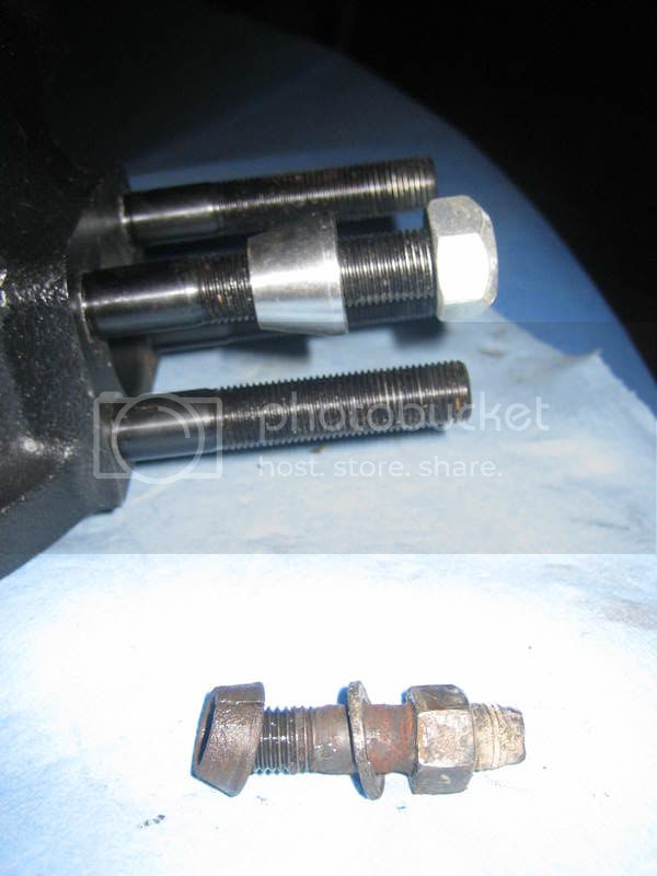

Knuckle upgrade to Dana 60 studs. I'm working on the axle tonight so I'm ready to go!
Dylan
:eek::eek::eek:FAAAAWWWWWK:eek::eek::eek:!
Where'd you source those from?
Thats not a new knuckle is it?
Drill and tap it?
Those look REALLY LOOOOONG?

Drilled, tapped, and machined for new studs and cone washers. I got them from parts mike in Sacramento and they are ARP studs.
