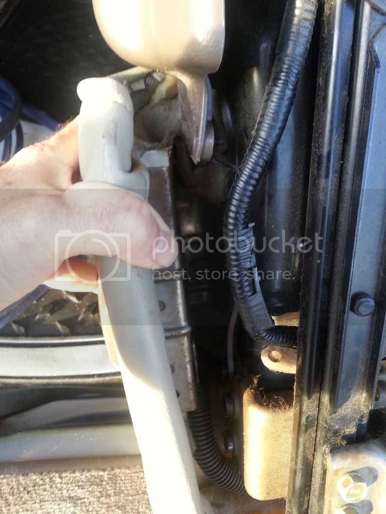

Yesterday I stopped for gas and as I got out of truck and slid across my left side/driver side seat bolster, I felt something give way a bit. Now the side of the seat sinks down when you sit on it, no longer firm and solid as before. You can now grab bottom side of the aluminum seat frame and move it around on that side. Not sure of the seat internals of how this all connects, just wondering if anyone has dealt with this sort of issue and what the fix was?
I pulled the seat out but did not see anything obvious from the limited view I had, so guessing I will need to have covers pulled to get to the root problem.

I guess the picture posted was not obvious - the seat is out and sitting on tail gate :) Nothing obvious that I see, thus the post. No worries, I left it with a buddy at a seat shop today.

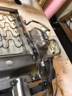

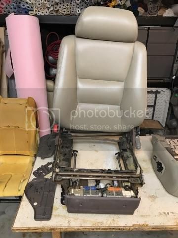

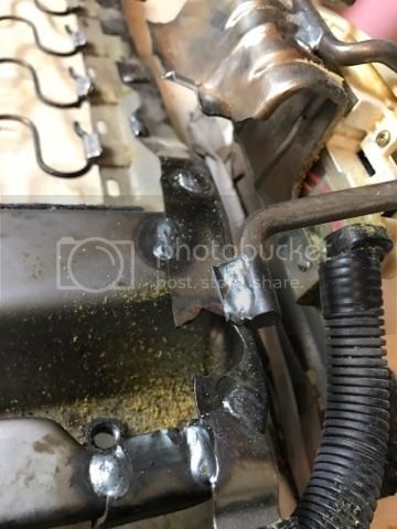

Mine broke in the same place. I uses a small triangle of 1/4 steel and a gusset and welded it back together... good as new!
