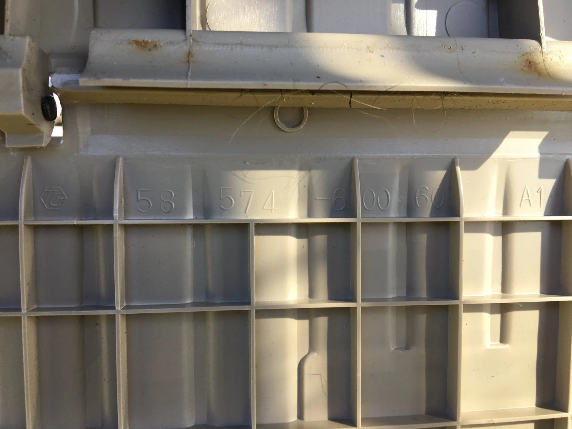

While fixing a water leak I noticed two clips were broken off the tailgate mat cover in my lx470 so no it won't securely fasten. Is there a remedy without spending $300 on a new piece? Part # is 5857460060A1 and pics below

glue gun. you can also cut those off and steal some of the removable ones from under the four door sill plastic, white, yellow or red colored I think. Also on ebay there are toyota sienna pugs like that, they are a green color that are a tiny bit bigger. I never checked the size of the ones on the piece in your picture. Mine were like that and I glue gunned to stay upright after being squished down by someone. If they were partly missing I'd glue down new ones, or try to at least.
