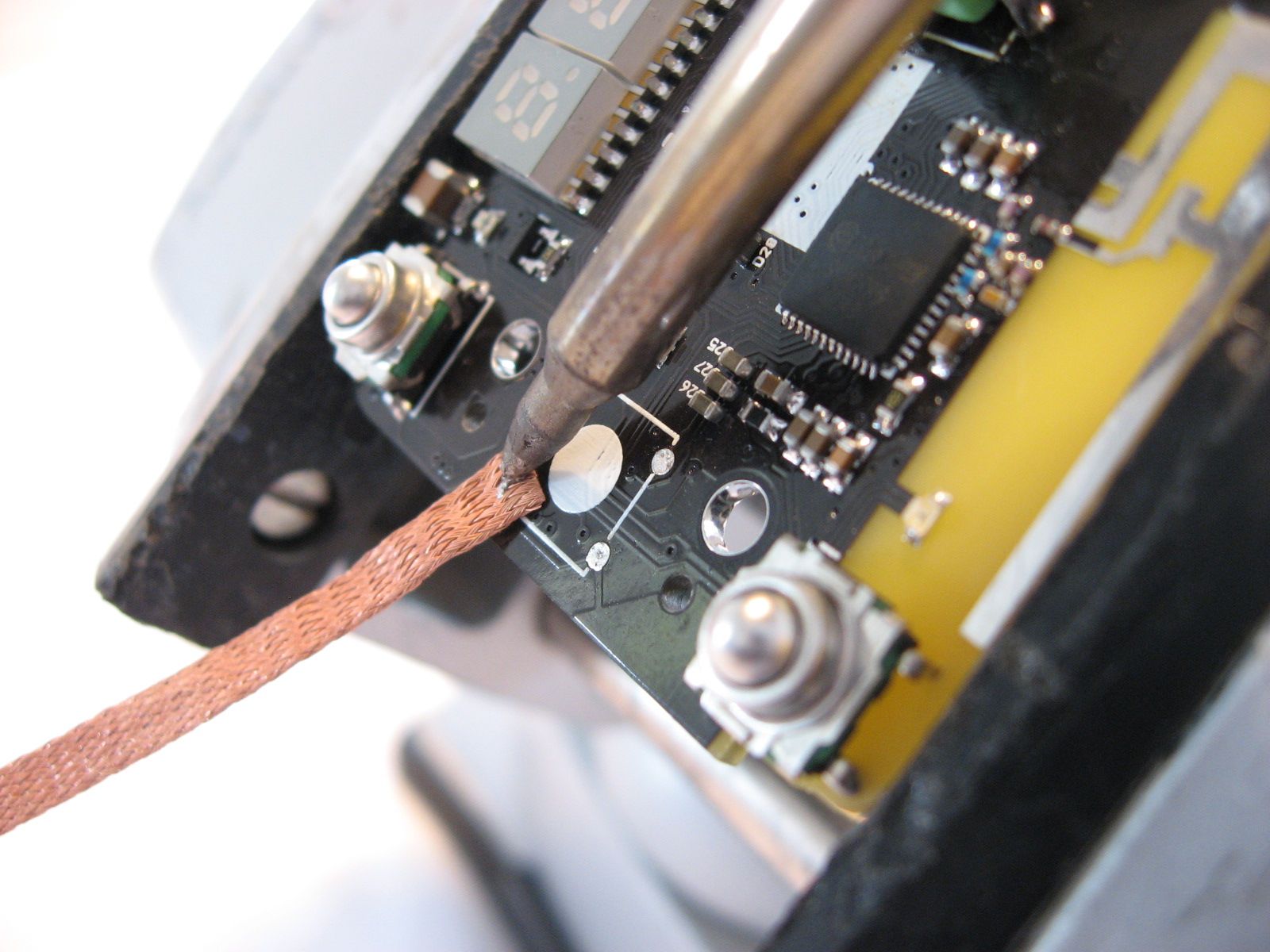

These are pics showing how to replace a similar push button on another product:
Step 1 of 4: Using diagonal cutters cut the four pins of the defective pushbutton and remove the part from the board.
Step 2 of 4: Heat and remove the four pins from the PCB using tweezers.
Step 3 of 4: Using SolderWick remove solder from the four pin holes.
Step 4 of 4: Insert new pushbutton. Make sure the part is seated flush on the PCB. Solder the four pins.

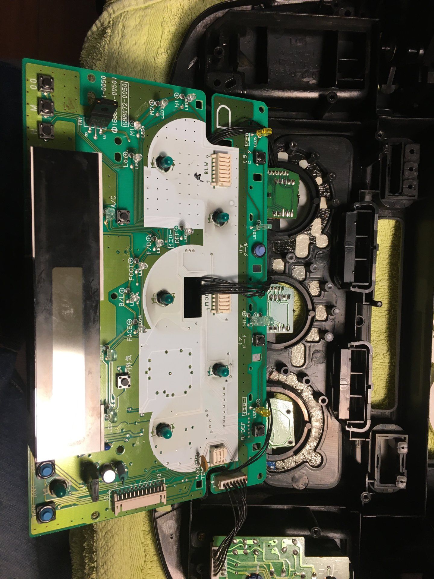

Ok, first real post here... I hope it is helpful. I was having the same issue with intermittent/hard-to-push buttons. I pulled the circuit board halves apart and removed the one that interfaces with the offending buttons (in my case, the rear air button had stopped working, and the ac was out.) I then reconnected the board and operated the surface mounted switches manually, not with the button. They worked fine. Therefore, my hypothesis is that the plastic in the circuit board is actually flexing away from the physical buttons as the cars (and related plastics) age and are used. To test this, I took three layers of electrical tape and layered them on the backside of the buttons, thereby decreasing the clearance between the buttons and the surface mount switch. I reinstalled everything and it works like new.

I fixed this over the weekend. My solution was a simple shim of electrical tape between the button back and the switch (taped to the button plastic).
It took roughly 4-8 sheets of 3M 33+ tape.
I disassembled the buttons, checked continuity and found all the switches worked perfectly. My problem was solely the physical plastic button not pressing far enough into the silicone switch. I suspect due to some minor warping of the board over time.
I would encourage anyone with this problem to first disassemble the cluster, plug it back into the car and press the silicone buttons with your fingers. If the buttons react immediately, your problem is excessive gap between the buttons and board. Shim the buttons and it should be solved.
If you go through the button test and still have problems, then consider the de-solder, re-solder or contact cleaning.
