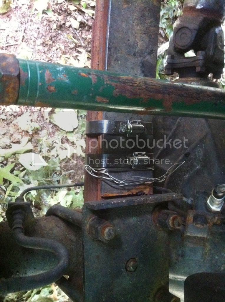

broke a leaf yesterday wheelin
Jun 30, 2008
40
156
cheshire CT.
broke a leaf spring yesterday and now time to change front springs and lengthen the wheel base. which front springs can i use to move the front axle forward about 3in.
i think i have the stock springs in there now.
stock rears are longer than the stock fronts and are offset. you can flip em and move your spring hangers for added wheelbase.
or do the above but move spring and shackle hangers all the way forward since it will be apart. Thats what I would do.
