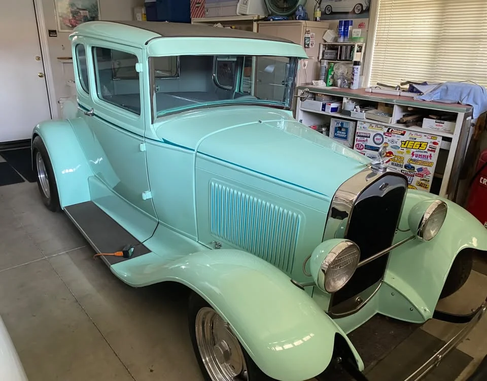

My Father was going to fix it up and never did, so life goes way too fast and I ended up losing my father in April. So I had his C10 and a 1929 Model A Streetrod. I sold the model A and decided to keep the C10.

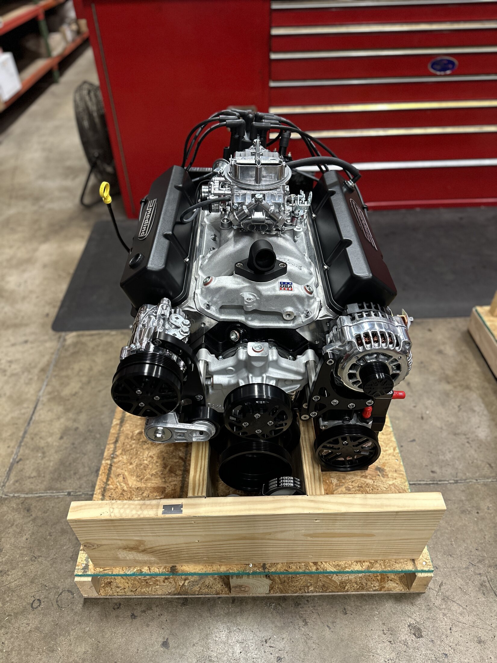

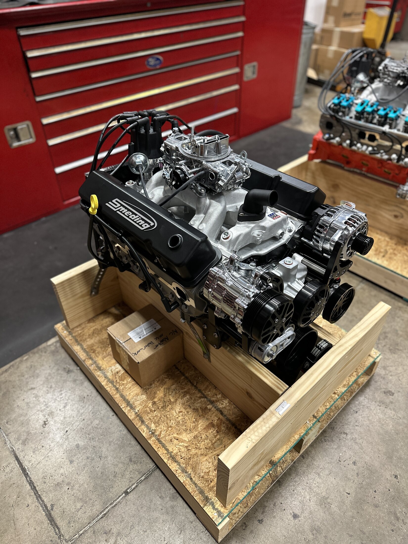

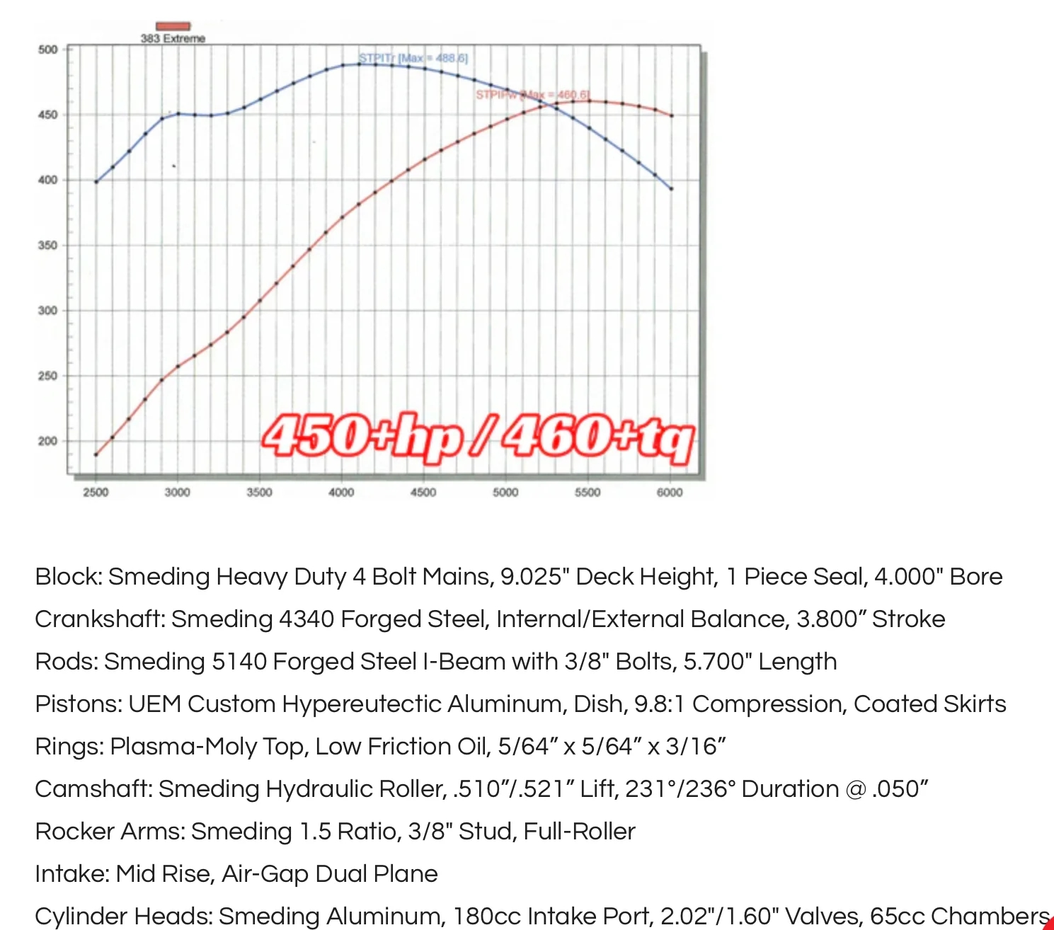

I’ve decided that I wanted to do a motor upgrade and also add A/C soo down that rabbit hole I’ve gone. I ordered Vintage Air for her and a 383 Stroker motor from Smeding Performance which should be here mid December.

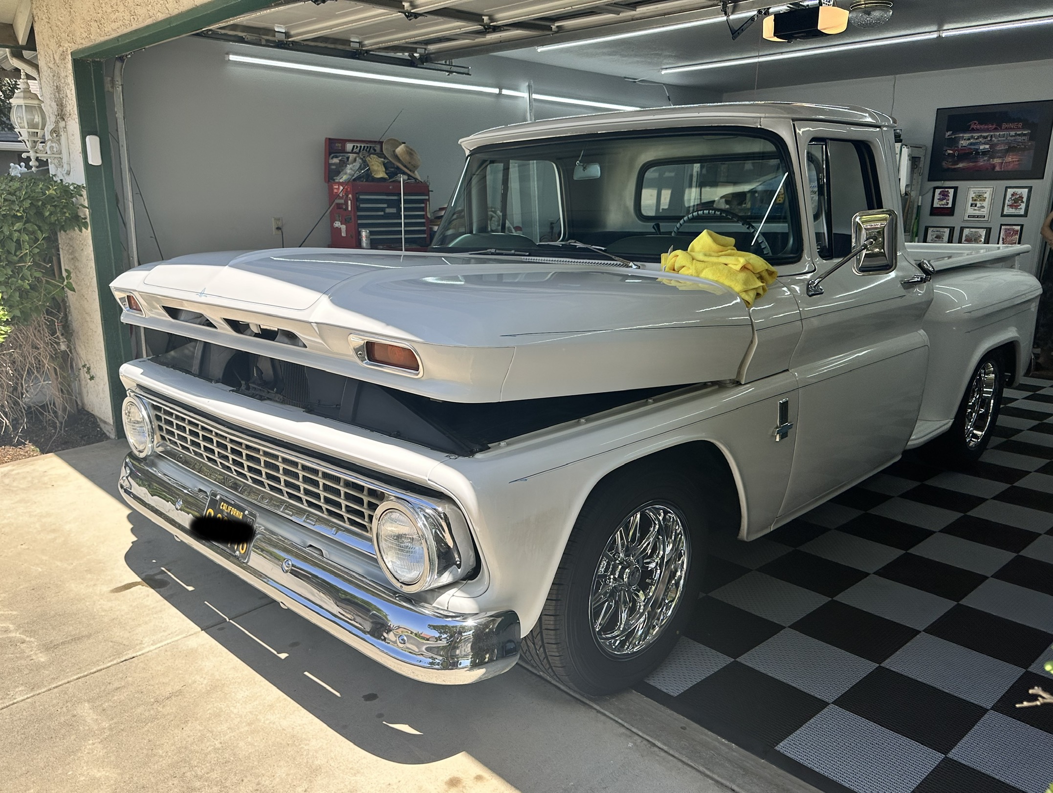

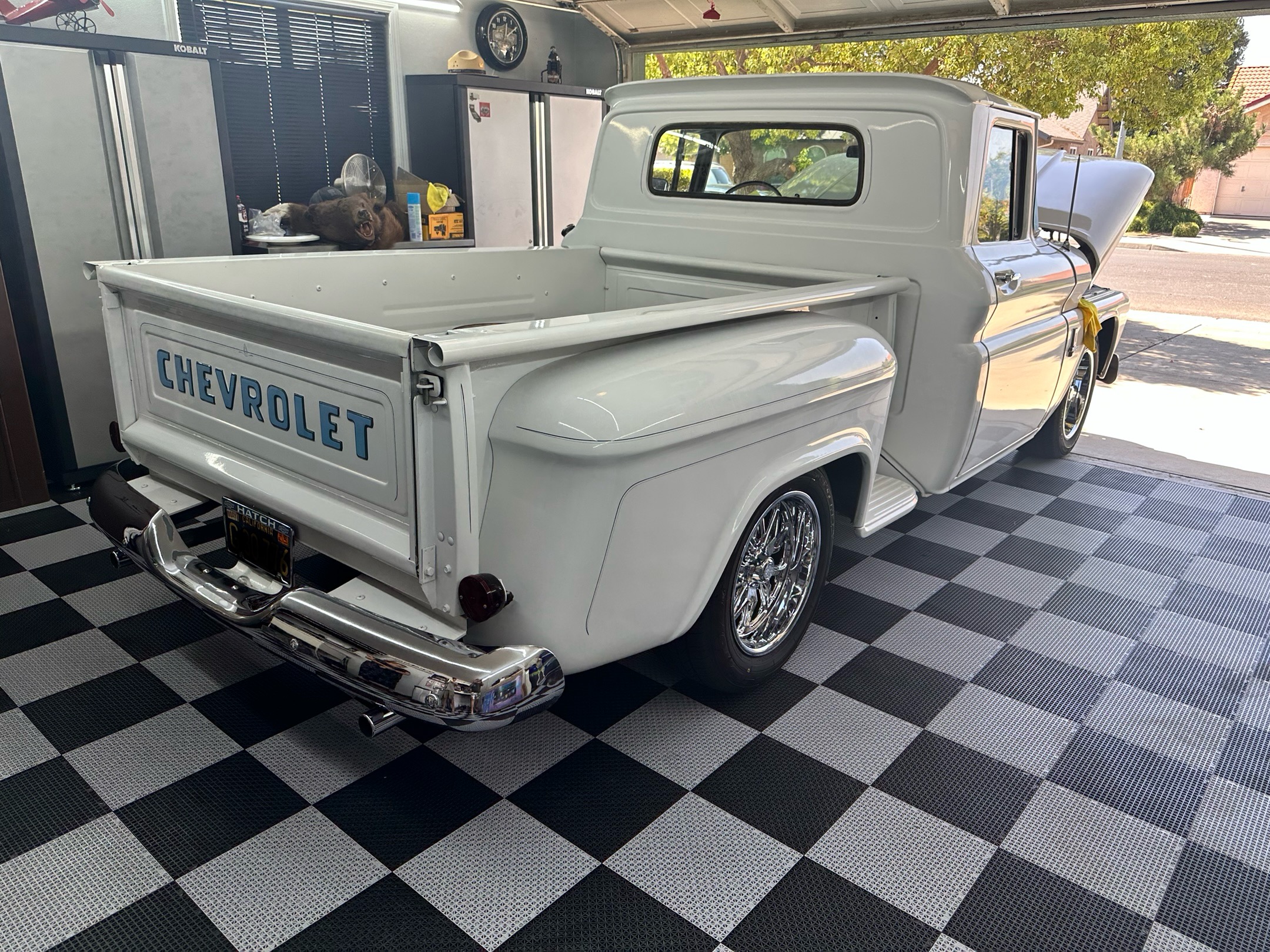

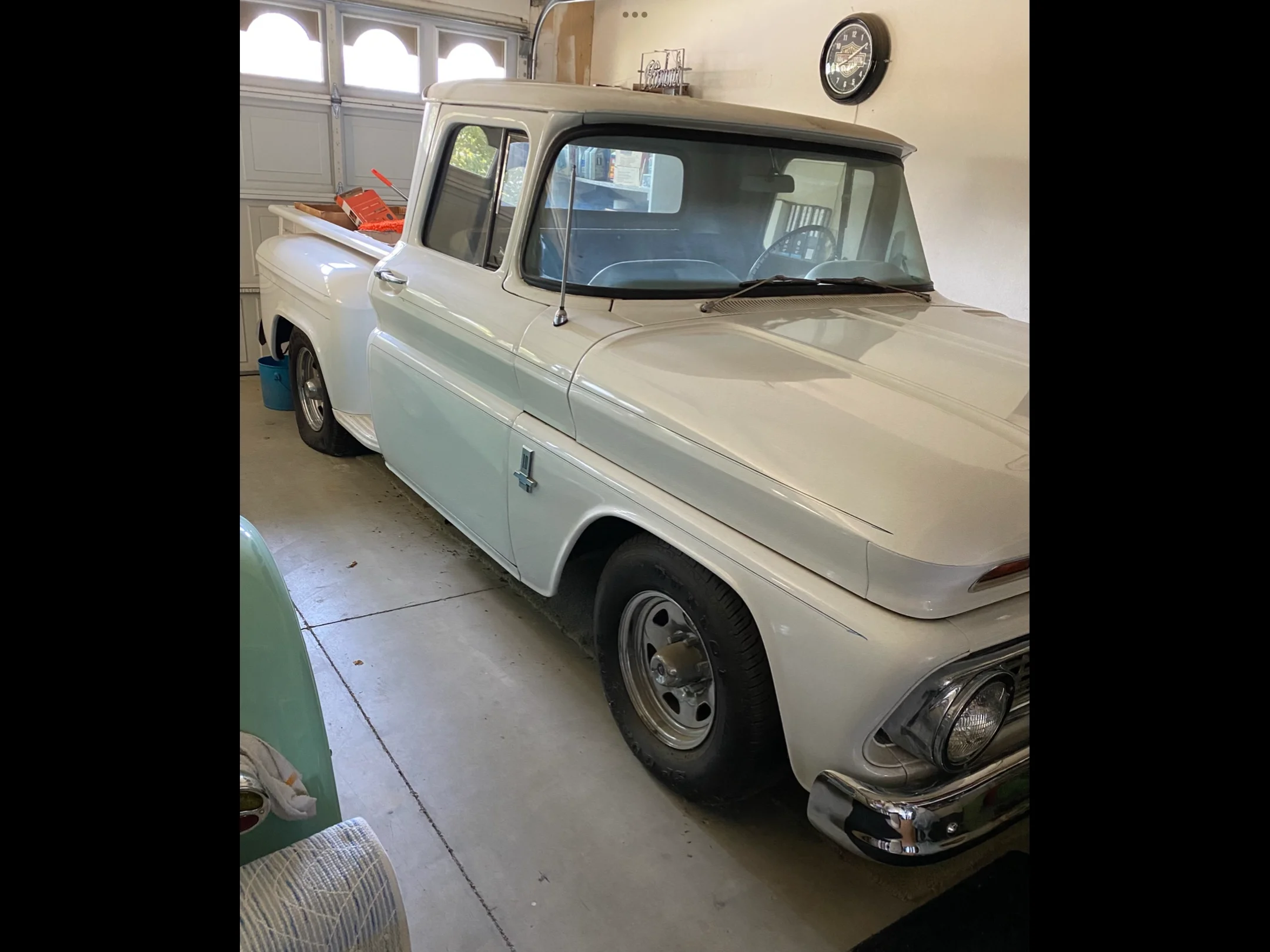

Ill try and update this as I go forward.. love seeing all the old trucks come back to life… here’s how she sits now.
Nice truck, great story. How about a few more pictures?

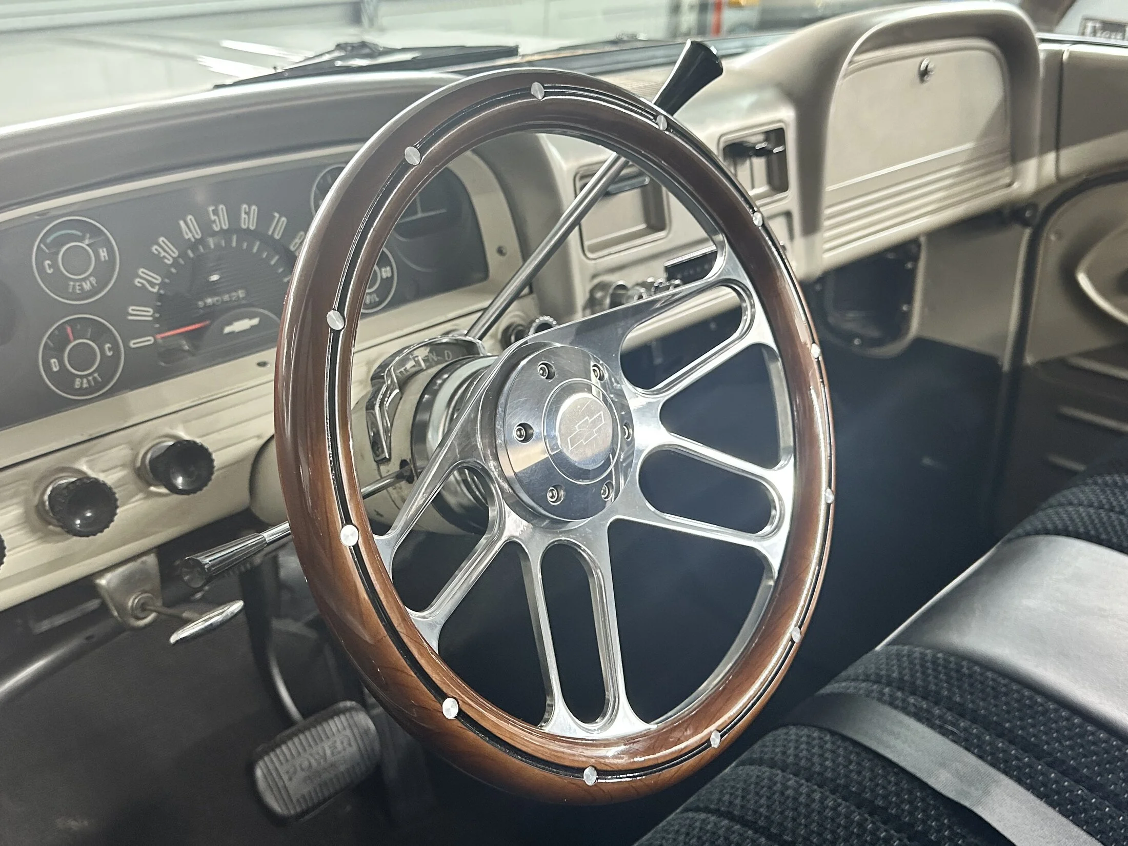

Thank you… here is a few more.

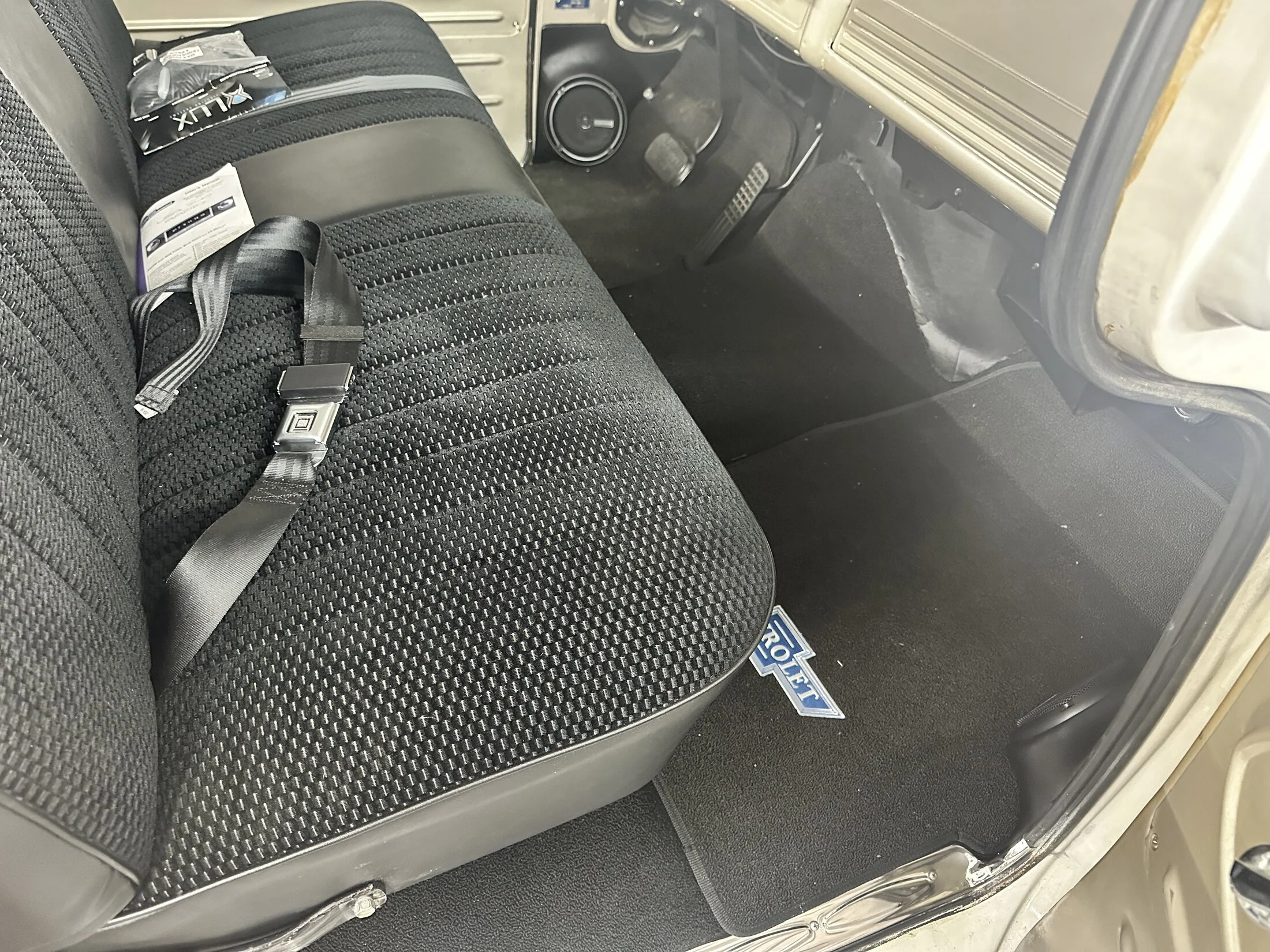

Seat reupholstered with new foam. New carpet as well.

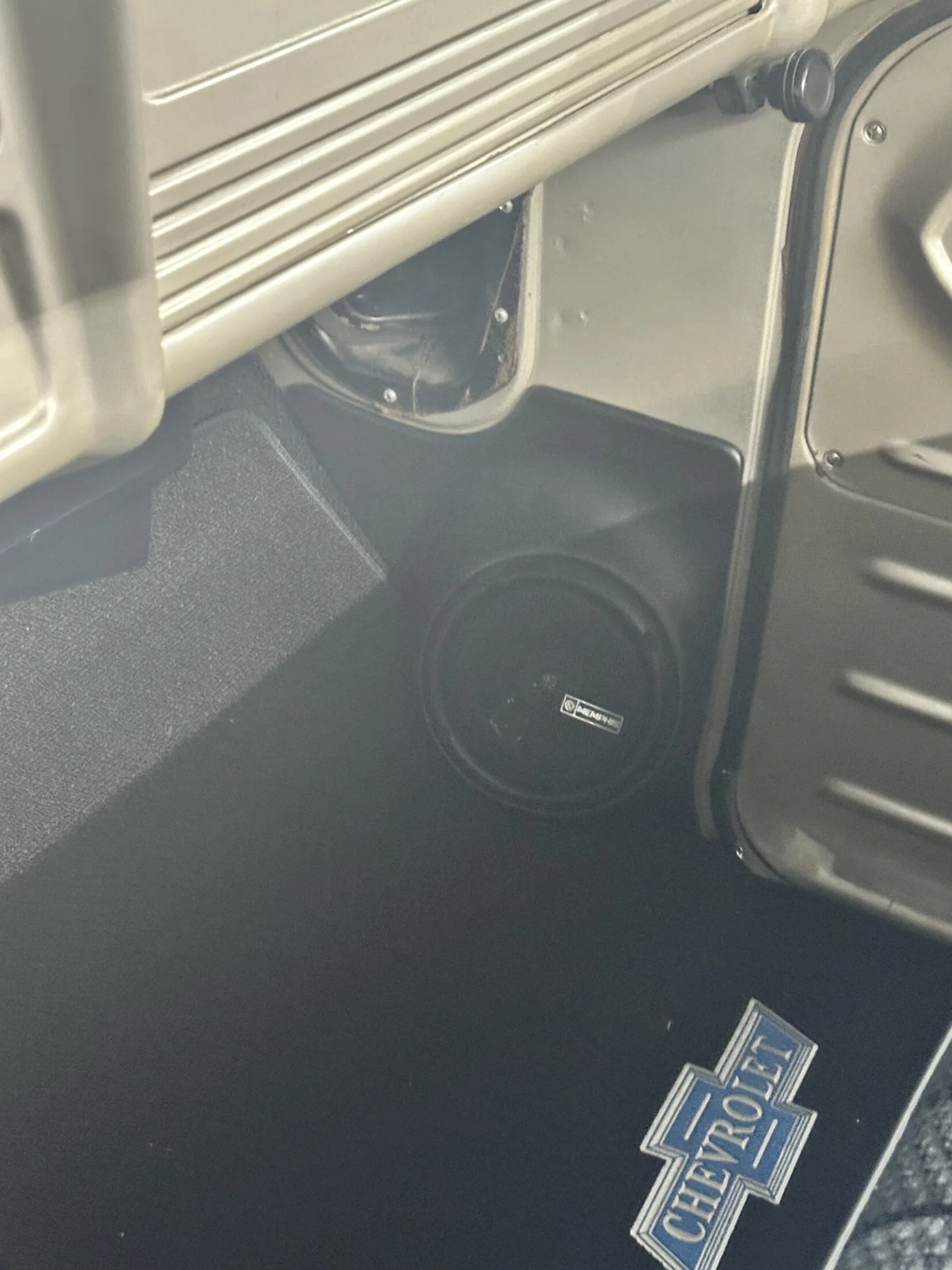

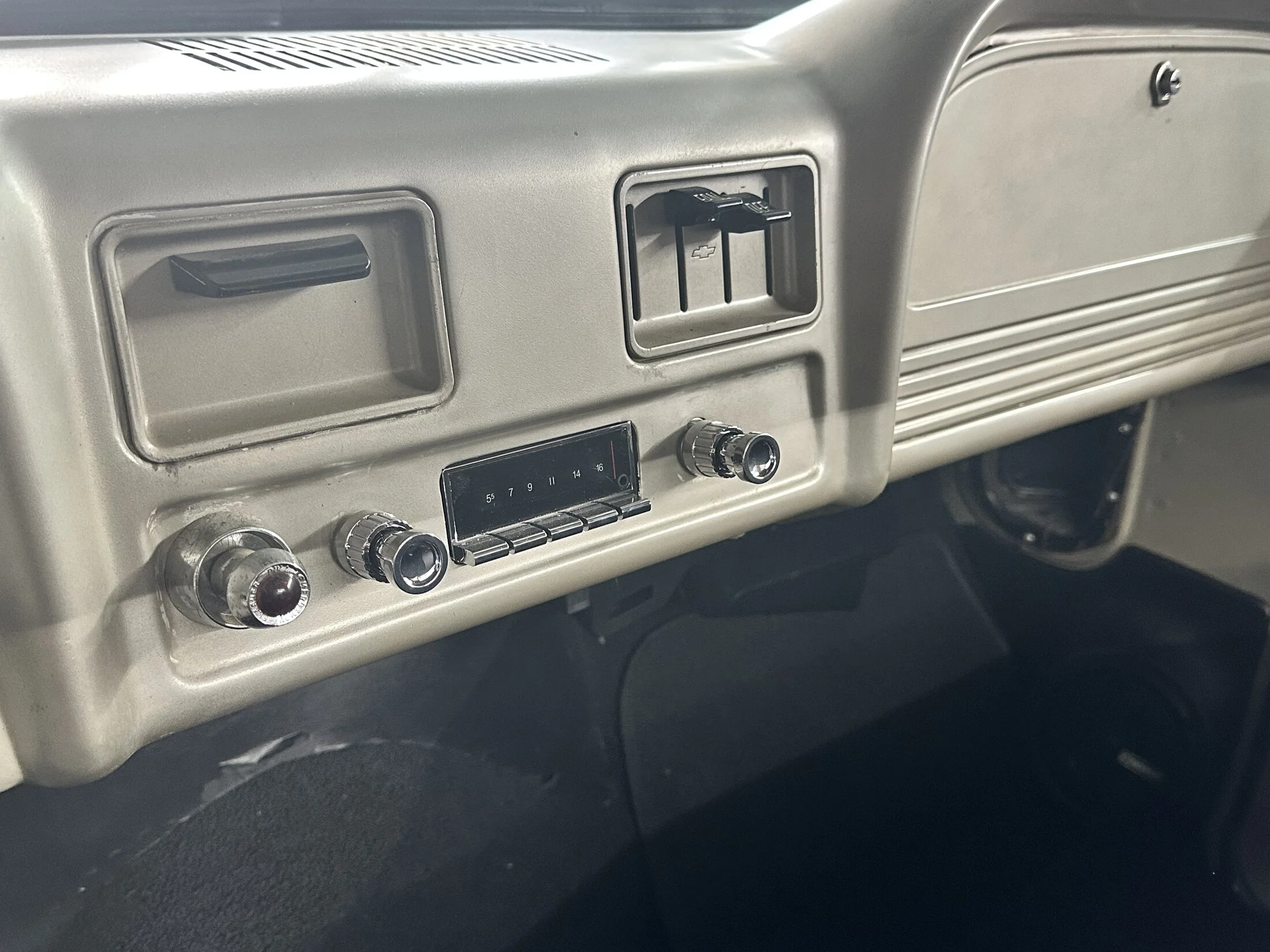

Added a new steering wheel, Classic car stereo and Memphis speakers. It also has two speakers under dash and a small Kenwood amp.

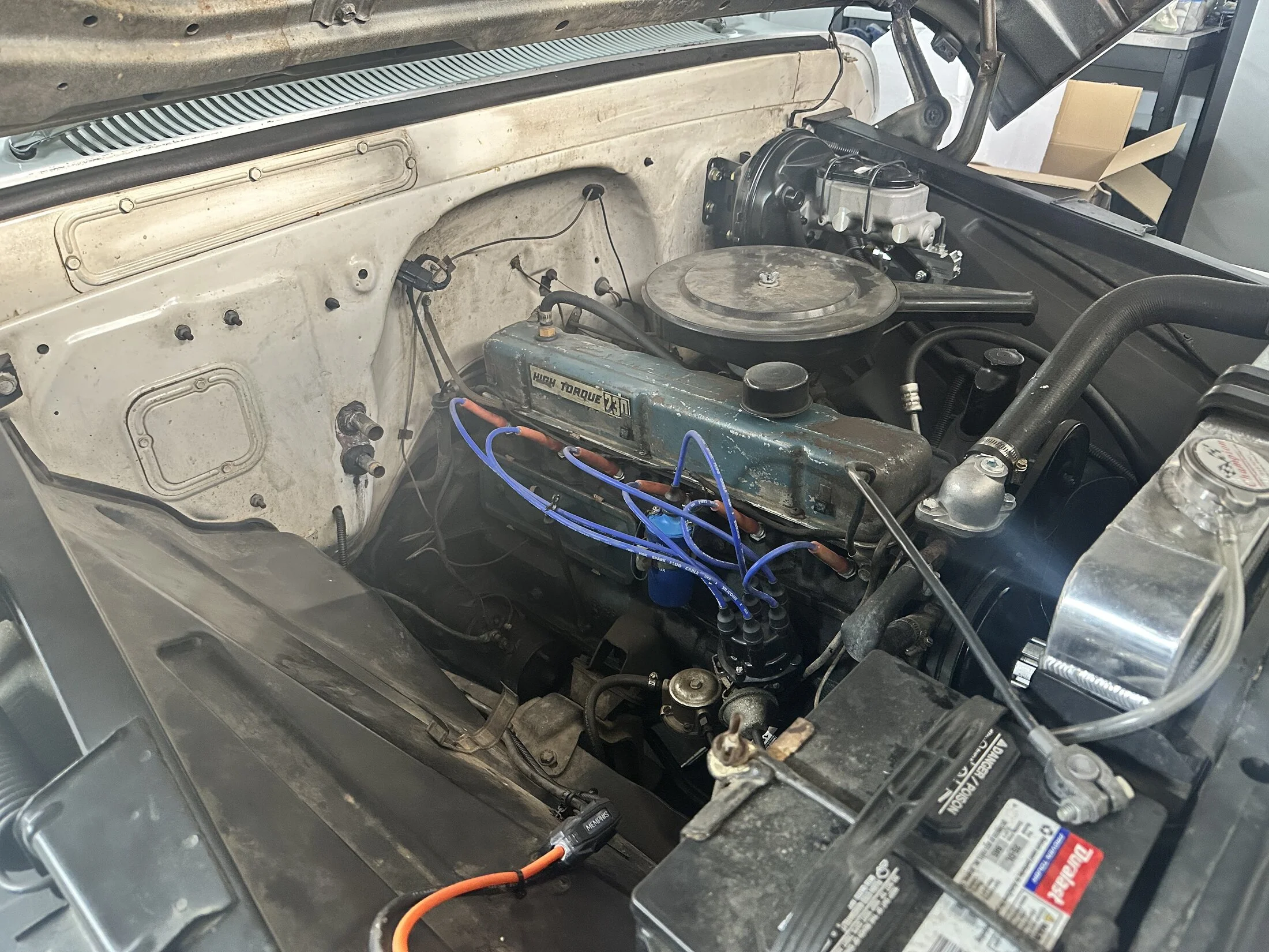

Then here is the trusty 230 that will soon be a 383 Stroker.
That 230 is a fine engine. Thanks for the pictures. It’s as clean on the inside as it is on the outside. 😎

Update: The motor is due Thursday.

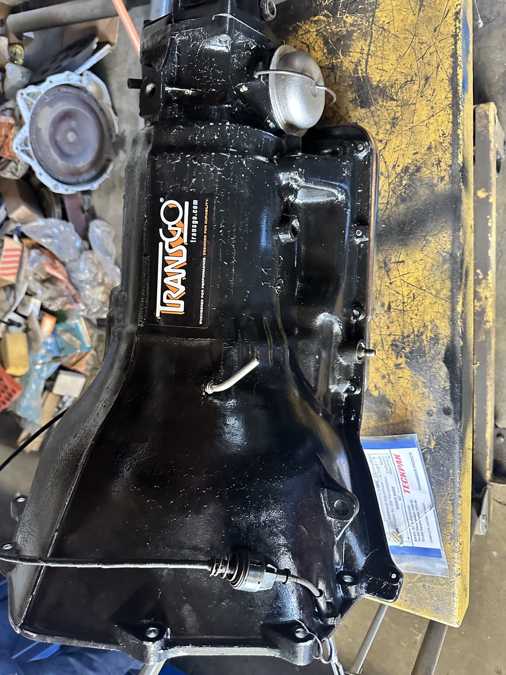

I’ve pulled the trigger on a custom built TH350 transmission from a local builder that does quality work.

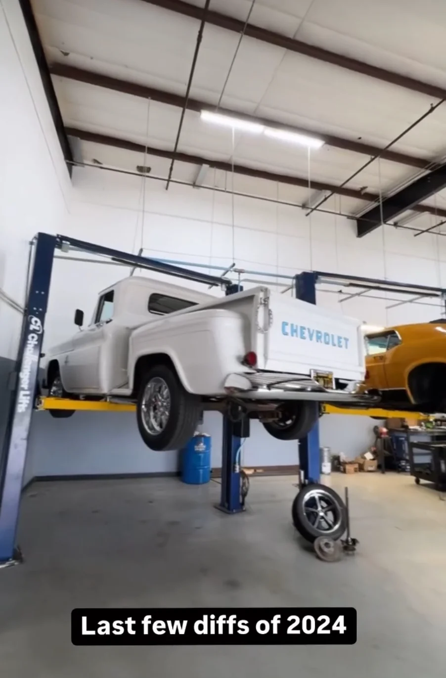

Today I met with a rear end shop as I don’t wanna break stuff..
Monday it goes in for a Eaton Tru-Trac limited slip rear end and new axles with 3:73 gears…
A lot going on… stay tuned. 🍺
This is going to be a great upgrade 🍿🥃
Still at the axle place, should get it tomorrow.
Verified it has 3;73 already in it.. from what I’ve read these early year ones came with 3 rear end gear options, 4;11, 373 and one other not compatible with the power glide transmission… mine has the 3;73 so just added the tru-trac limited slip and had all seals etc replaced..
Tomorrow I should be receiving my motor and transmission… next week the rehab starts.
Picked up the truck today with its Eaton tru-trac installed.. received a call that the transmission is done also FedEx called to say motor delivery tomorrow.
