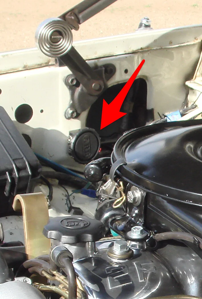

There already is a breather hose coming off your axles. It goes up a foot or 2 and mounts to the frame with a wonky valve on the end of it that sometimes gets plugged up. You can prob just remove the hose from the axle housing fitting and plug those hoses on. I've seen other versions of this. Mount the valves on the firewall up high and run the hoses to them.
