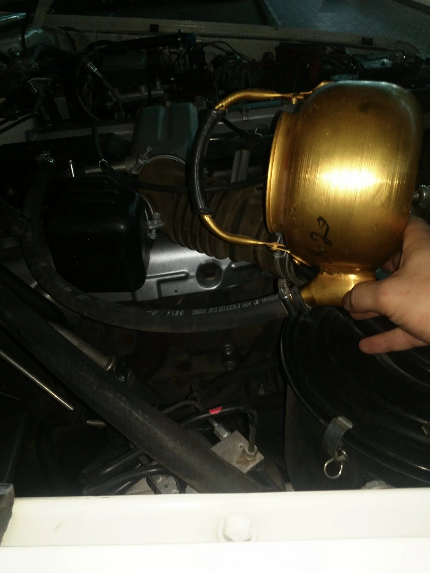

How 'bout this?
5$ teapot mod.
Catches the oil real well! I just punched a hole in the lid for the air to vent through. No more mess. Just empty the pot every now and then. Beats ordering a 200$ system from the other side of the world.
