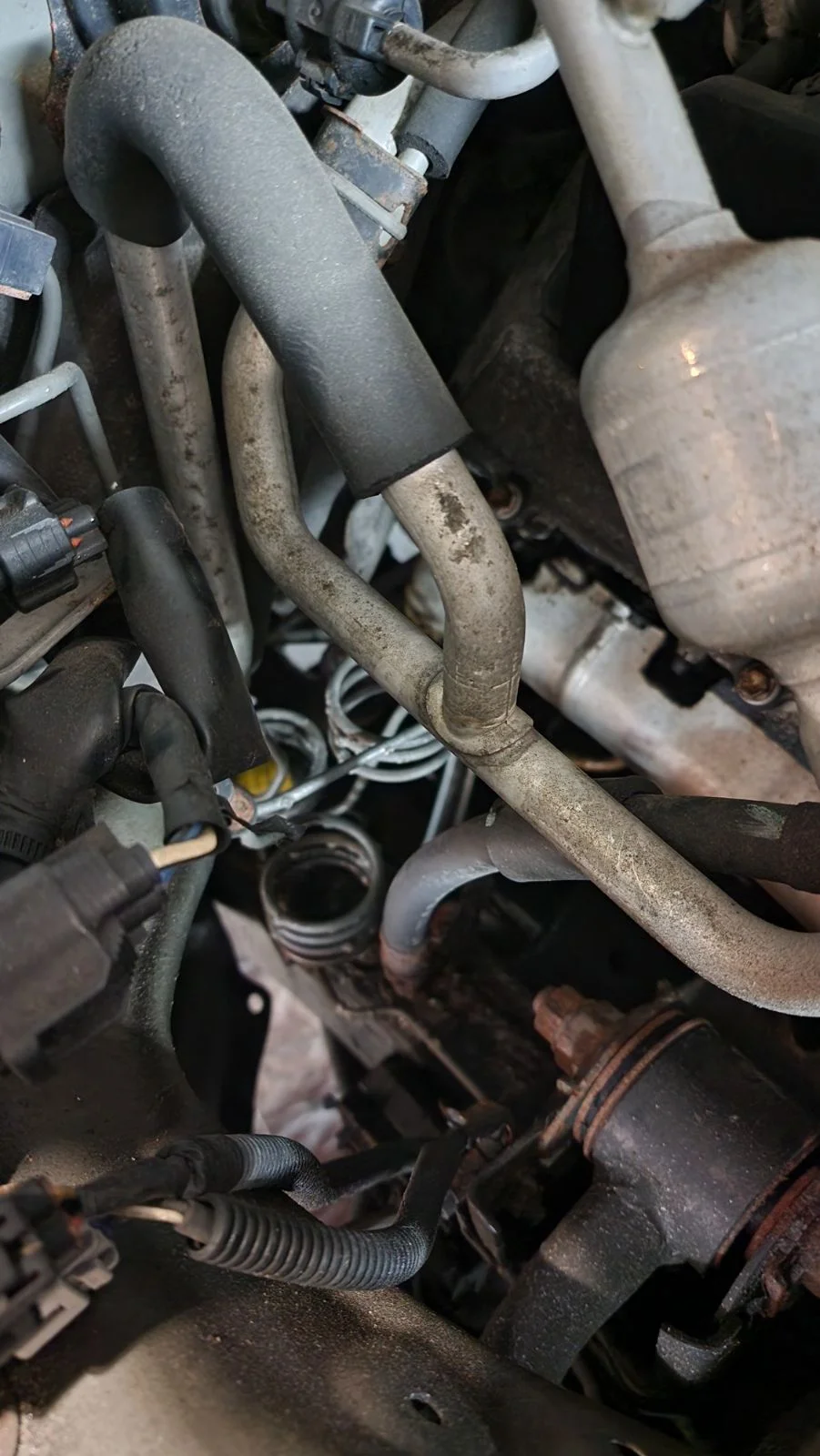

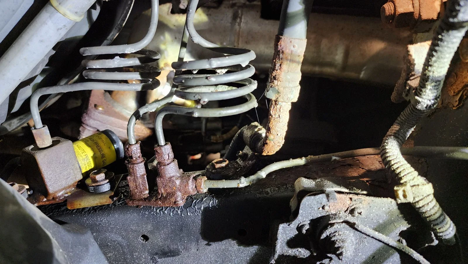

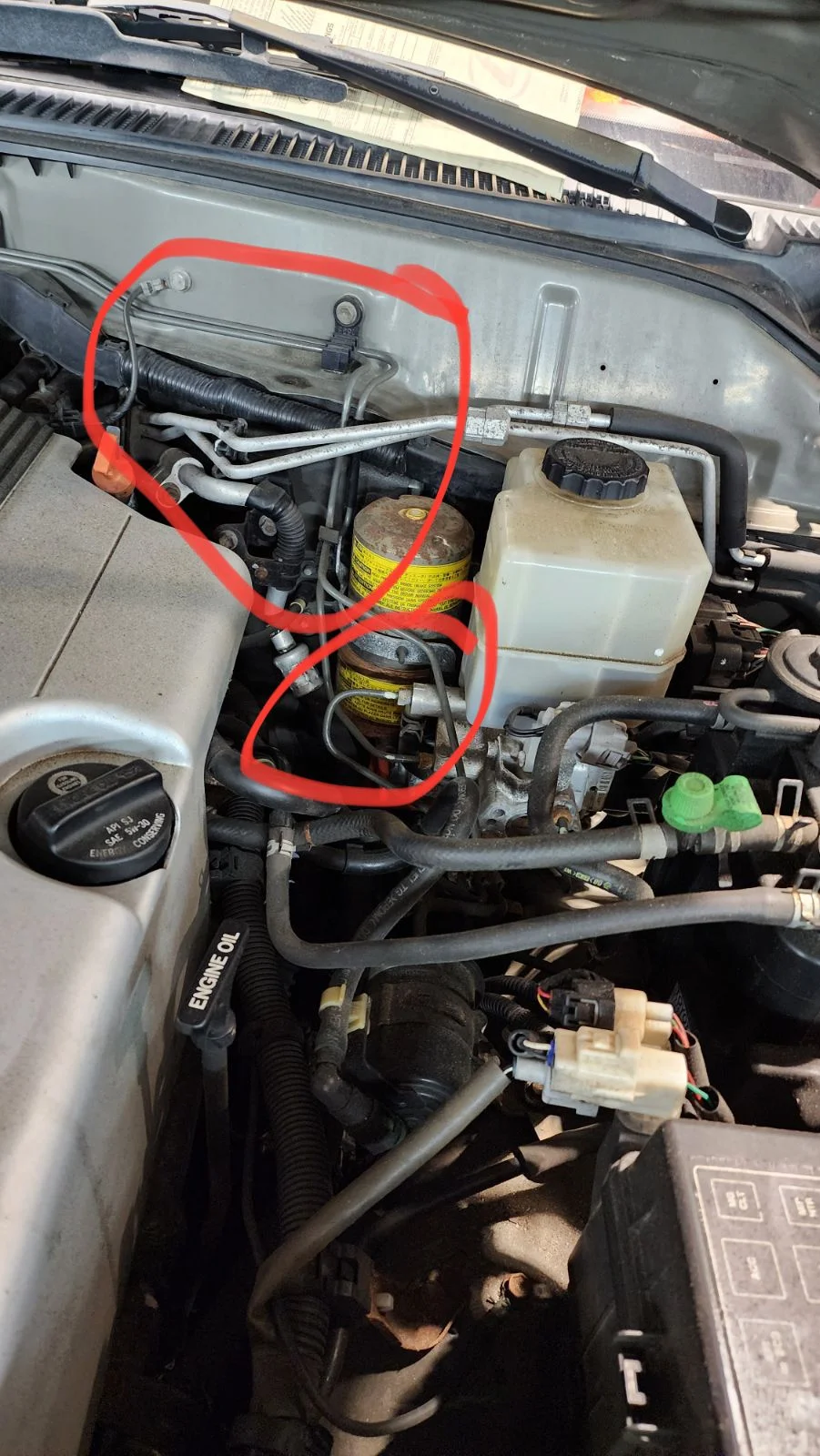

I have a 2000LX with 198k on the clock.
I have a brake line that broke, it is the passenger side. Does anyone know where I could go to find the parts list.
Has anyone had the lines changed? Could you share the cost?
Does anyone know how long it should take?
I replaced my rear brake line last spring with nicop brake line. A roll of that stuff, a flaring tool, and an afternoon will set you back about $100. If you are lucky and DIY you may be able to reuse the old brake line fittings with your new brake line. If you take it some where you'll be paying for a tow on top of the repair. Most repair places seem to not want to do rusted out brake lines, so expect the bill to be close to a grand.
Partsouq.com, but you’re probably better off finding a pick and pull or building the line yourself. I think shipping will be a killer on that thing.
