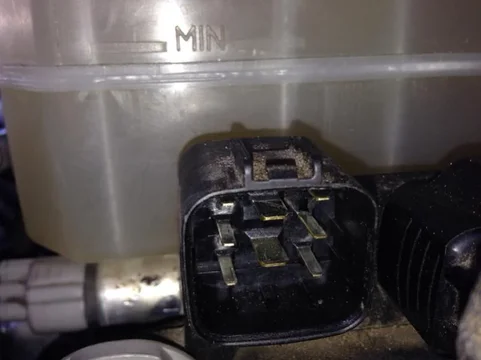

I had the same issue and replaced the booster pump with some improvement but had various occasions where the 4 lamps and buzzer turned on. So I thought it might be a flaky electrical connection. I found my battery ground was loose ( my fault) but that did not help. I then read this post about the electrical connectors being corroded but they all looked ok...no visible green corrosion. I then took a close look at the pins on the abs module. I unplugged and replugged the connectors when the 4 lamps and buzzer were on and they turned off. So under close inspection, a couple of the pins where black and dirty. Uses some cleaner and qtips to clean and so far so good.
See the middle upper pin. It looks ok under quick inspection.
