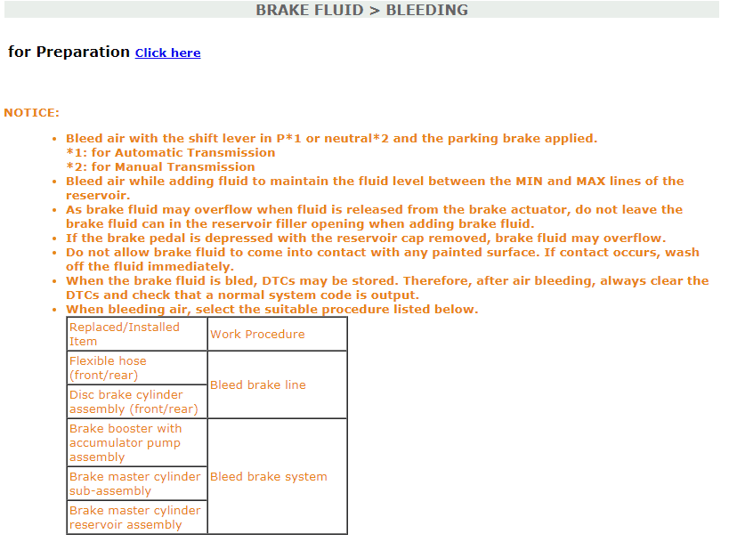

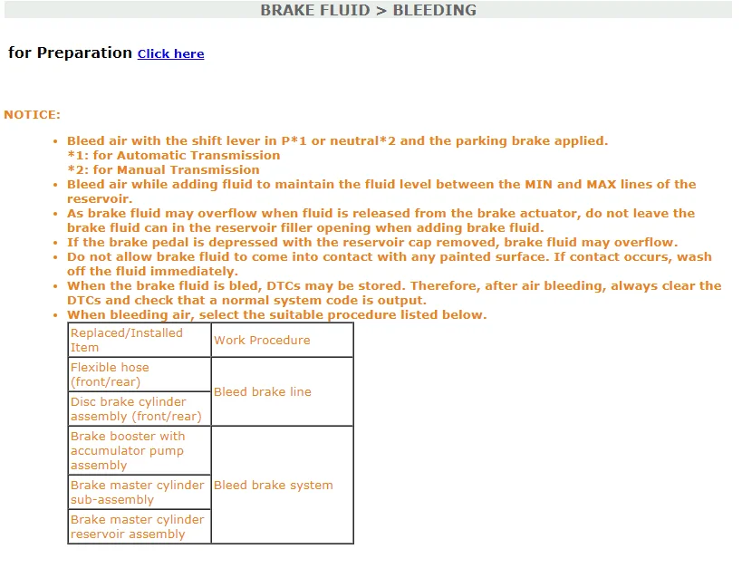

Brake Bleeding Instructions. I omitted part 2 on bleeding the brake system (master cylinder and ABS modules) since you don't need to do that for a normal flush unless you let the fluid level in the MC get too low and introduce air into the system.

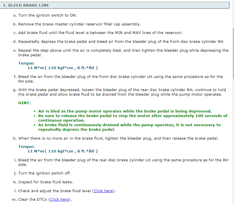

I followed the FSM procedure above and it worked like a charm....
I had the dealership do it on my last service and I believe it was only about $99. For that price it's a no brainer to have someone else do it and do it right. The quality, inexpensive dealer service is one of the reasons I like driving a Toyota, but they know what they're doing at this shop and the lead tech is the only one who works on my truck apparently (not all Toyota dealers are going to see enough Land Cruisers to be as knowledgeable IMO).
FWIW it took me about 20-30 minutes and 2 quarts of brake fluid to bleed them. Brake fluid and the bleeder was maybe $20-25. Really simple so long as you don't mind laying on your back under the vehicle. No need to jack it up, and no other tools required except for a wrench to open the bleeder screw. Just remove the rubber cap and loosen the bleeder screw, attach the brake bleeder hose, then go into the truck and with the vehicle in the ON position pump the brakes several times. Stop, open the brake reservoir, top off the fluid, and repeat until the brake bleeder bottle gets full. Tighten the bleeder screw, then remove the bleeder hose, then repeat for the next wheel. The order to bleed them is LF, RF, RR, LR. When you're done you can clear the hidden codes if you have a laptop with techstream, or you can just leave it since IIRC there's no check engine code.

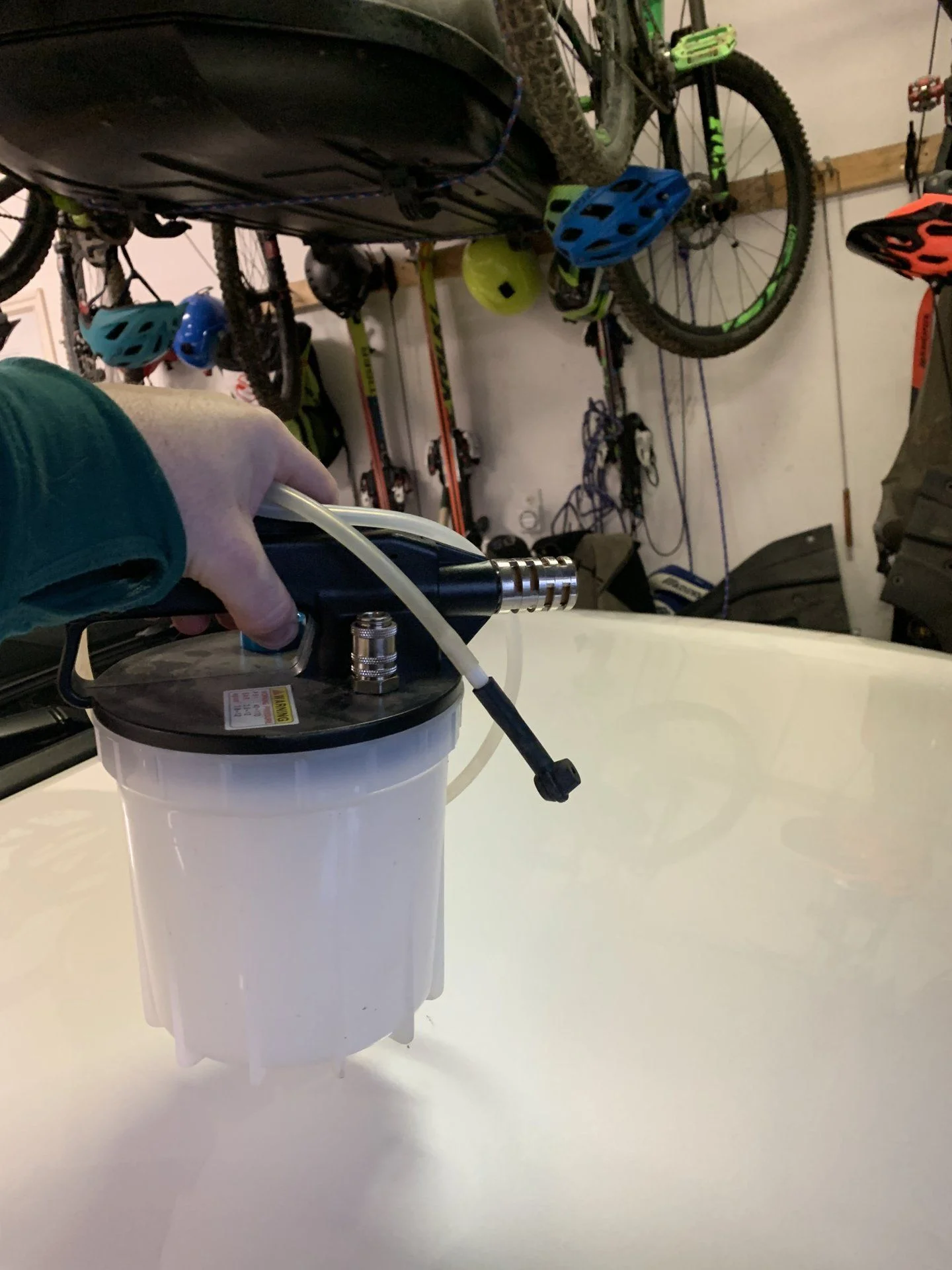

I’ve done my own twice on my ‘13 LX 570. I use the procedure Linux posted but did it one man with a vacuum bleeder instead of pumping the breaks. My local dealer wants $300 and it takes me 30 min. I used valvoline synthetic DOT 3 last time as it was easily available.

Nope I just used a cheap brake bleeder off Amazon. Technically it's a one-man bleeder but I had my son pump the brakes so I could watch the fluid more easily. It was a ~30 minute job.

ladies and gents, we only need the speed bleeders on the front? for the rear we just need to have someone press the brake pedal and another person to crack open the rear bleeder screw and fluid will continuously flow... is this correct?
Assuming you follow the FSM procedure posted by linuxgod above (ignition on, etc.), then yes.
Somebody may correct me, but my reading of the FSM suggests that this will not flush out the fluid in the ABS system. Think that's been true since at least my 2000 LX. The FSM for 2016-2020 has two sets of bleeding instructions: 1) bleeding lines, and 2) bleeding system. Per the FSM, the second method requires the use of Techstream to actuate the ABS pump. However, various members in the 100 section suggested driving on wet grass or loose gravel and jamming on their brakes to make fluid move through the ABS unit to help with a full flush when Techstream wasn't available. A search would be advised before trying this method - I used Techstream when I did a brake overhaul on my LX.
I think that's generally correct. The FSM says however you shouldn't need to do #2 unless you've done ABS maintenance or replaced the master cylinder and need to bleed the air from it. For a regular flush they only advise doing #1. I assume the amount of fluid involved in #2 is negligible and there's no need to do it unless you think you have air in the system
