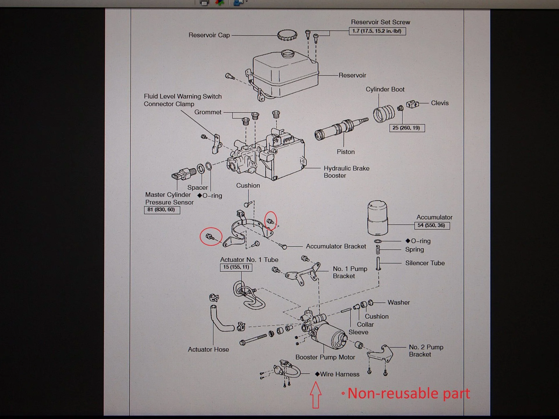

R&R was not bad. Would have been easier with another pair of hands but I used a 1x4 from fender to engine and a strap to hold the unit in place while removing the 4 nuts (12mm) in the drivers footwell. FSM says to remove all of the under dash pads - not necessary. I was able to remove two nuts on ABS ECU (10mm) to move aside and then remove the 4 nuts and clevis pin. I had to remove two bolts (12mm) to move the “control box” in front of the assembly a little forward to wrestle the assembly out. Install was the same, wiggle in place and h0ld w the 1 x 4 + strap to keep it aligned while securing the 4 nuts. The clevis pin and clip took a little time as you cannot see the hole in the pin.

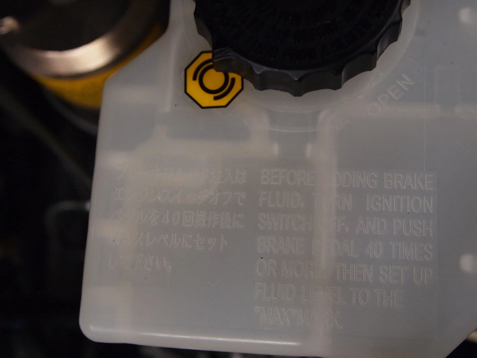

I just changed my booster pump with a new one but I noticed the fluid level is way above the level line each time before I start the engine and normalizes after the engine is running and the booster starts pumping. The booster pumps from time to time even on the road??? never heard it before the old booster failed. We have bled all 4 corners, pumped the pedal 40 times, no fluid leaks. The brakes are not spongy,no buzzing sound, brake dash light and seems fine. It's just that sound of the booster when I'm driving it and the fluid level issue. Am I missing something here? Thank you again...
Read the print on the reservoir, it tell you how to set level.
A few things can make a good pump sound loud. Missing or bad isolator bushing or accumulator touching sides.
