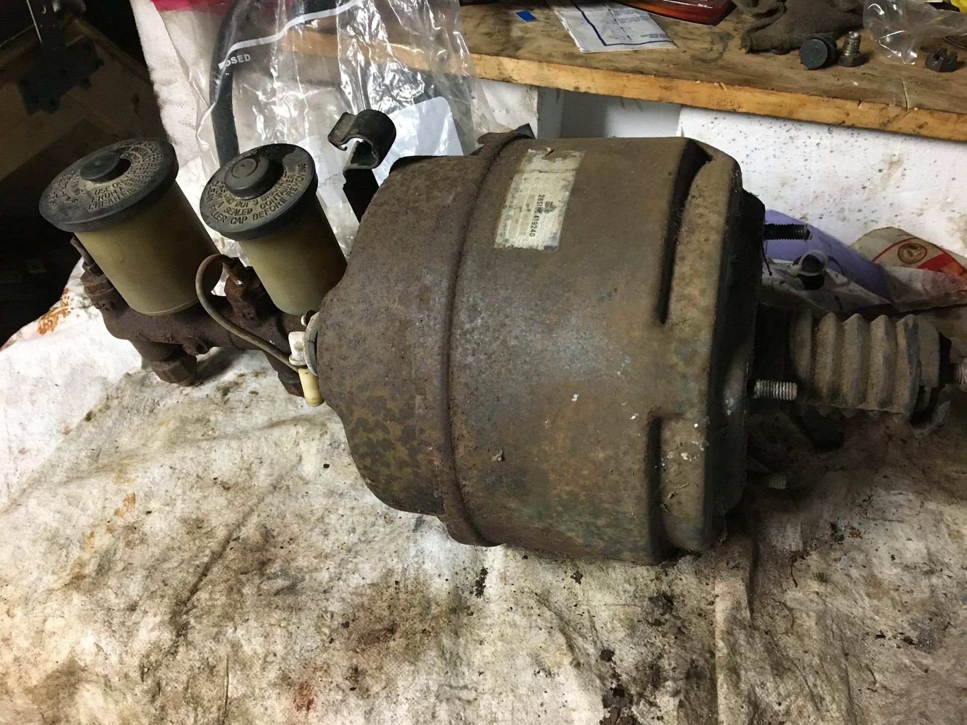

I have remove brake booster (FJ40 1976 with frond disk). The booster is seized.

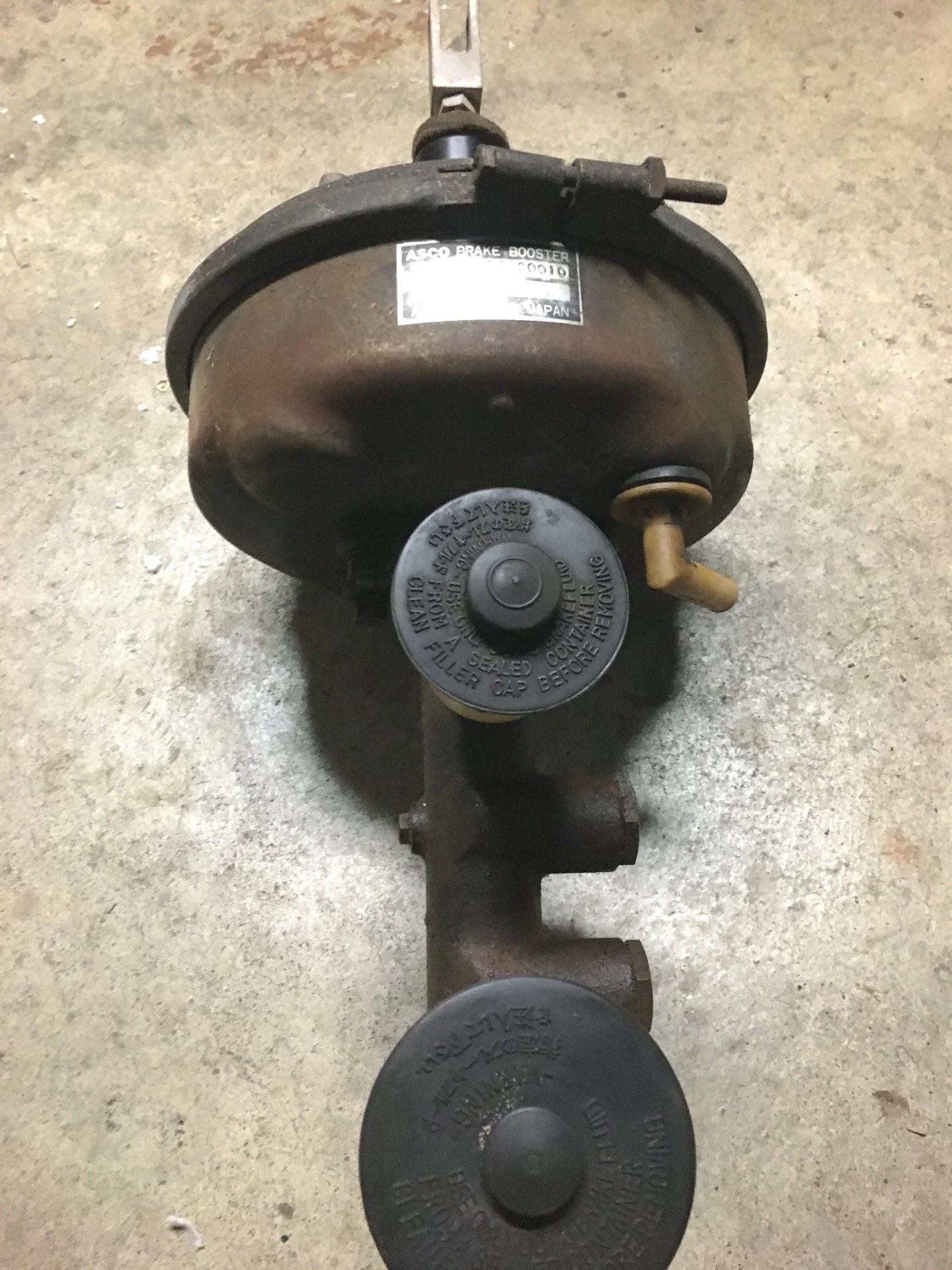

I have spare Asco booster from early model (with one membrane) in working condition.
Can I use early brake booster from pre 75 on my 76? I have read here it could be adjusted.
Also it is worth to try repair sized booster? It is even possible or I will just wast my time ?
Spare booster from 1970-75? :
Seized booster from 1976:

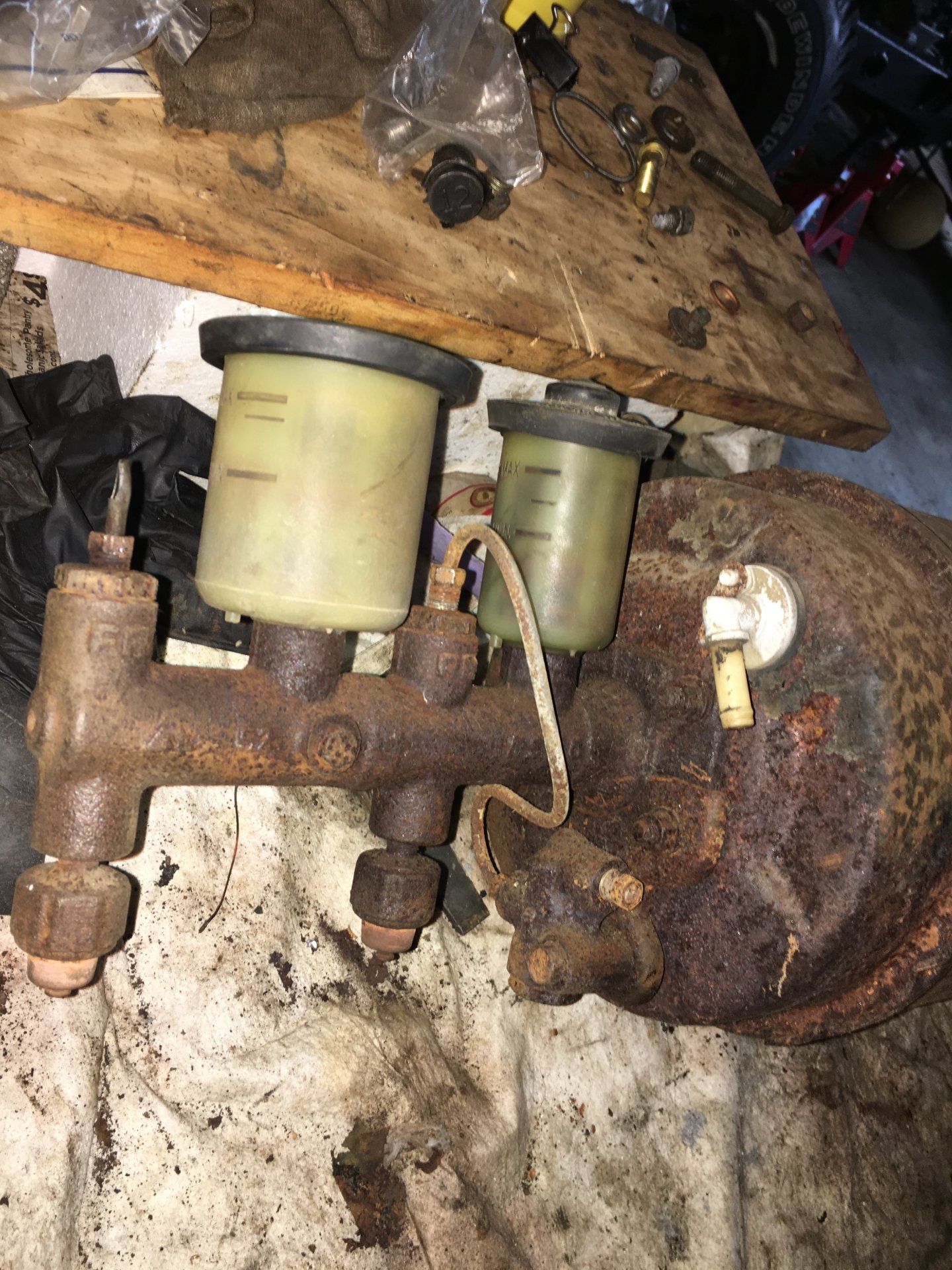

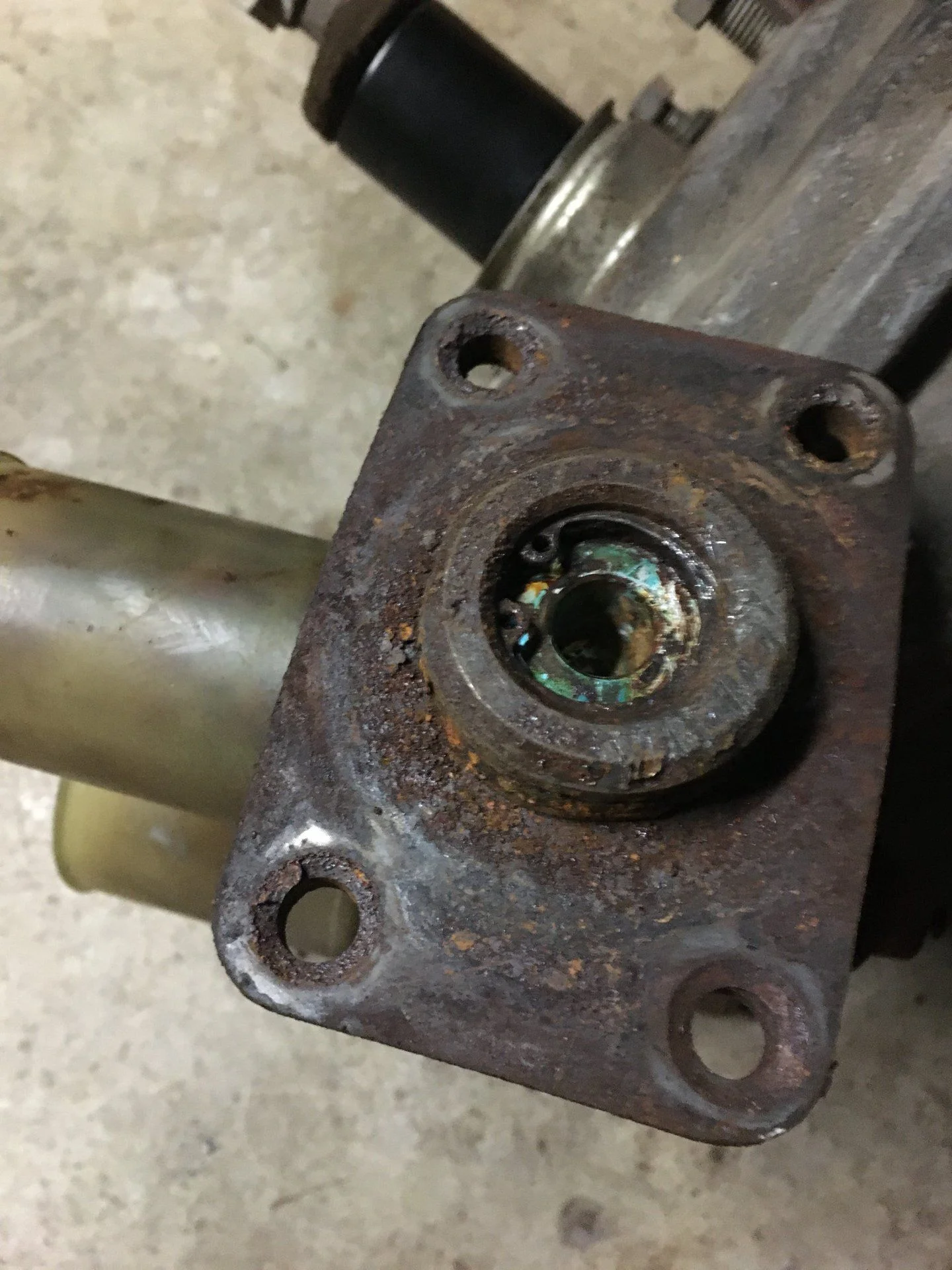

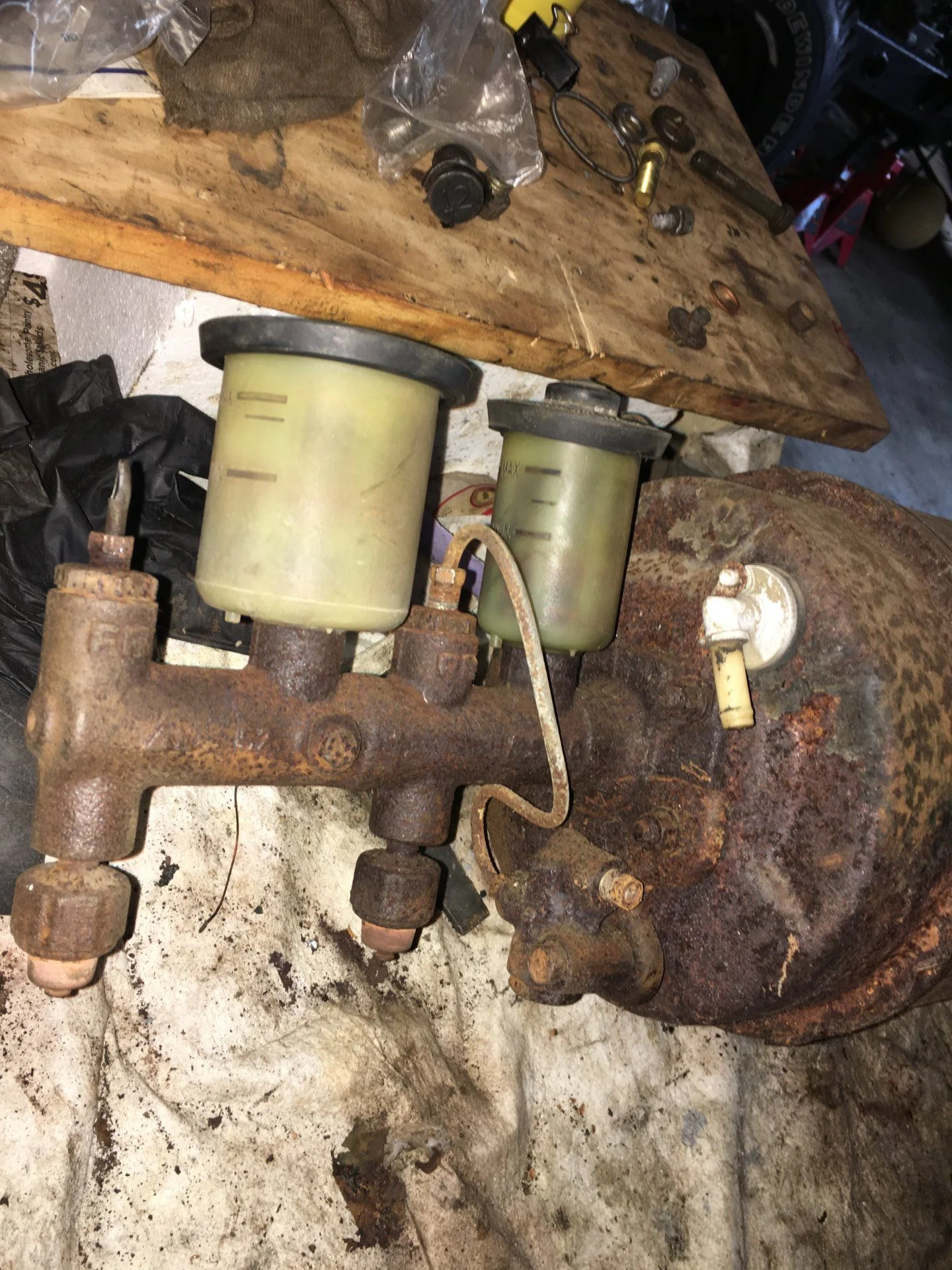

I have remove the master cylinder .. still can't push ...
Master cylinder also seized....
