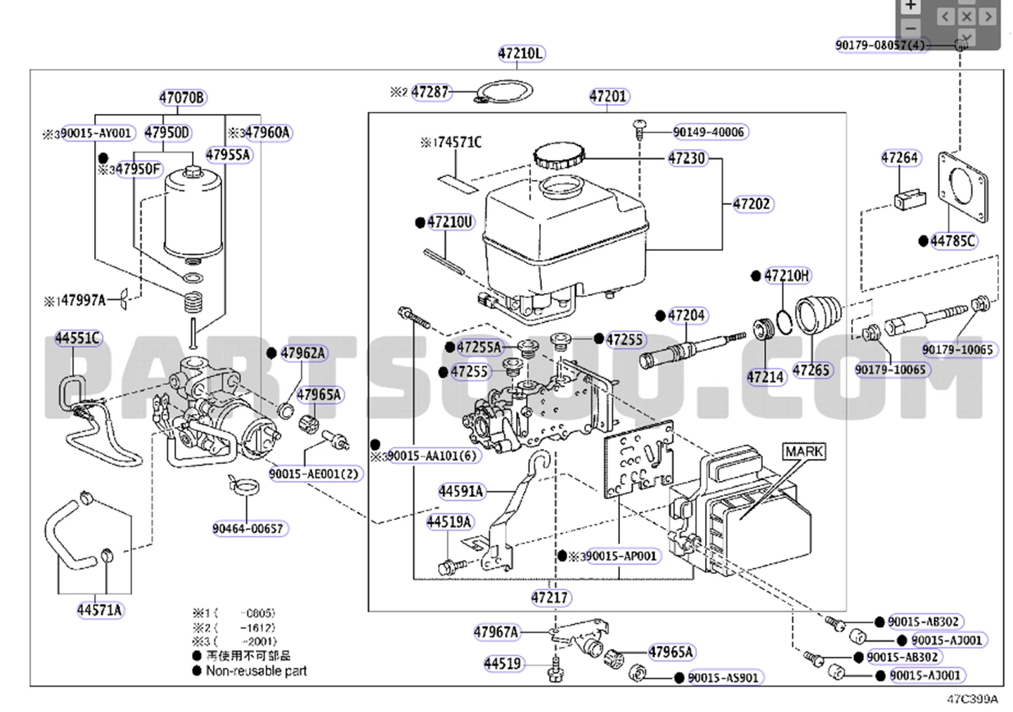

Quick question ! Does anybody have experience relating to swapping out the brake booster on LC200 please. Specifically concerning either the replacement of the accumulator only from the assembly (cheaper but is it simple/practical/even possible ?) or is it best to replace the entire unit ? Thank you

I've swapped the whole unit and it wasn't bad. Swapping the accumulator only is probably a tad more difficult and there is the critical high pressure seal.
Curious what your symptoms that you're trying to solve.
The unit is a safety critical component, meaning it has failure modes covered by Diagnostic Trouble Codes (DTCs) and alarms. The accumulator pressure is definitely monitored and you won't likely get softer braking without first having an alarm. Just trying to help diagnose before throwing money at this expensive part. Which I unfortunately did as the Toyota troubleshooting guide for electronic transfer case errors led me to change the part wrongly.

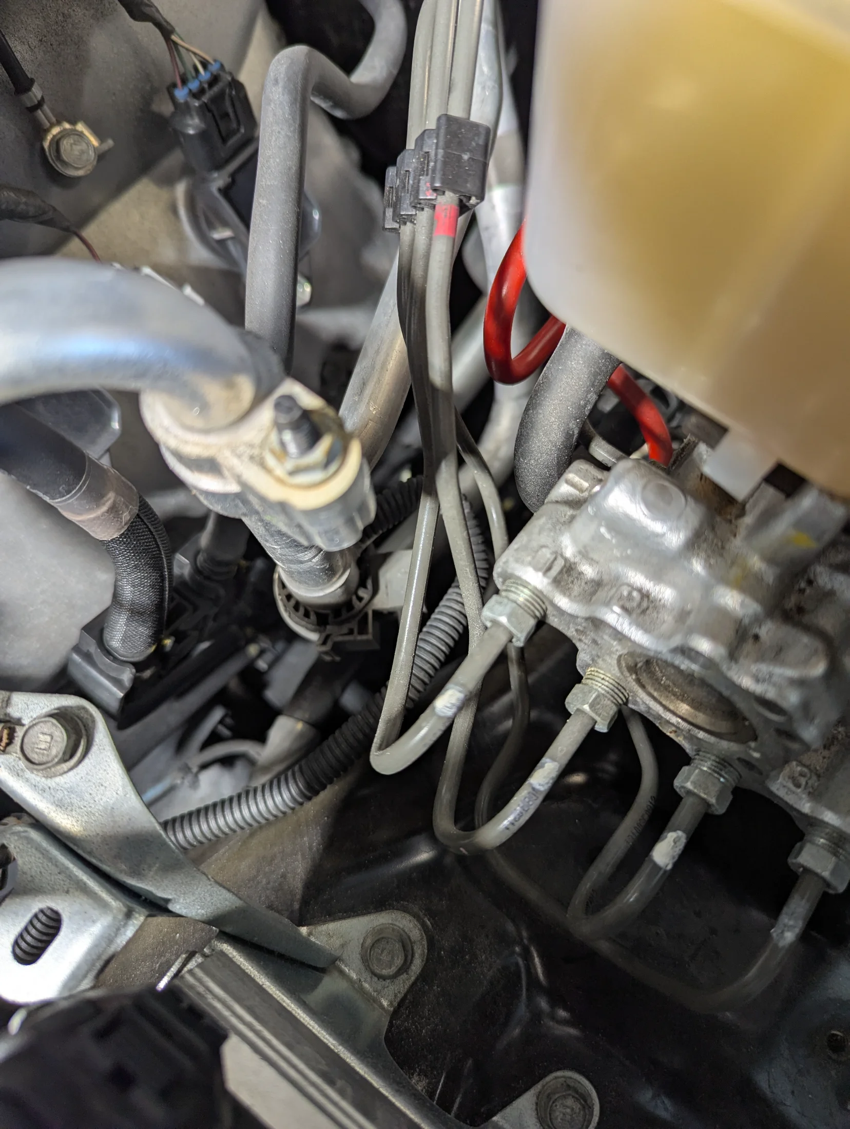

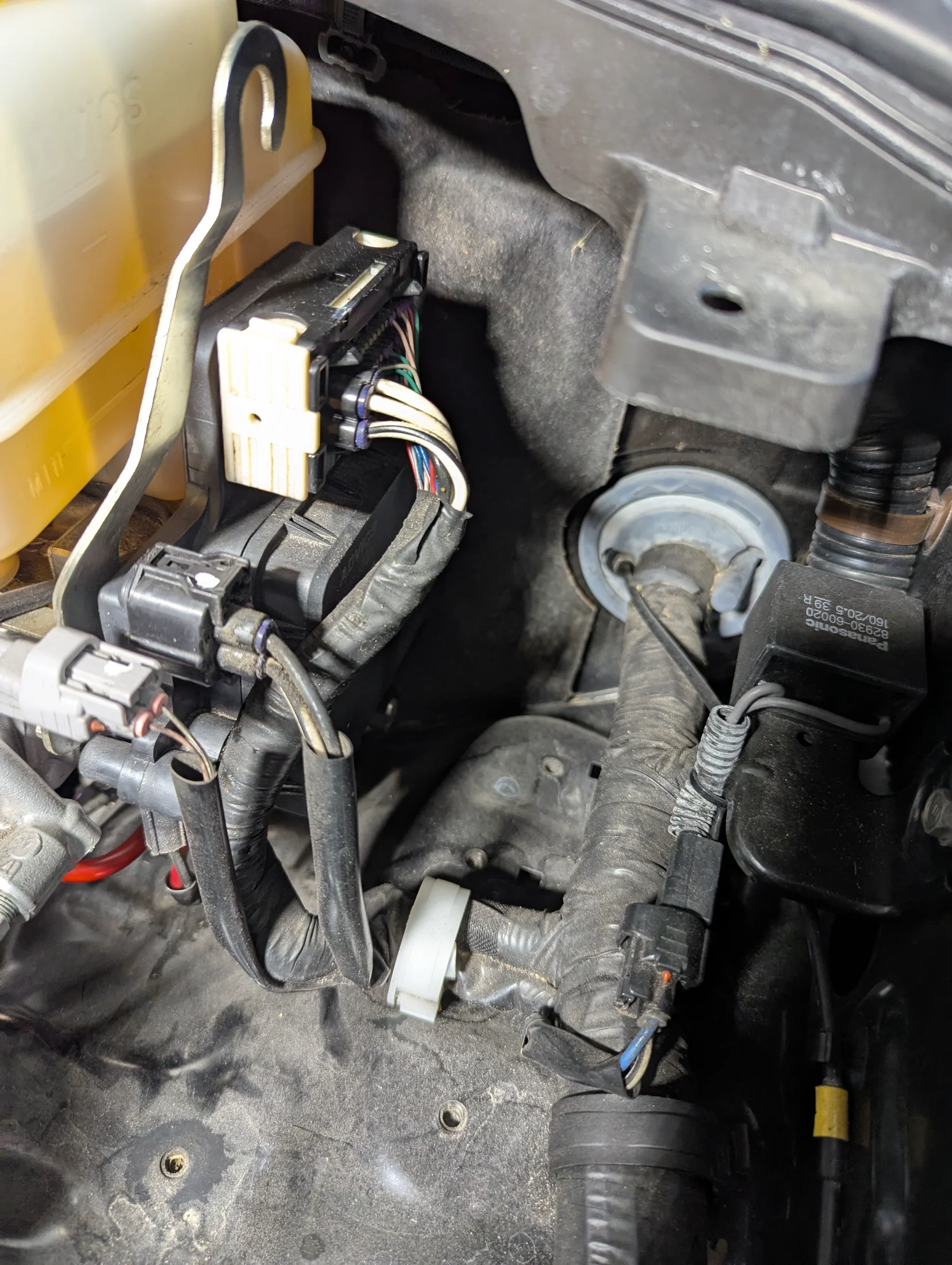

Hey not to revive the bad juju but i think i may be having problems with the MC/Brake booster. Initially had soft pedal with slight sticking of pedal at top when starting in the morning. Softness was remedied by new front pads/rotors and brake bleed. Ever since brake bleed pedal has been getting progressively harder and also stuck a few times at top while driving long straight stretches on interstate. Luckily it only happened right after the brake bleed and hasnt happened since.
Here are some photos and a video as recommended by LC200
I would be hard say what it is diagnosing from afar. If you're not getting any alarms or CELs, it would be hard isolate to the master cylinder. It could be something like the caliper pistons sticking.
Ok thanks. I don't see any leaks and definitely no warning lights yet. I'm having trouble uploading the short video of the ON position motor noise and bubbles in my MC reservoir when the brakes are applied.
