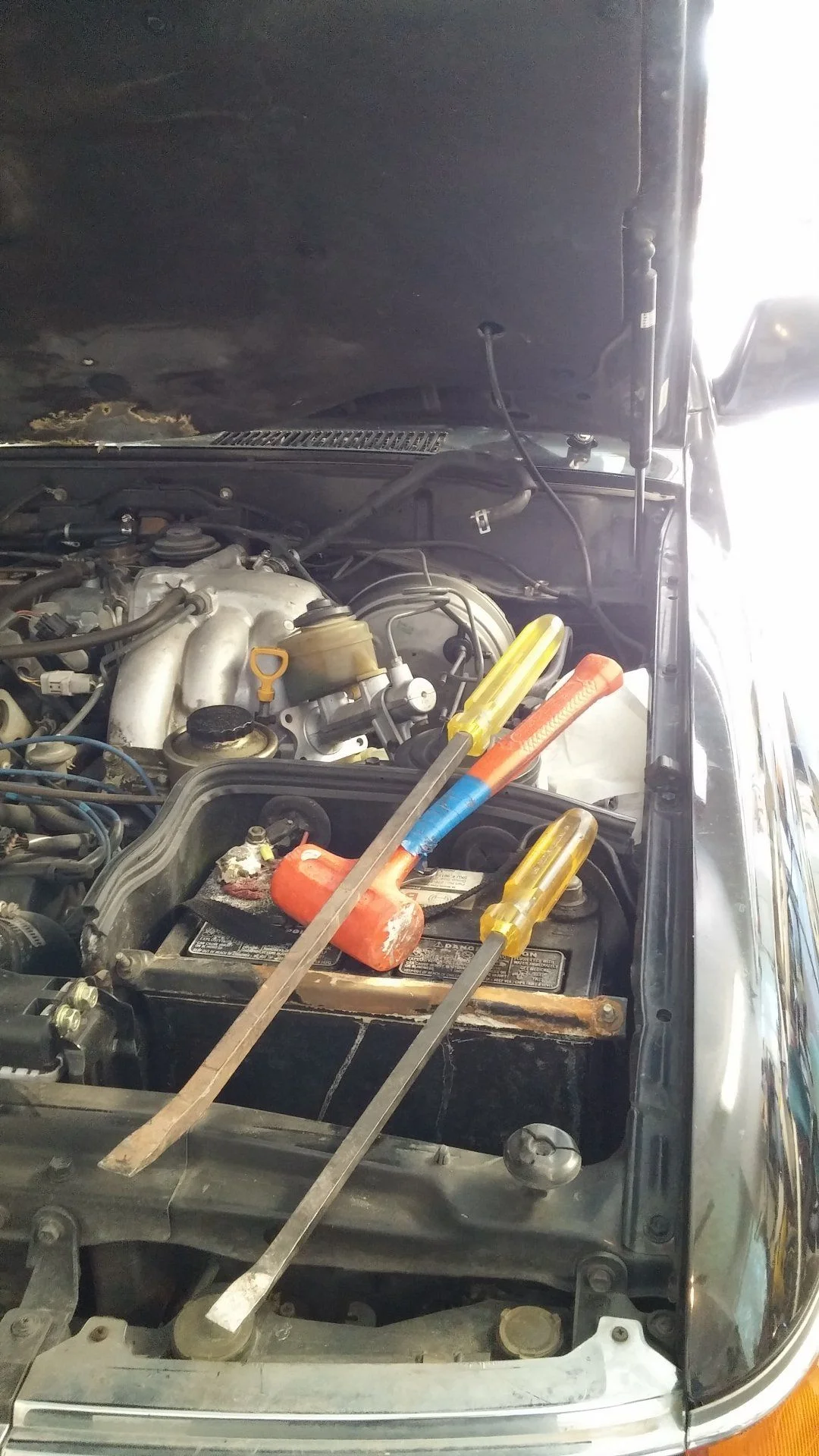

So I read all the threads on how to remove a brake booster. I have a 1997 fj80 and just replaced my booster. Mine would not come out no matter how hard I tugged and pried. I could not get the booster to clear the manifold. But I came up with a solution. I disconnected the brake master (all hydraulics left attached and moved it forward- like others have suggested). Then I pulled the booster as far forward as possible where it became stuck/pinned in position. Next I took my sawzall with about a 12 inch blade and cut the back of the booster clean in half (cutting through the four rear mounting bolts and center shaft). Then I easily removed the two pieces. Placing the new booster was a snap. I placed the two bolts closest to the fender in the holes just a bit and pushed the booster in while rotating it towards the other two holes. I am unsure if others have tried this, but it worked quite well. I was surprised, but getting the new one in was much easier than I anticipated.
