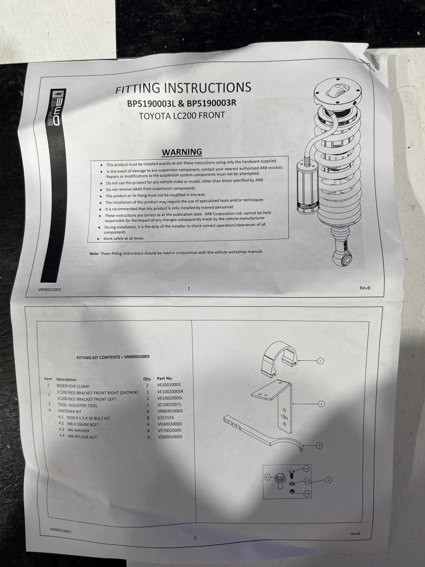

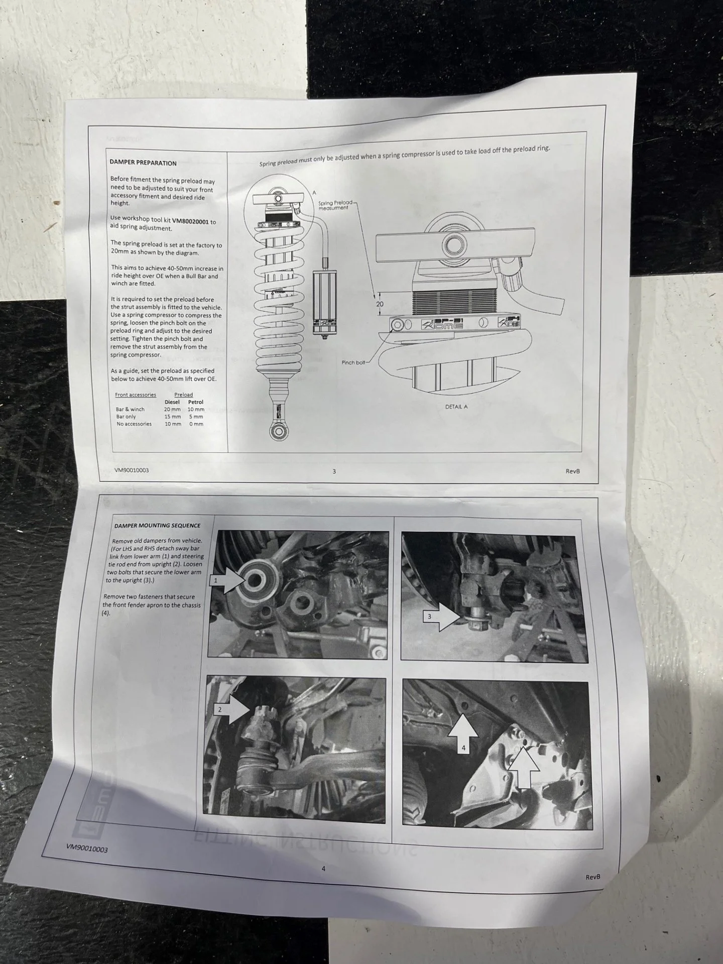

ARB instructions call for 10mm for gas engine with bumper and winch. I don’t know the weight difference be Toyota’s gas and Diesel engines. But, has to be at least a couple of hundred pounds if it is anything like other manufacturers.

Just for reference, here are the instructions that came with my set. I have seen on the ARB site, the reference to setting it at 20mm. However, seems that is related to diesel. Anyways, I will get these setup later this week when I receive the new spring compressor and report out. Thanks for all of the help!
OP, FWIW, I had originally intended to set mine 10 mm per the instructions but failed to communicate effectively with the install shop and they did not adjust it from factory and I ended up at 20mm preload. I had a TJM bumper w/o winch at the time. I liked the height and ended up dead level empty (2721's on the rear). I ended up putting 30mm spacers in the rear to get back a little rake empty rather than dropping the front by adjusting the preload. I went that way because 1. adding spacers to the rear is easier that uninstalling/reinstalling the front just to adjust the preload. 2. I liked the height (though wife's not not exactly on the same page as me here). 3. I was planning on adding a winch and BB skids and maybe a 2nd battery latter anyway. My point is that there is nothing magic about the 10mm. It is just an approximate starting point.
