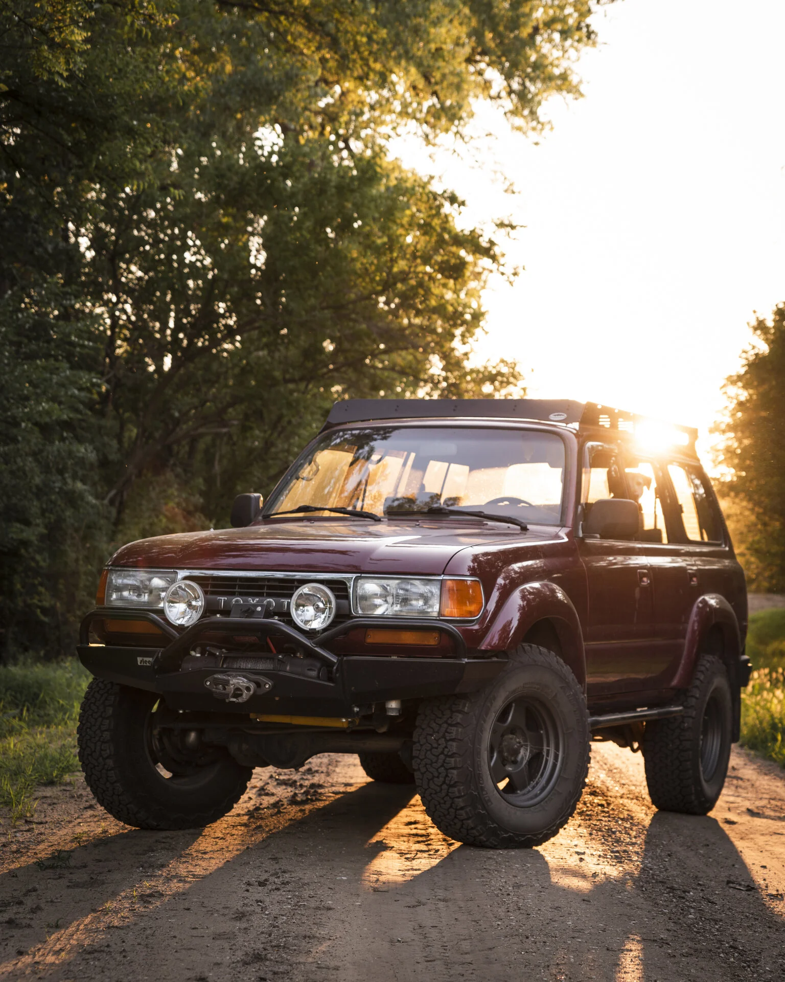

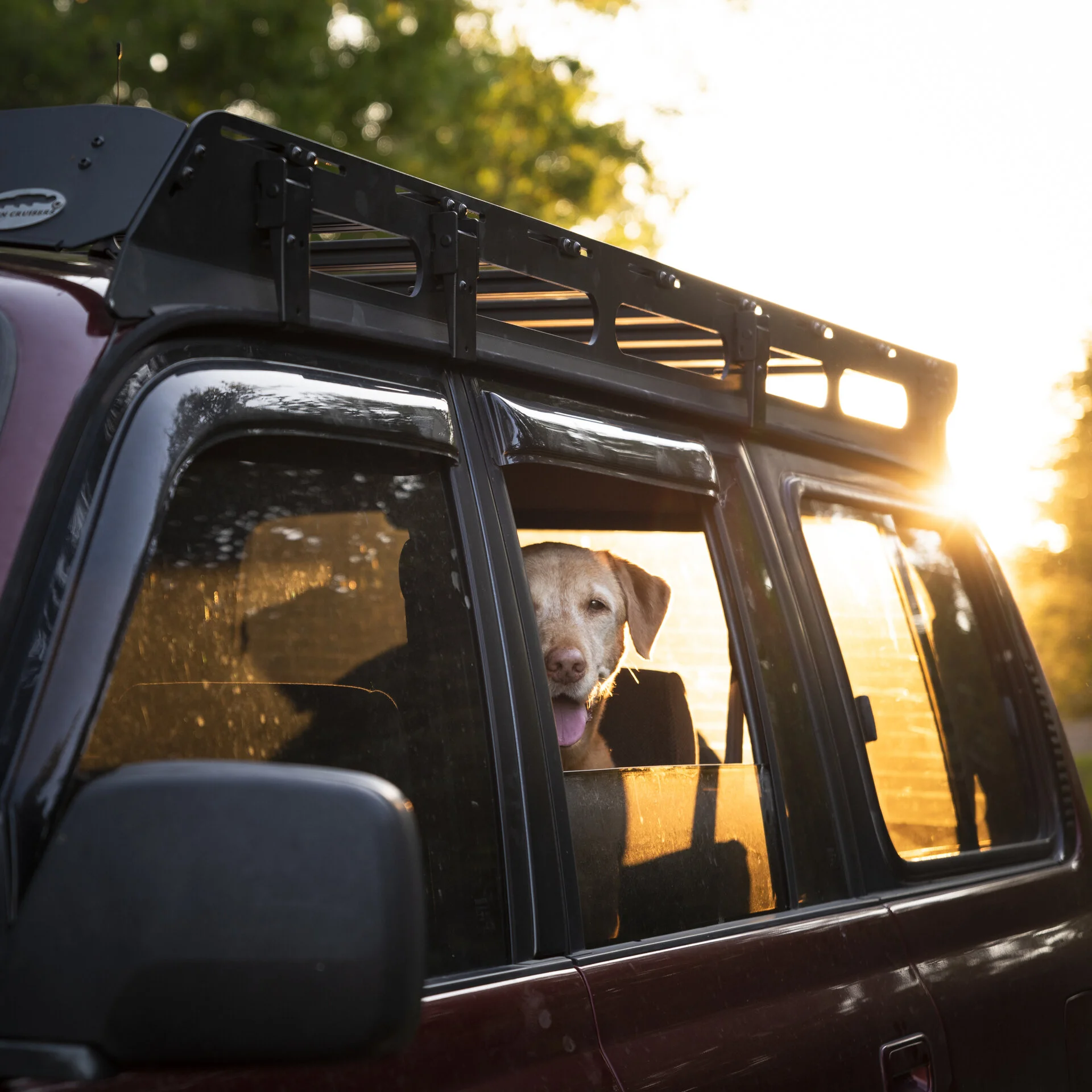

The rack is one of my favorite additions - it totally changes the look of an 80.

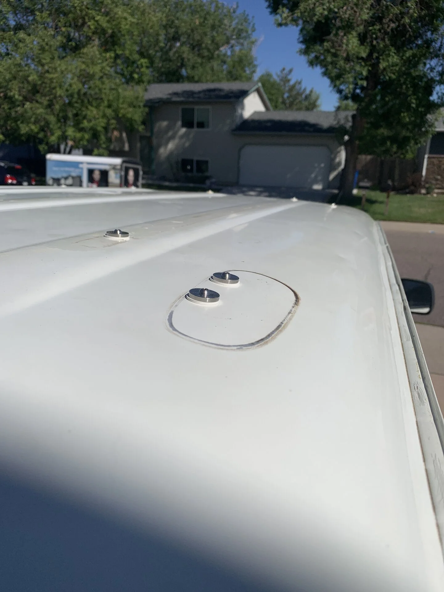

Just deleted my 80 Series OEM roof rack to install the Bowfin. If anyone else was wanting a simple solution for the delete see below, costs about $100 in hardware from McMaster Carr:
95608A125 Stainless Steel Ultra-Wide Flanged Button Head Screw, M5 x 0.8 mm Thread Size, 20 mm Long
Note: (16 required for full delete, 8 for delete of just corners, not the ribs in the middle)
99186A136 Weather-Resistant EPDM Rubber Sealing Washers for M10 Screw Size, 10.5 mm ID, 20 mm OD, Packs of 50
Used a $9.99 harbor freight heat gun to remove the metal top from the rubber ribs in the center. I then would peel the rubber taking as much of the black sticky 3M foam tape that adhered to the ribs with it in a single pull. Anything left I would hit with my eraser wheel attached to my drill. $10 Amazon eraser wheel worked fine and also did a good job to clean up the paint under the OEM feet in the corner. I’ll have to do something about the paint that’s bare down to metal in the near future.

This looks great and just what I've been looking for. Just put an order in, thank you. Ordered a set of 16 screws and a pack of washers, it ended up being 124.50 shipped to Austin. I planned on ordering a similar set from wits-end a few months back but won't order anything from him due to the risk of not getting the parts. Did you paint the washers?
I snagged a 100 series rack two weeks ago but haven’t got an email that it’s shipped yet. Website said “sold out” after, so I hope it wasn’t a glitch ha
The same happened to me for the 60 rack. 2 weeks ago now, but no update. Did yours ship?
Washers I ordered came white, I did not paint them. You end up saving over $40 from the Wit’s End kit since it requires you order (2) kits if you want to do the complete OEM roof rack delete including ribs.
