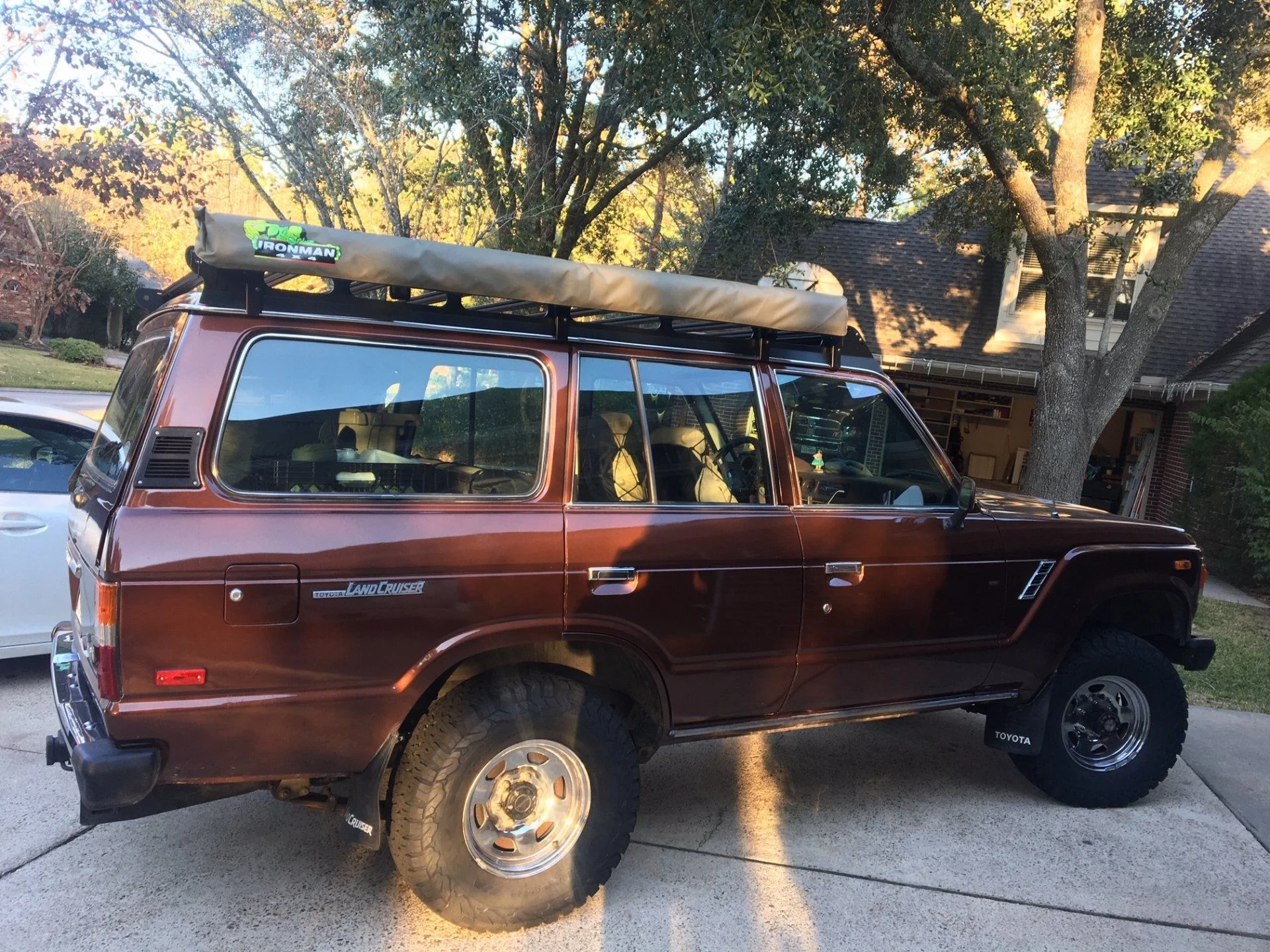

Awning...so I love my rack. A low cost option for an awning is the awning available from Ironman. I ordered 2 extra mounts and I can switch the awning to either side of my Bowfin rack. A little tricky to find the right spots to drill holes for the mounts and since the receivers are offset from center the awning does not sit in the same place when you change sides. I have round ring lock pins that hold it just fine and it is very easy to switch from side to side. The awning comes with lights that you can plug into your lighter. I have had it a while and used it several times. Hard to beat for $3-400bucks.

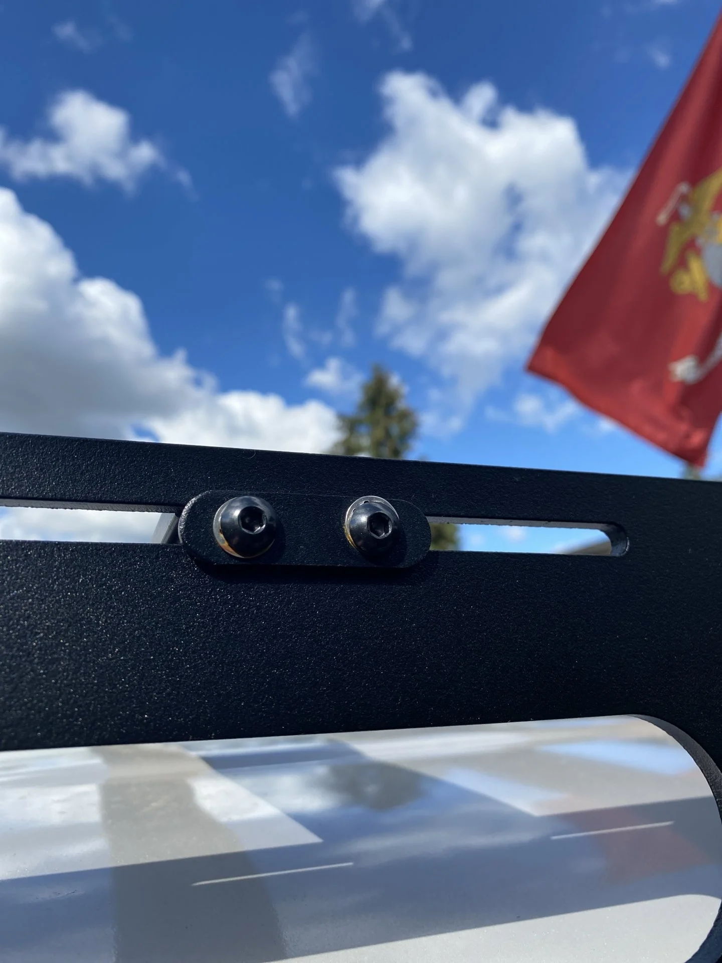

Had my rack a month now and some of the lock washer fasteners are rusting making my sweet rack look crappy anybody have any issues with this?
I’ve had mine for about 4 months and the only rust I see is on the bolt heads that lock the latches in place. When I installed it I smeared anti seize on all the fasteners so maybe that helped.
Those look like internal tooth lock washers. You could replace with stainless lock and flat washers. No biggie.
Yah I just assumed they would be stainless when I installed but I will prob go the route you suggested.
