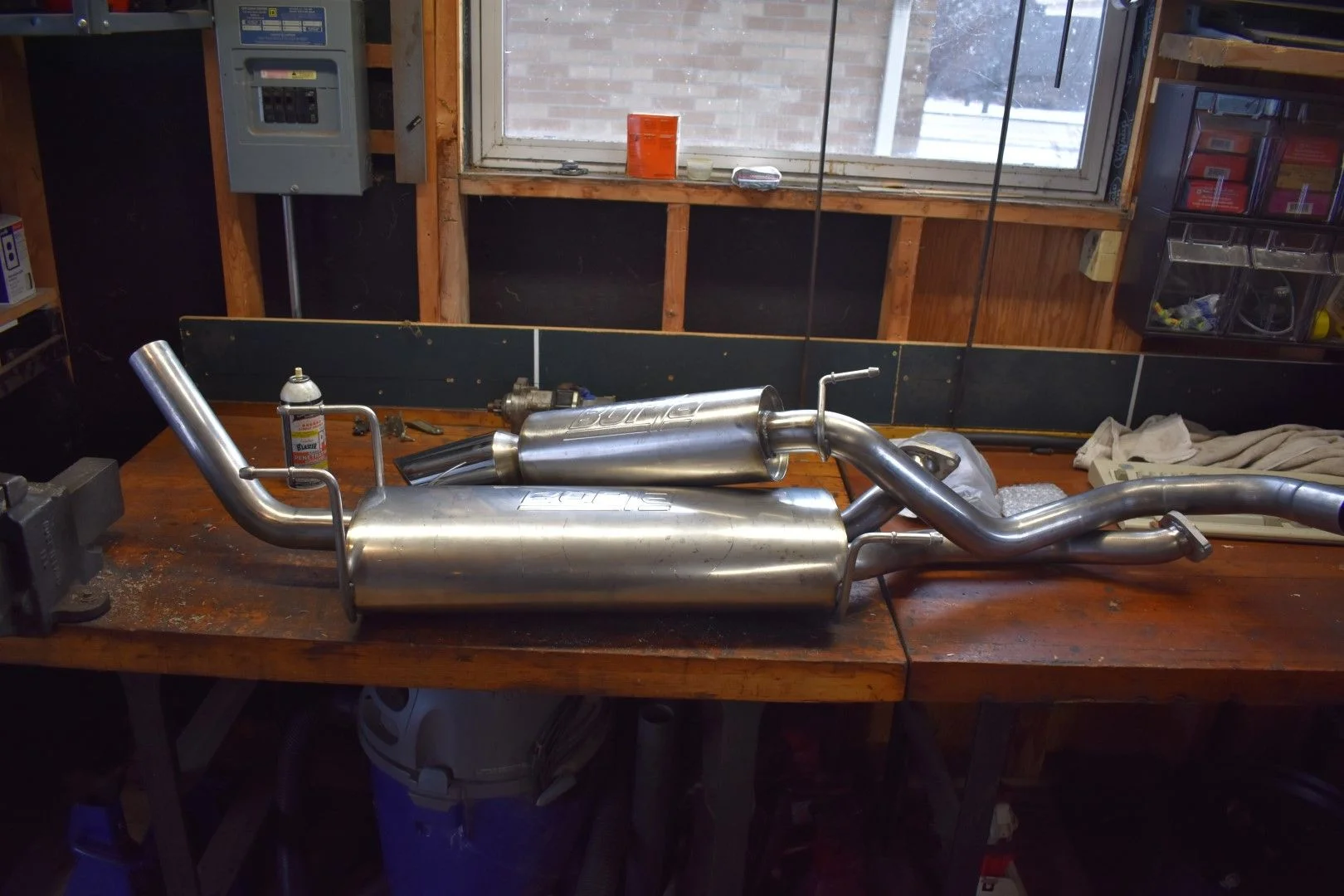

All the components that Borla included laid out on my workbench

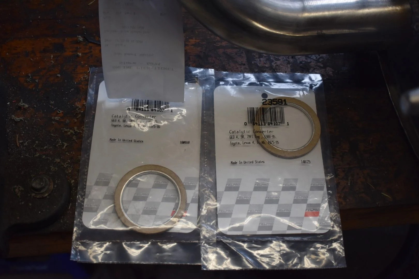

Make sure you buy qty 2 of the new exhaust gaskets, and new exhaust bolts if yours are super rusty. Mine came off with some CRC freeze off and MAPP gas. Gaskets are Felpro 23591, stock at Advance Auto and your 25% coupon code will work with them.

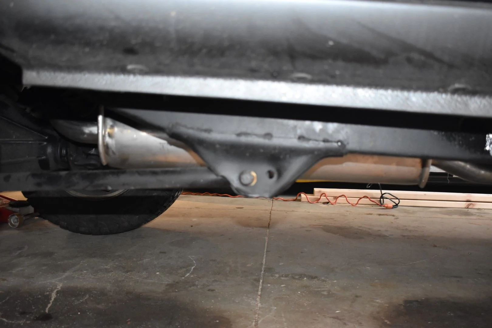

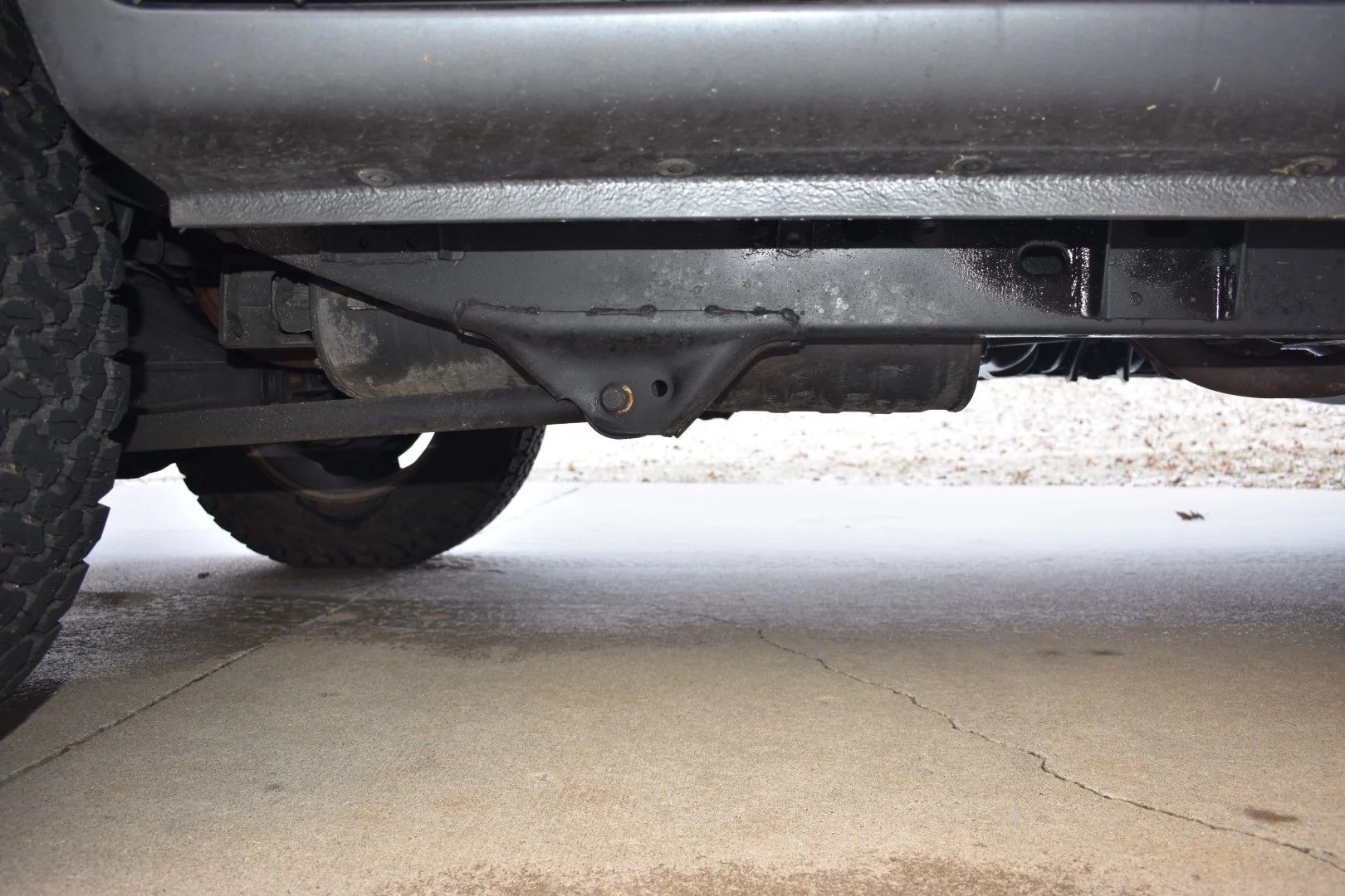

Side view of stock main muffler.
Rear view of stock rear muffler.

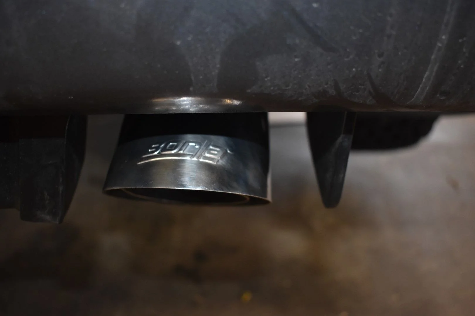

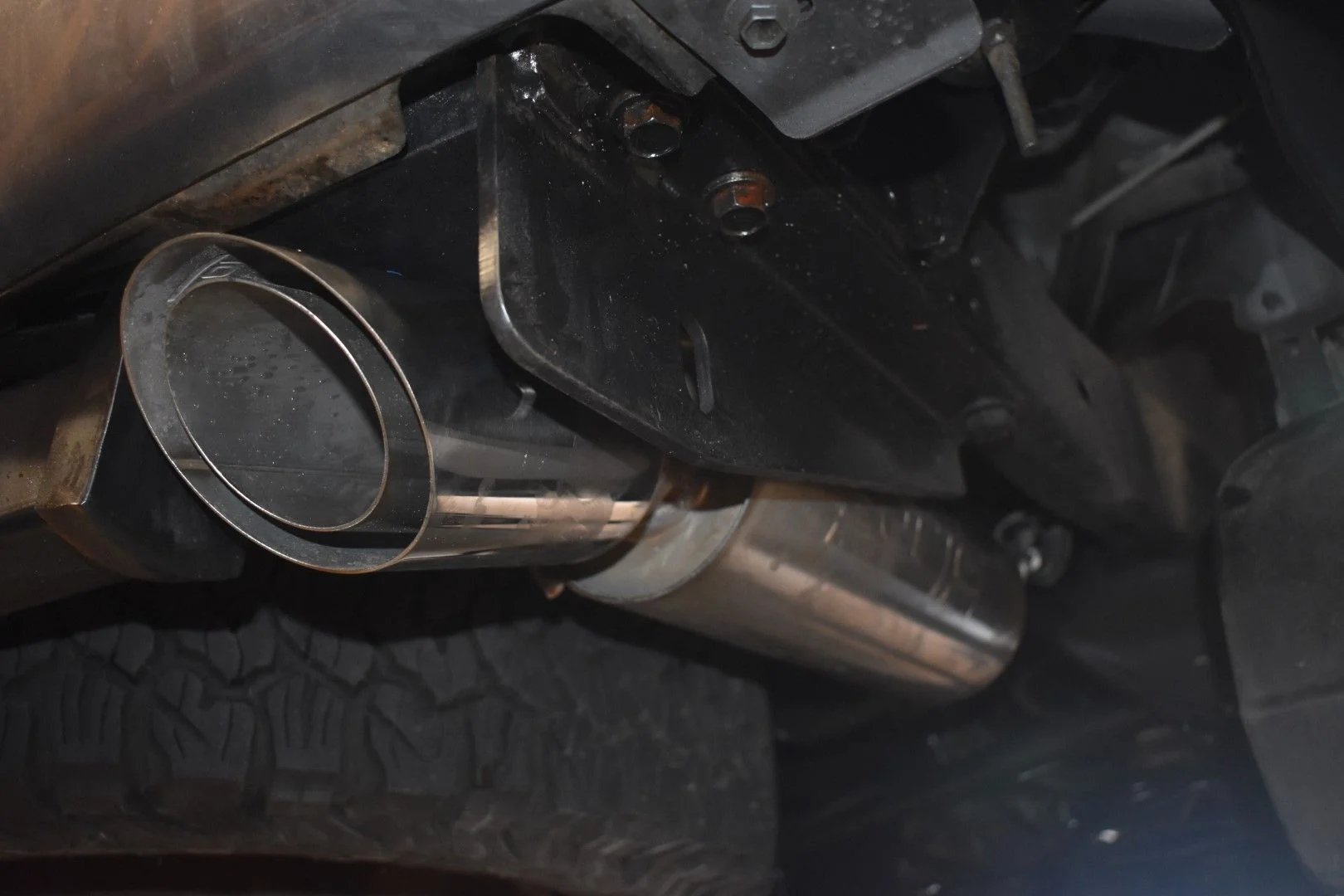

Borla Tip

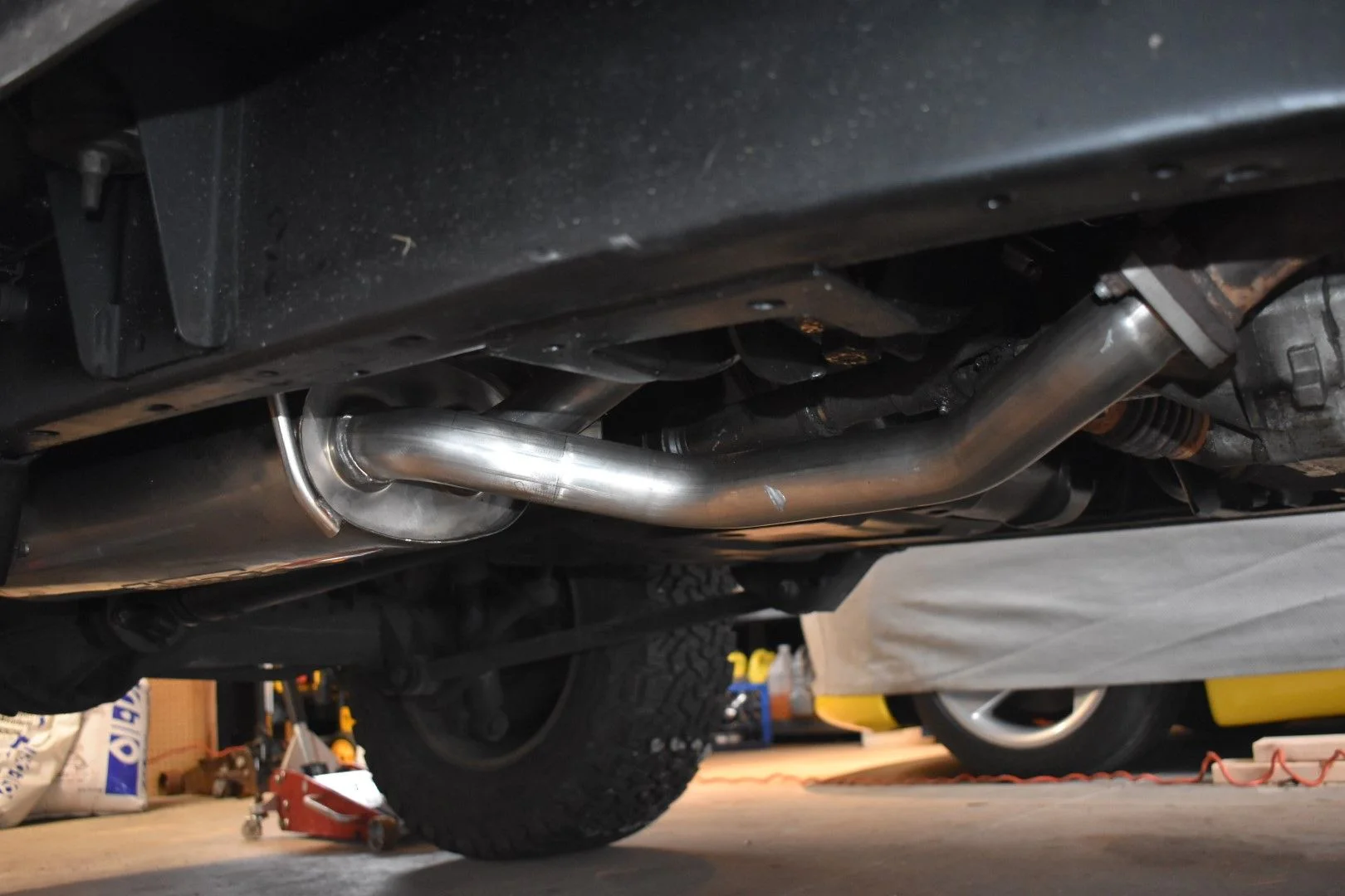

Borla Resonator and Mid-Pipe Fitment

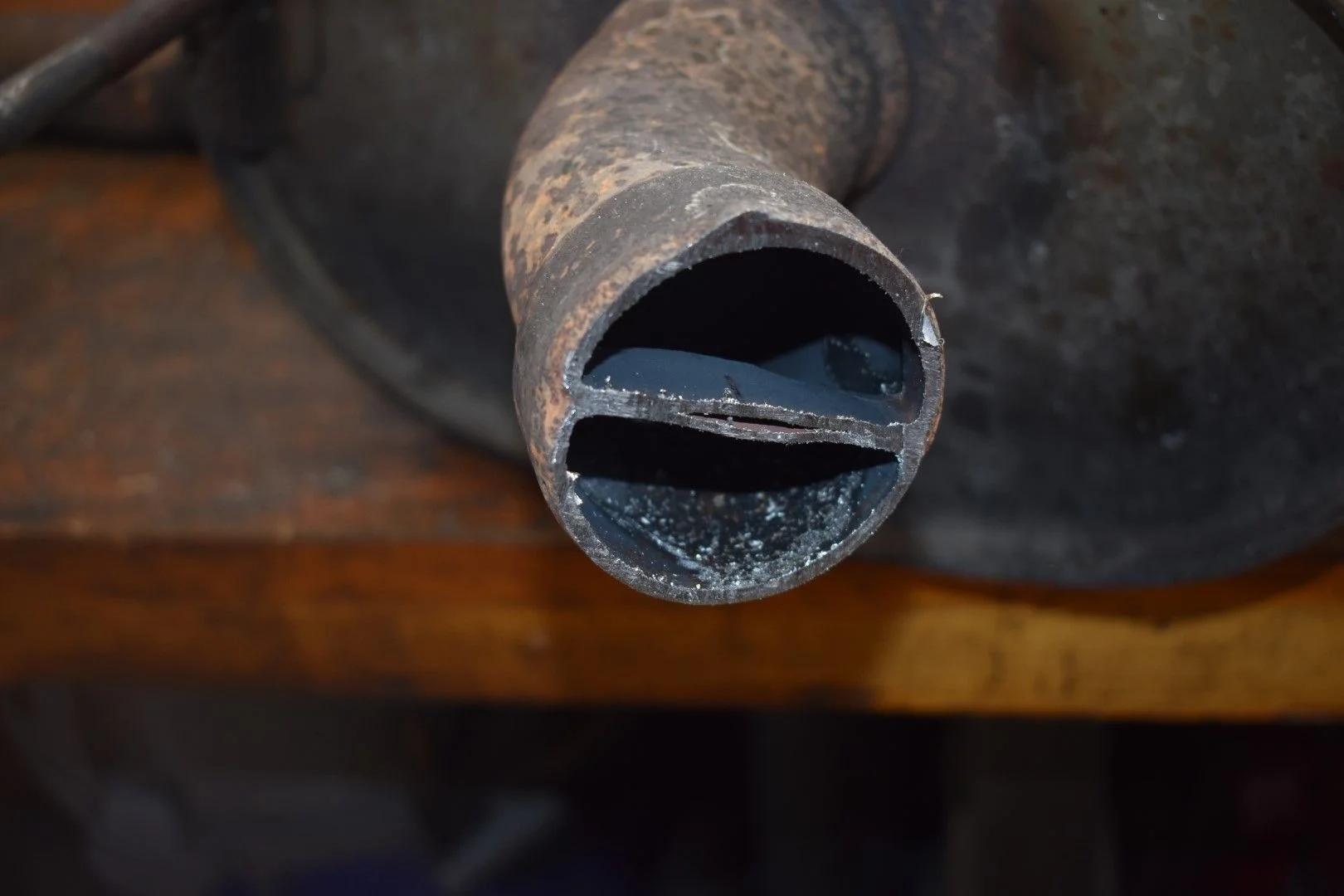

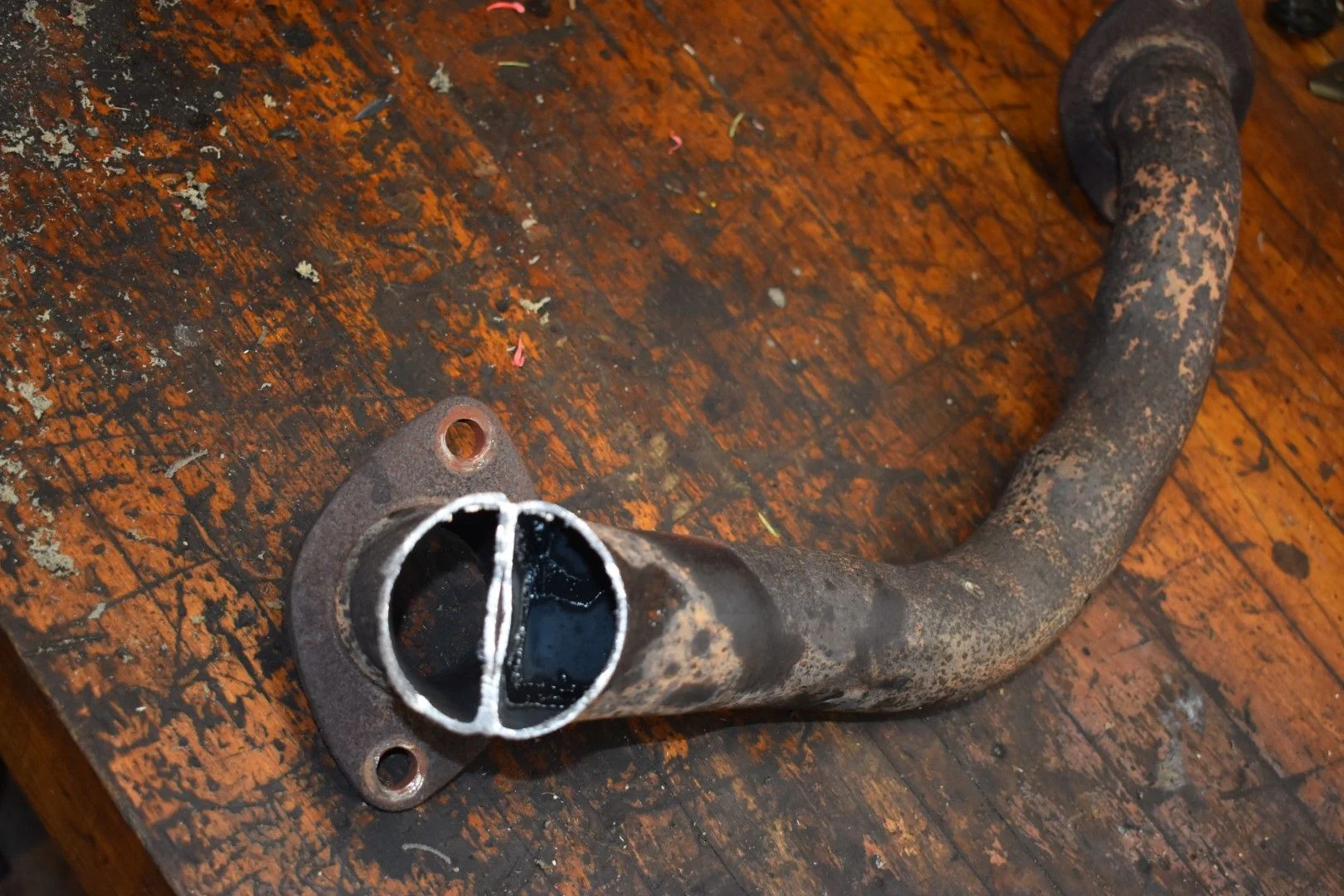

This is the inlet to the factory muffler. No bueno. Should really wake up the truck, especially the VVTi 06 and 07s.

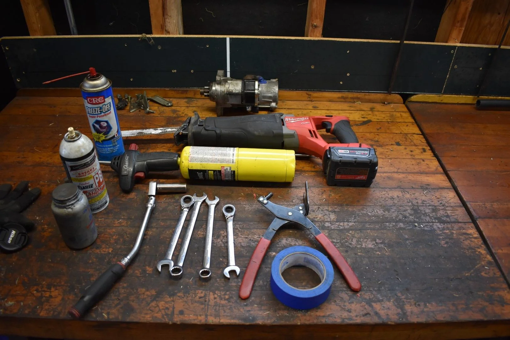

Tools required:
Long handle 3/8" drive ratchet (I used my Snap-On long handle flex head, it was the bees knees.)
15mm ratcheting and combo wrench for Borla-provided clamp
14 mm ratcheting and long pattern combo wrenches for exhaust bolts
Tape to wrap the tip to keep from scratching it or your bodywork during install
Mapp gas torch
Sawzall with metal blade to cut stock exhaust over axle
Your favorite penetrating oil
Antiseize for the slip joint and the bolts
And most important! Exhaust hanger pliers. One of those tools you will use once and wonder how you lived without them.

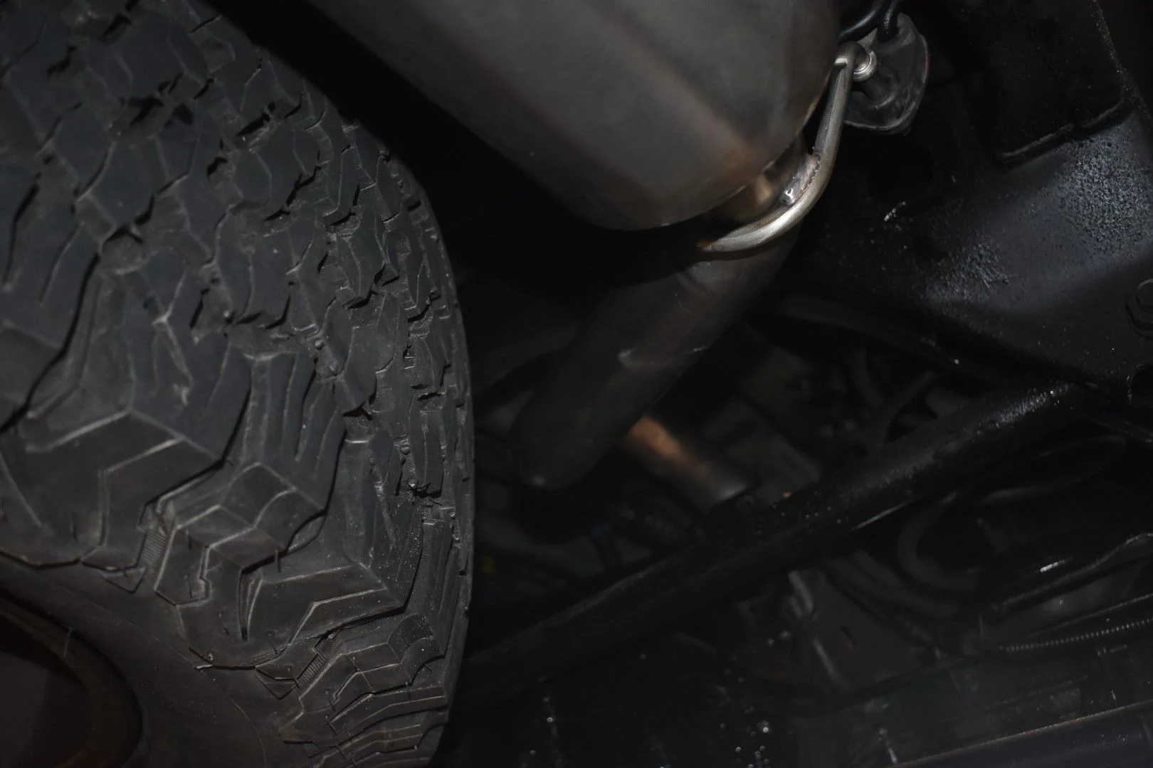

Can you guys comment on the bend right above the axle compared to the stock exhaust?
My concern is that if the bend is lower, that the axle may contact the piping when at full flex.
Thanks
The bend was comparable, there is a clamp that the stock exhaust does not have toward the front since the system is split. If you rotate the clamp, it will work just fine for you.
I wonder if this would fit through my hitch, it surrounds the exhaust tip.
I think this exhaust plus headers would be fantastic!
I am gonna have to go with "No" on that option. The tip will be too big since it is 4"+ diameter and installed at an angle. You do not want it rubbing on anything or it will rattle.
You are gonna want to look for the OEM or Draw Tite hitch that just goes above the exhaust or look into the Doug Thorley setup with no tip.
