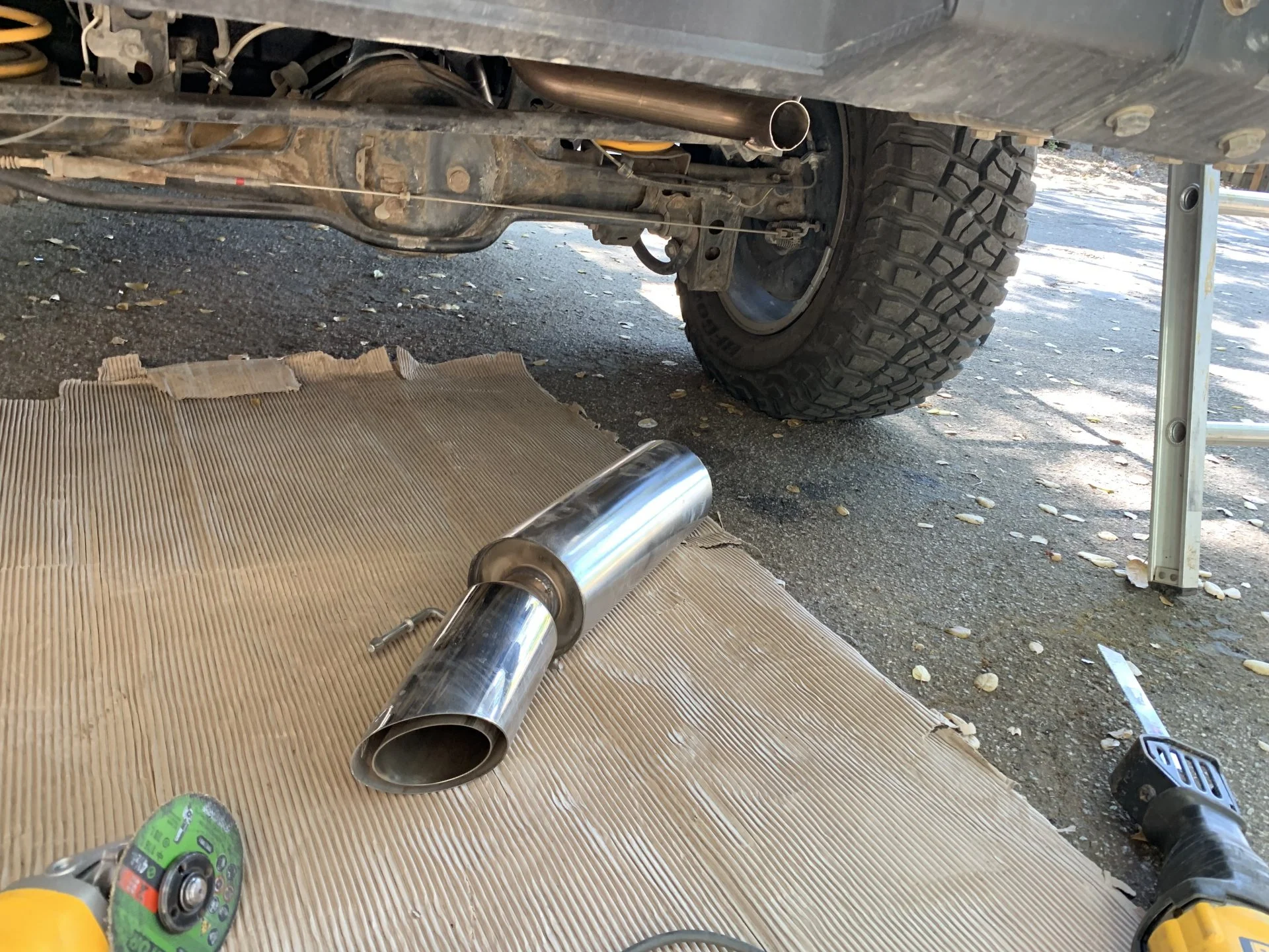

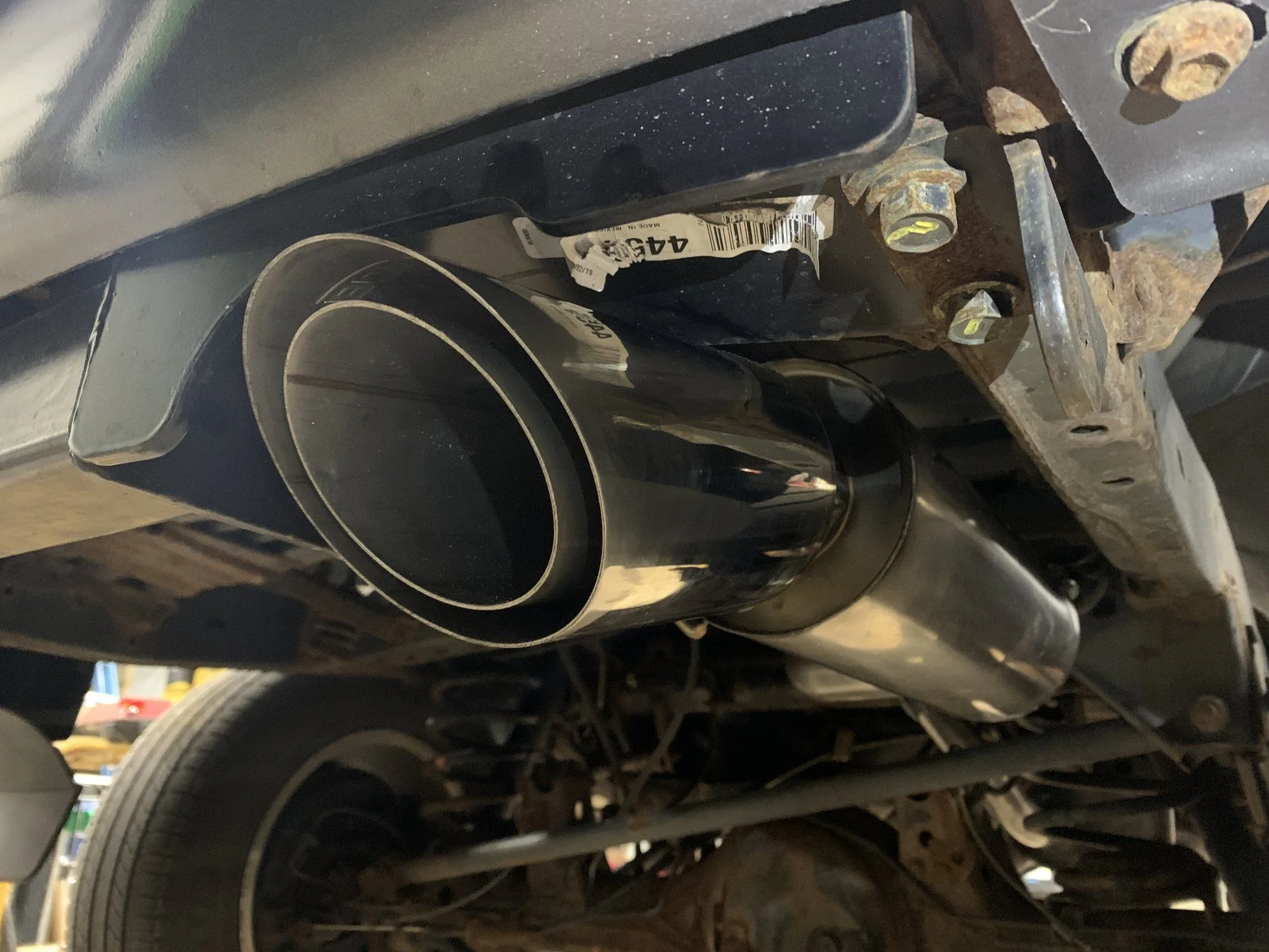

I picked up a cheap 2.25" shiny exhaust tip like this one (Amazon.com: Stainless Steel Rolled Angle Cut Exhaust Tip 2.25" ID, 3.00" OD, 18.00" length: Automotive ) my local exhaust shop, Exhaust Pros, welded it on for twenty bucks! Love that place!
Please update us with photos of the before welding on the new tip and after please!
I'm in the same boat with that tow receiver, interested on how the finished look is.

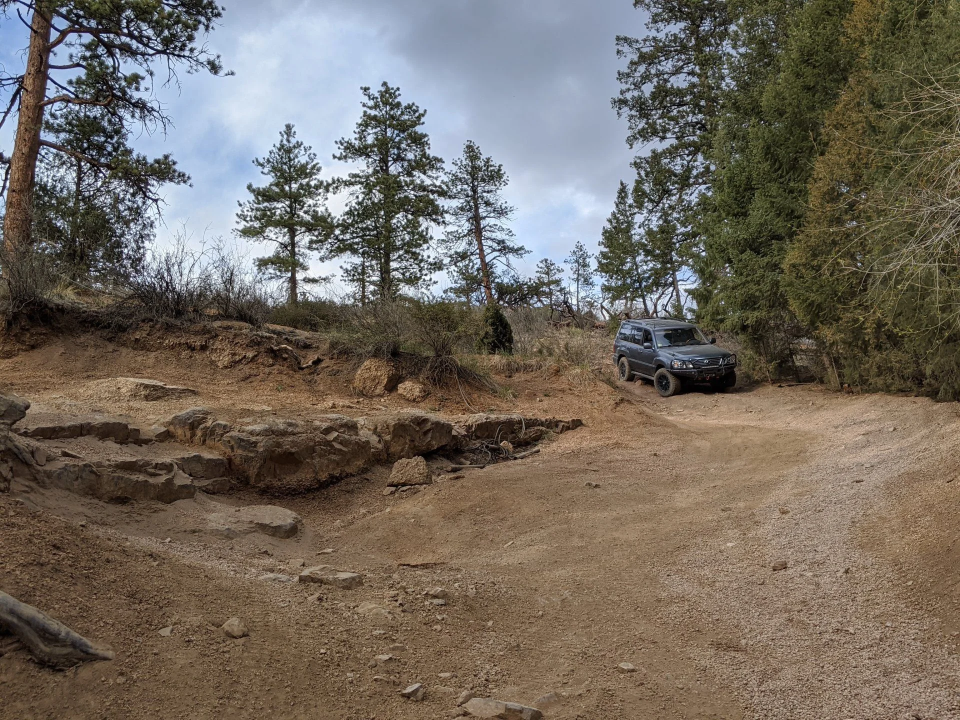

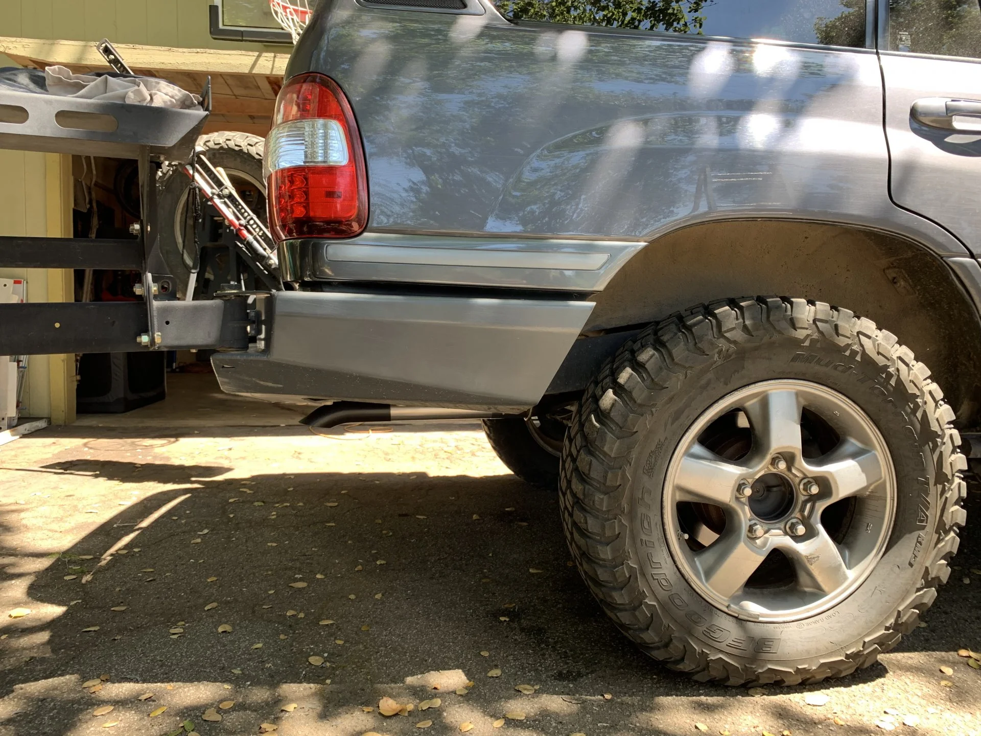

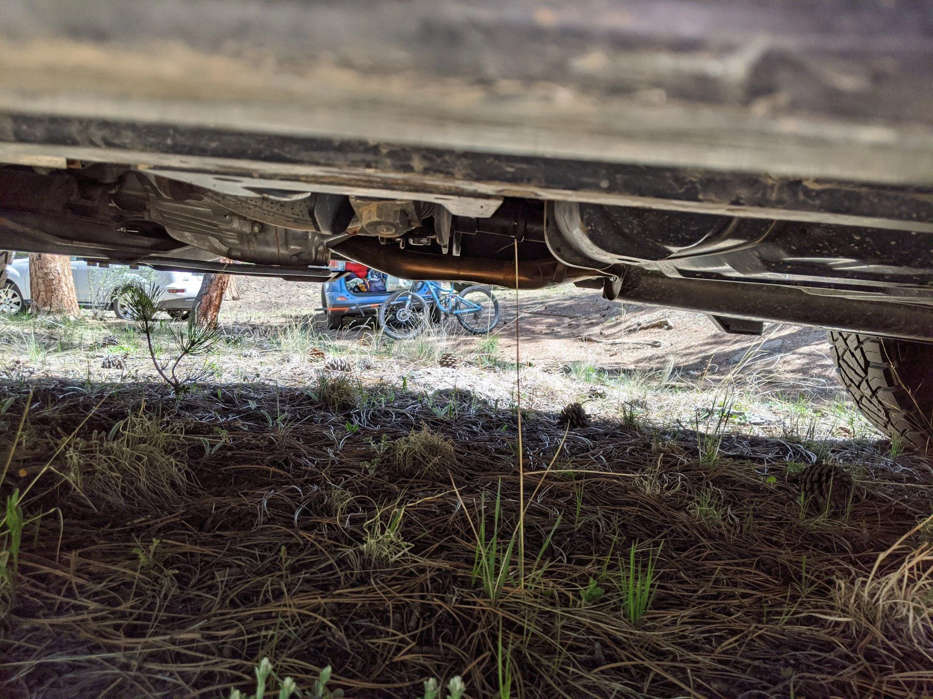

Those of you worried about the exhaust midpipe looking like it hung a little too low were right. Luckily I was able to "clearance" it easily.
I clearanced it on this rock ledge to the left. Didn't make it up this time, will come back with lockers. Didn't touch anything else except my sliders.
No, I'm not worried about any performance loss or other real issues. It does suck to bend up a shiny new exhaust but it was inevitable if it doesn't tuck where it should. See this video below for reassurance:

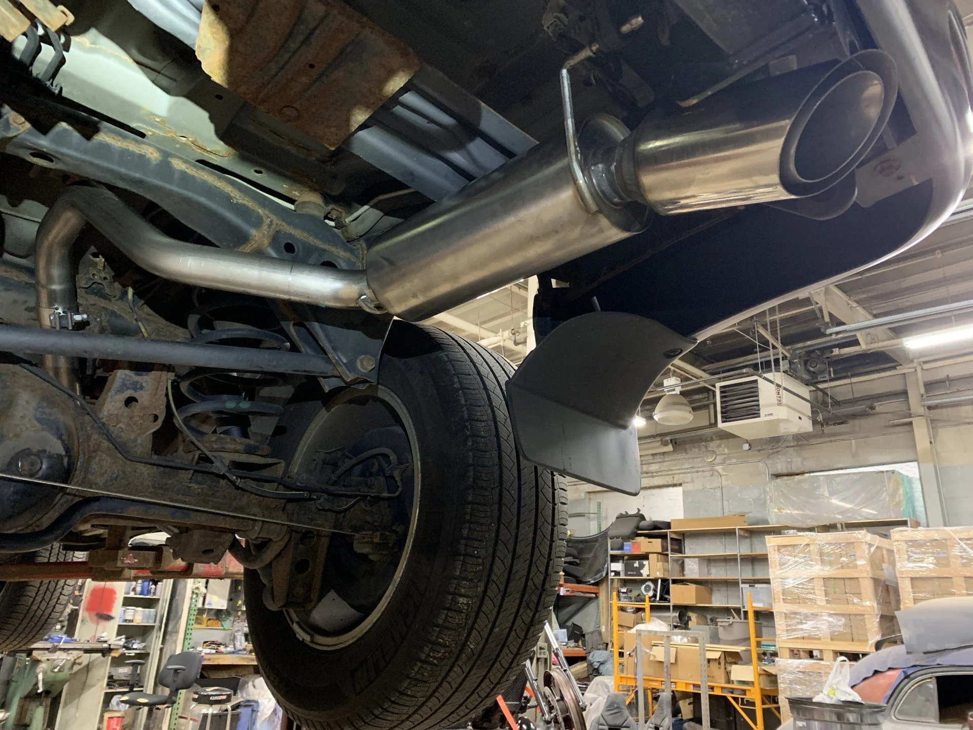

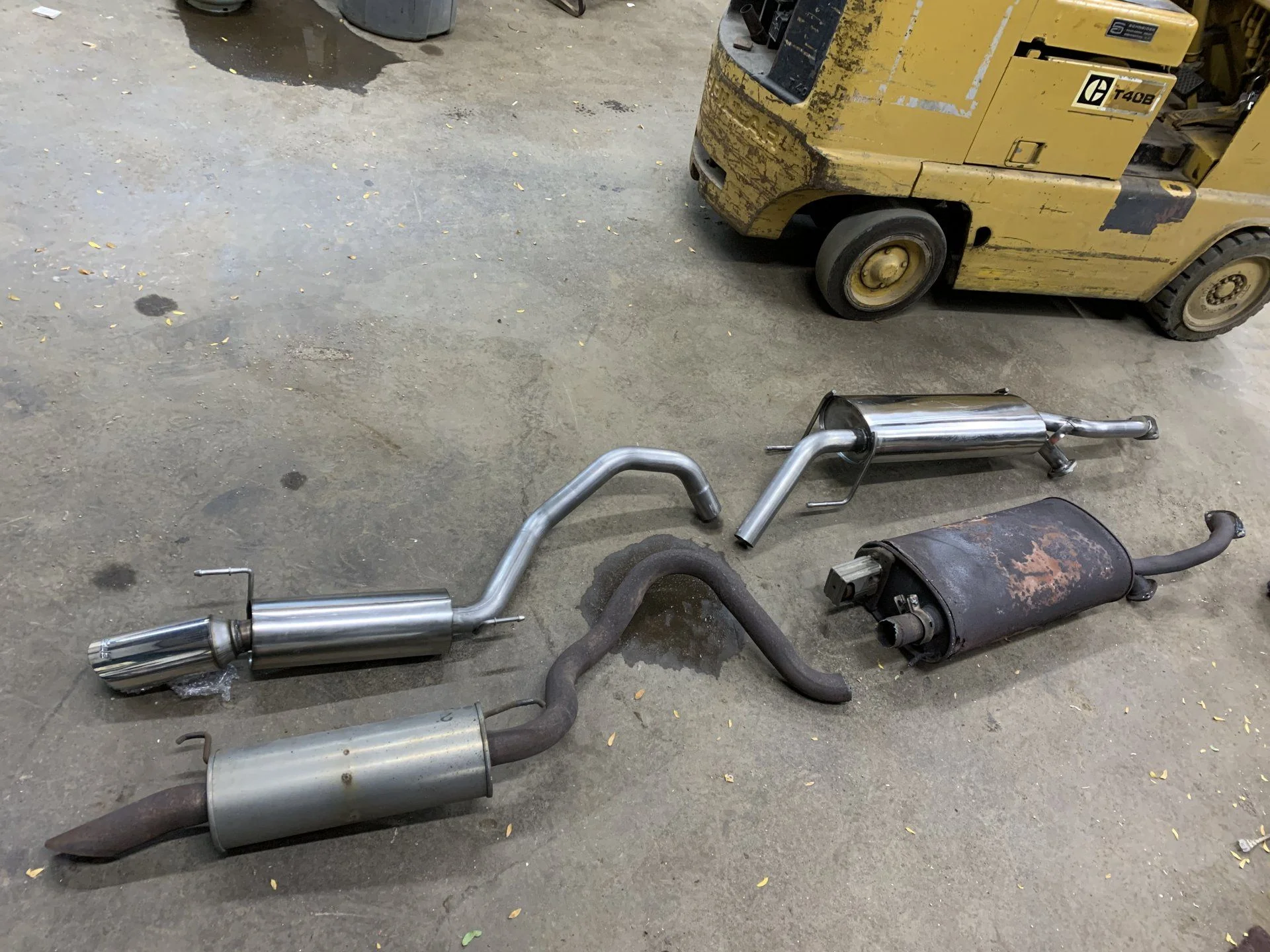

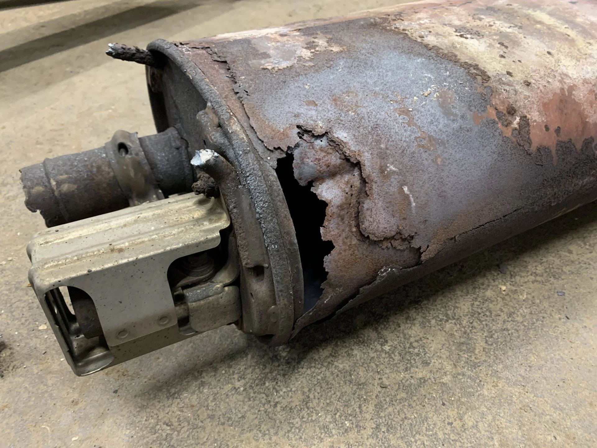

I completed a swap on my OE factory exhaust to the Borla cat back last night. While I was under there I also chased the threads for the splash guard and replaced with stainless steel hardware, serviced the diffs and t-case, and lubed the u-joints and slip yokes with Lucas. My crusty old factory exhaust was quickly convinced to come off after meeting the business end of a plasma cutter. The Borla system does have a very minor 1900 RPM drone, but it's barely noticeable and is way less than the obnoxious drone my rotted factory exhaust was spewing. The Borla also sounds way better at idle and maybe it's in my head, but it feels like my Cruiser revs better and engine braking is slightly less harsh. Although the latter could be due to servicing the gear oil.

HOWEVER, I also cut that blingy resonator right off. That thing just hung way too low. It was me, or the first rock on the trail that was gonna take it out. I figured I should be the one to do it.
