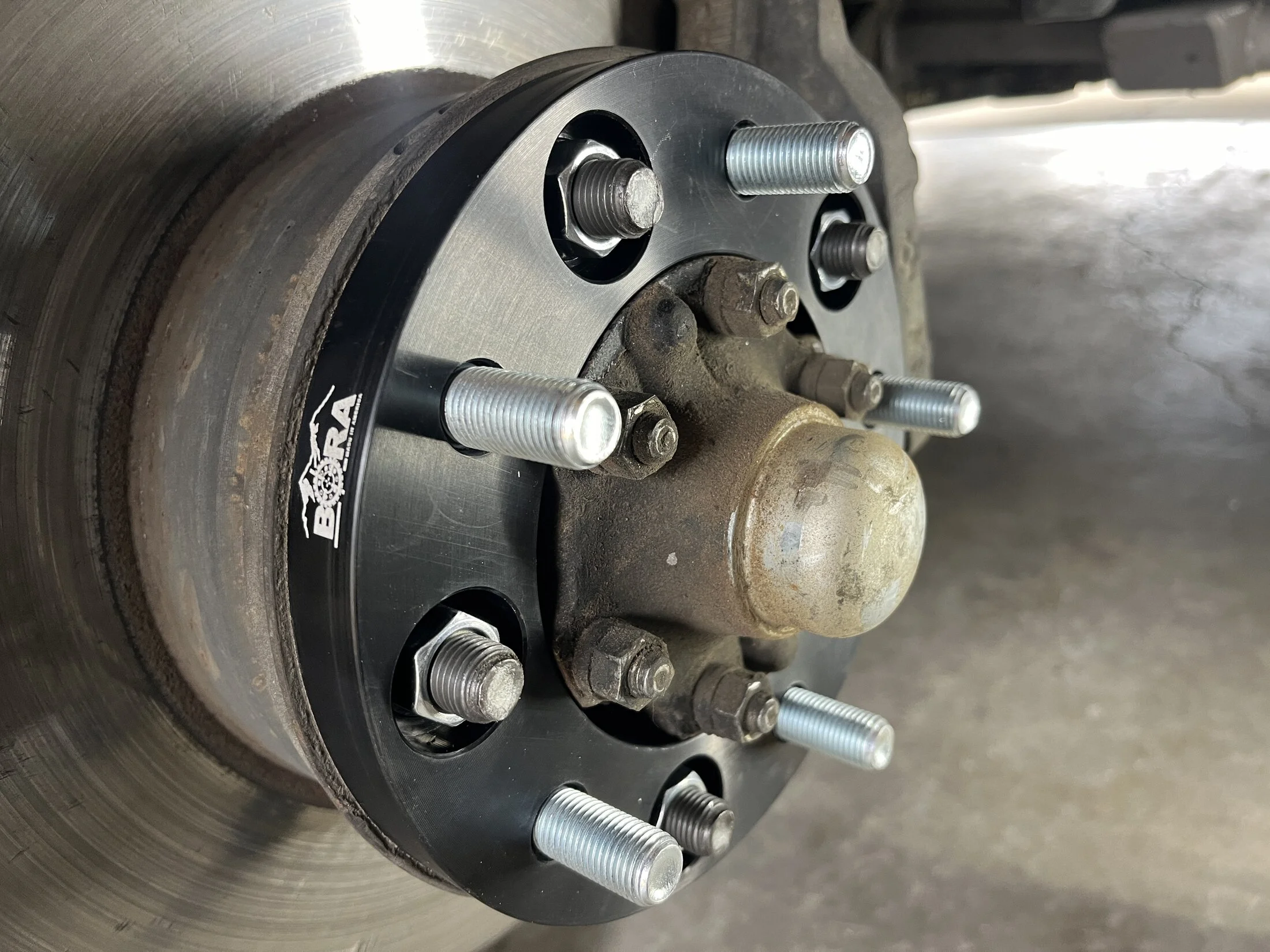

I got a set of 3/4" BORA spacers back in November and was concerned when they got here since they didn't have the typical teeth for the front spacers. I called to ask and I can't remember the conversation well but he assured me that what I got was correct. I currently run 1.25" spacers but got them because I want to maintain the exact same tire poke when I go to a different size wheel and tire. I haven't test fit them and probably won't until I'm switching setups so I guess I'm kind of crossing my fingers that they work as BORA assured me they would. It doesn't feel like they're going to work. I'm not sure why they would have this as an option. I remember asking specifically if they were hubcentric but it seems like without the teeth how would they be?
I run a set of 3/4" BORA spacers like that. No teeth. Zero problems after years of running them with RW wheels.
FWIW, I did the same thing -- called to confirm. He assured me that what I got was correct.
I'm following this thread because a few years back I purchased a 1" set of BORA spacer adapters that have the "teeth" on the hub end, and when I finally got around to installing them I found that they didn't fit due to interference with the hub bolts. I didn't quite understand it.
Good to know they worked for you! Very strange that the 1" spacers did not work. I stacked the 3/4" on top of a 1/4" and there was just enough room.
I talked to Lenny today, he said my 3/4" spacers with "teeth" will not work and should not have been made. He said the wheel will still center itself on the front hub without the ring on a 3/4" spacer so that's what I'm going to try. He's going to send me another pair next week and I'll ship the old ones back.

Update:

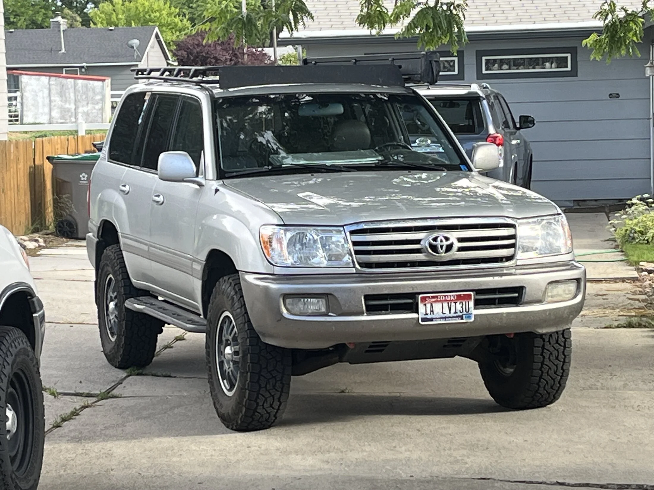

Lenny took care of the situation. I installed the correct 3/4" spacers the day before I road tripped top Santa Fe. I've got about 3500 miles on them so far and everything is working perfectly. And I really, really like the +31 offset I have now.
For the record I have 35x11.50's which are the same width as my old 285/70 KO2's. The front sidewalls are just 1/2" proud of the fender in AHC normal.

Update:
For the record I have 35x11.50's which are the same width as my old 285 width KO2's. The front sidewalls are just 1/2" proud of the fender in AHC normal.
Thank you for the update and pics!
Lotta great yotas in your driveway 😎

Awesome! That's exactly why I wanted to go down to 3/4" spacers with the Rock Warriors instead of keeping the 1.25" spacers. That looks great imo. The dome caps look good too.
Thanks! The stance is a lot more aggressive than it was but still subtle. The dome caps were a necessity with the 1/4" slip on spacer, I'm actually hoping the 3/4" spacer will give me enough room to flatten the dust caps and go back to the RW flat caps.
I'm fairly certain I remember reading that they will fit without flattening the dust caps, but I could be wrong. Keep us updated.
Can confirm the OEM RW caps fit with the dust caps hammered flat on 3/4" wheel spacers.
