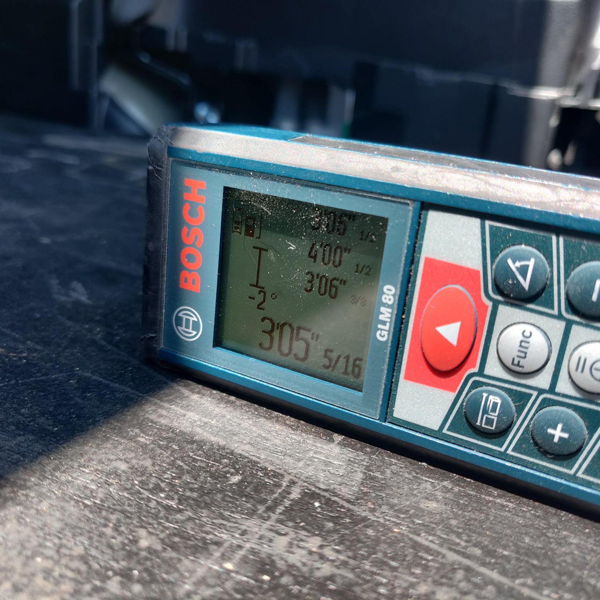

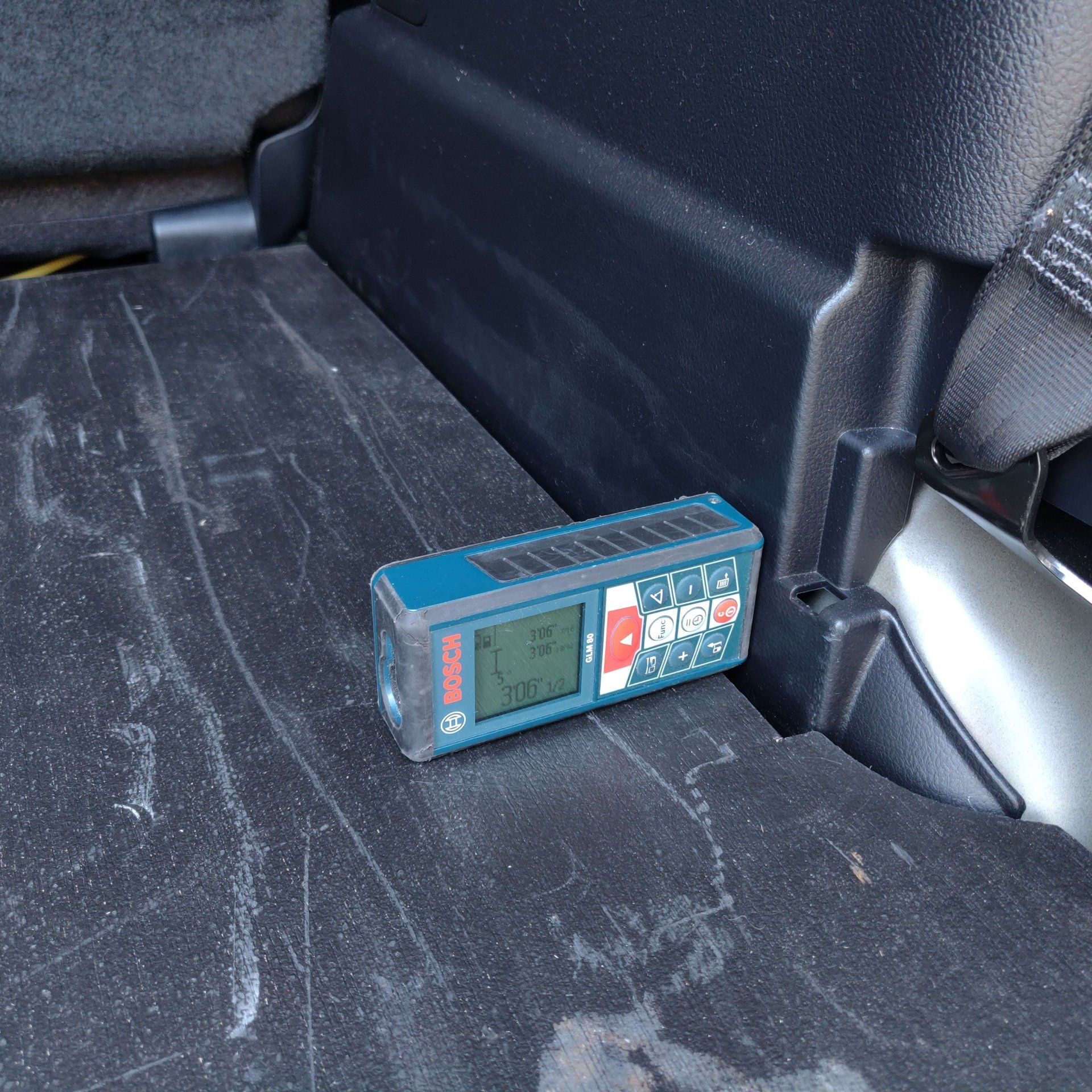

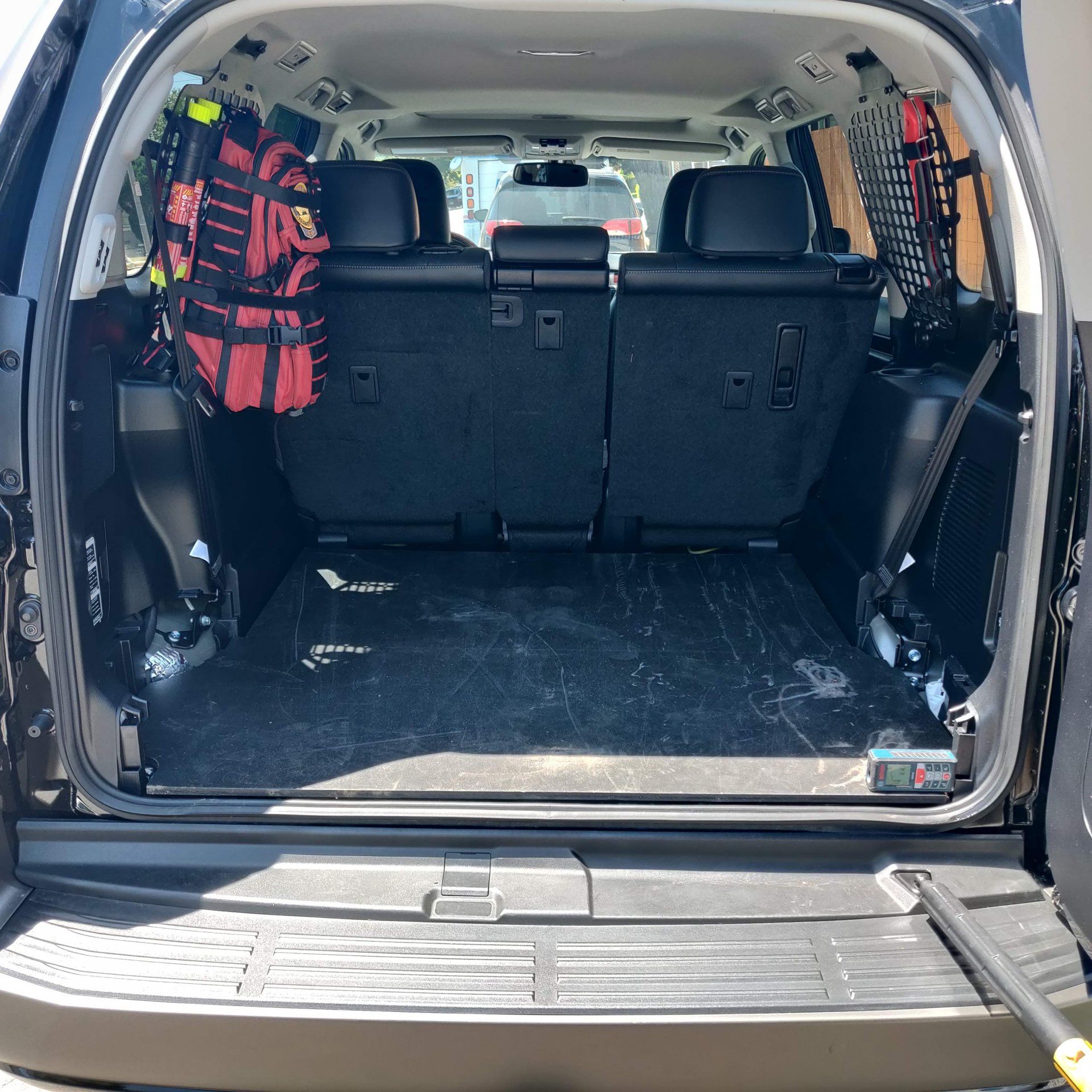

Once I get the seats out I will have to measure the width for the box (so I can order the drawer boxes). If anyone has any measurements of side to side between wheel wells with the rear seats removed, let me know and it will give me something to use for planning purposes. I will post up pictures on progress as I go and hopefully this helps others looking to tackle this same project.
Onward we go...Wish me luck
The last measurement is from the back edge to the plastic cover on the seat bracket. The seats are in the furthest back position...I think, and then the clearance reduces the higher you go because of the angle of the seats.
Let me know if you'd like be to check anything else.
I'm in the same boat as you and am working on a design for storage with refrigerator in the back.
Perfect Thank you. That is a big help.
