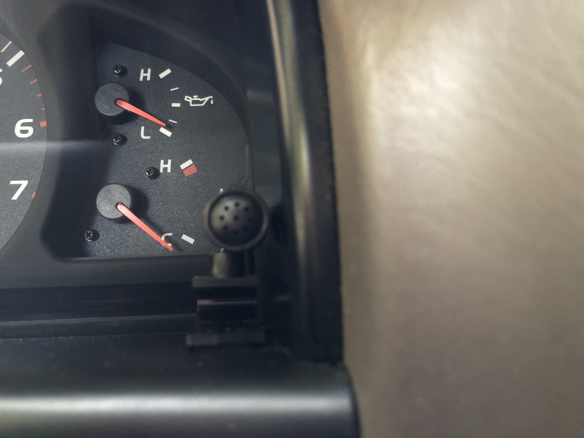

I mounted mine inside the cavity of the main Gauge cluster (speedo/tach) and it produces some reverberation. Anyone have any issues with placing it up high like the OP is suggesting?

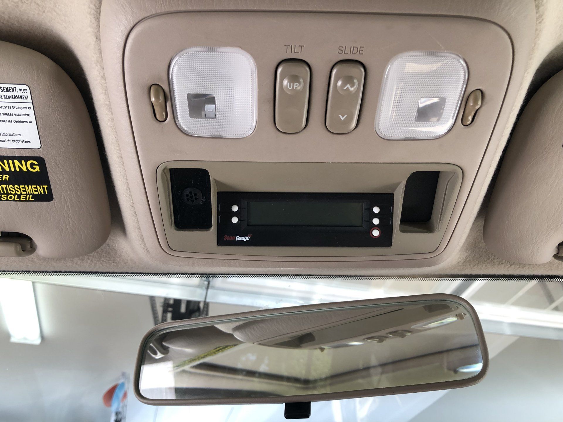

I did this as well. If you have or plan to have a ScanGauge II up in the sunglass area @BenCC makes a rad holder for up there that will hold one certain bluetooth mic. Other than that you can mount to the corner of the upper console holder up there. People can here me just fine and no reverbation that I have been told of.
@BenCC's mount is excellent! That's what I've got in my 100 series.
