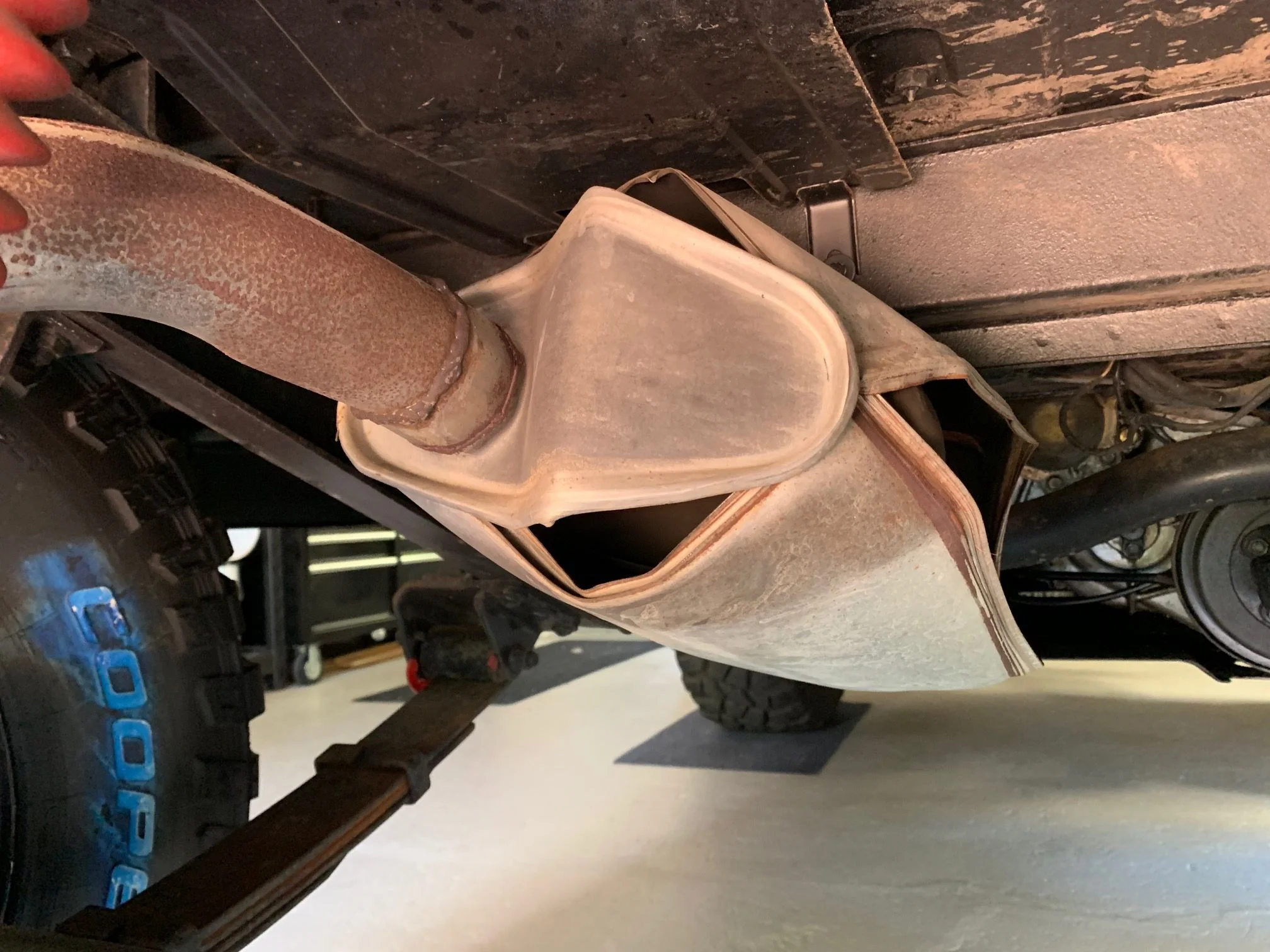

In the past 2 months I've had 2 backfires. Never had them before. The other day I had one that sounded like a bomb went off. Looked underneath and found this. A good friend who is an FJ40 guru thinks timing may be the cause. He's always been right and I typically take my truck to him for major fixes.
Just curious to know if anyone else has had this happen? The muffler is only a year old. The upside is the exhaust sounds a lot meaner now.
Looks like unburned gas made it into the muffler and then hit the right mix of gas/air/temperature and exploded.
Yup...that's the easy part to figure out. I'm looking for other solutions to look at besides timing. Go down the check list of items it might be. I have a new dizzy and a tuned carb so those two I can rule out. Aside from timing I'm not sure what else may cause this. Looking for more experienced users here to offer suggestions on what to check next.

Check for play in the distributor shaft. I know play on points will cause backfire. I haven't wore out an electronic dizzy yet.

Funny story. I remember doing the same as a kid. I replaced the points with an electronic ignition from Pertronix. I think the other poster has nailed it with my Weber 38/38. I leaned it out because it was running a bit rich. That carb most likely needs some attention so that is where I will start.
Thanks for the laugh!
you have a weber don't you... your running rich... most likely never adjusted correctly
advance the timing to about 12* and cleanout carb and adjust/jet it correctly
Yep you nailed it. A Weber 38/38. I don't know if that carb has ever had any attention given to it and a rebuild is probably in order. It's seen better days. Thanks.

Backfire is almost always timing related. Timing can also lead to excess fuel, due to rich mixture conditions and incomplete burning in the cylinder, making it's way down the exhaust and collecting in the muffler. Until it goes boom 💥

I found 2 things that seemed to take care of it. but I believe the main reason was a bad ground from my coil. I think it was grounded enough to run ok and idle ok but it would break up at higher rpms. I cleaned to surface of that ground contact and it suddenly reved smoothly and stopped smoking as well. so that unburnt fuel was making its was down then ignited.
secondly was I got a timing light and checked and adjusted my timing.
