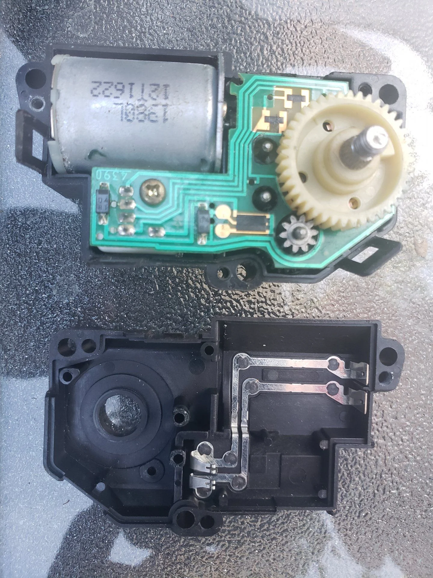

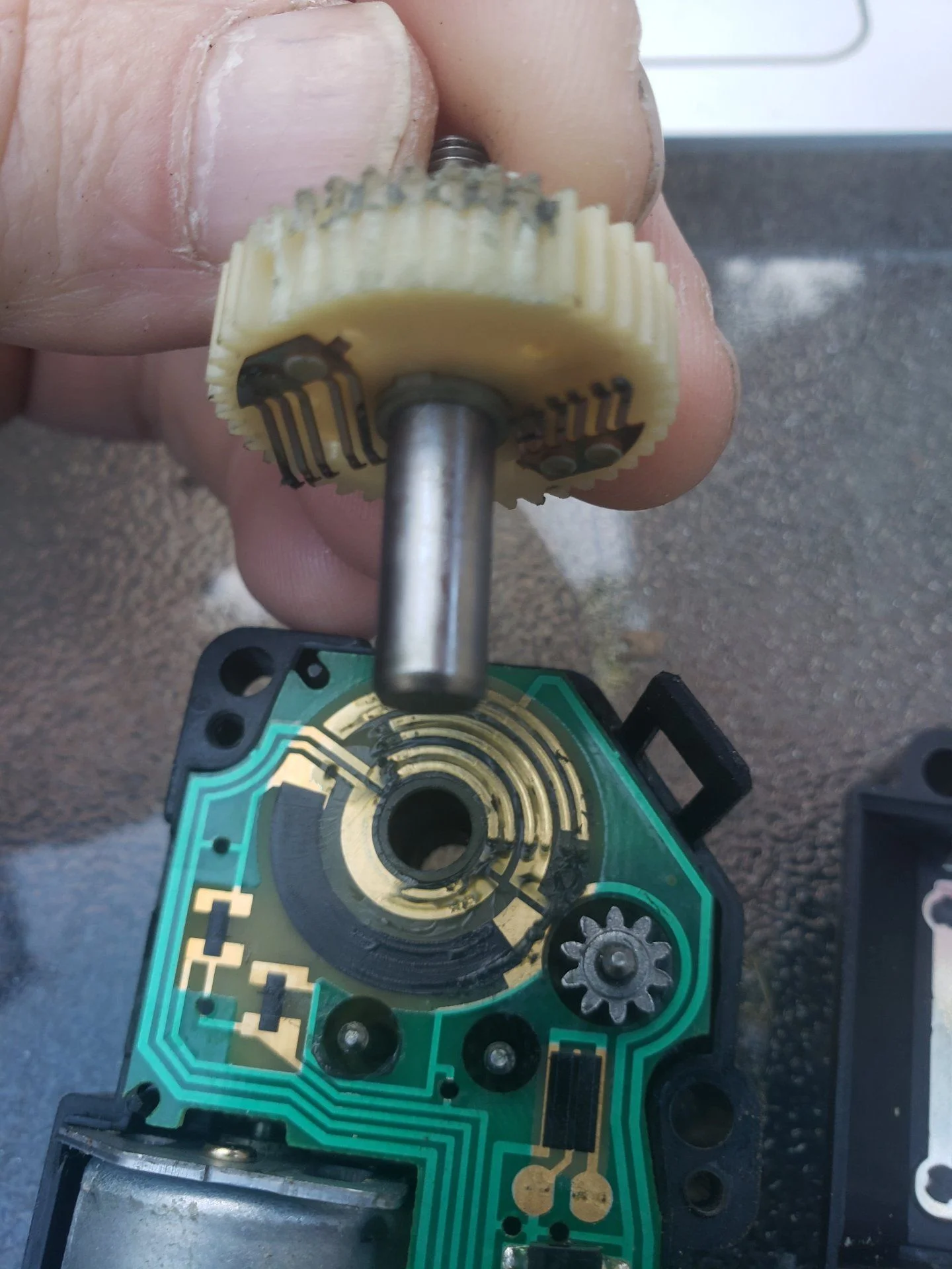

The air mix servo has plastic gears along with metal. Some may break and you´ll here the buzzing as it tries to engage.
Since they are hard to replace. I found rotating the bad teeth side 180 ° and it still works.
