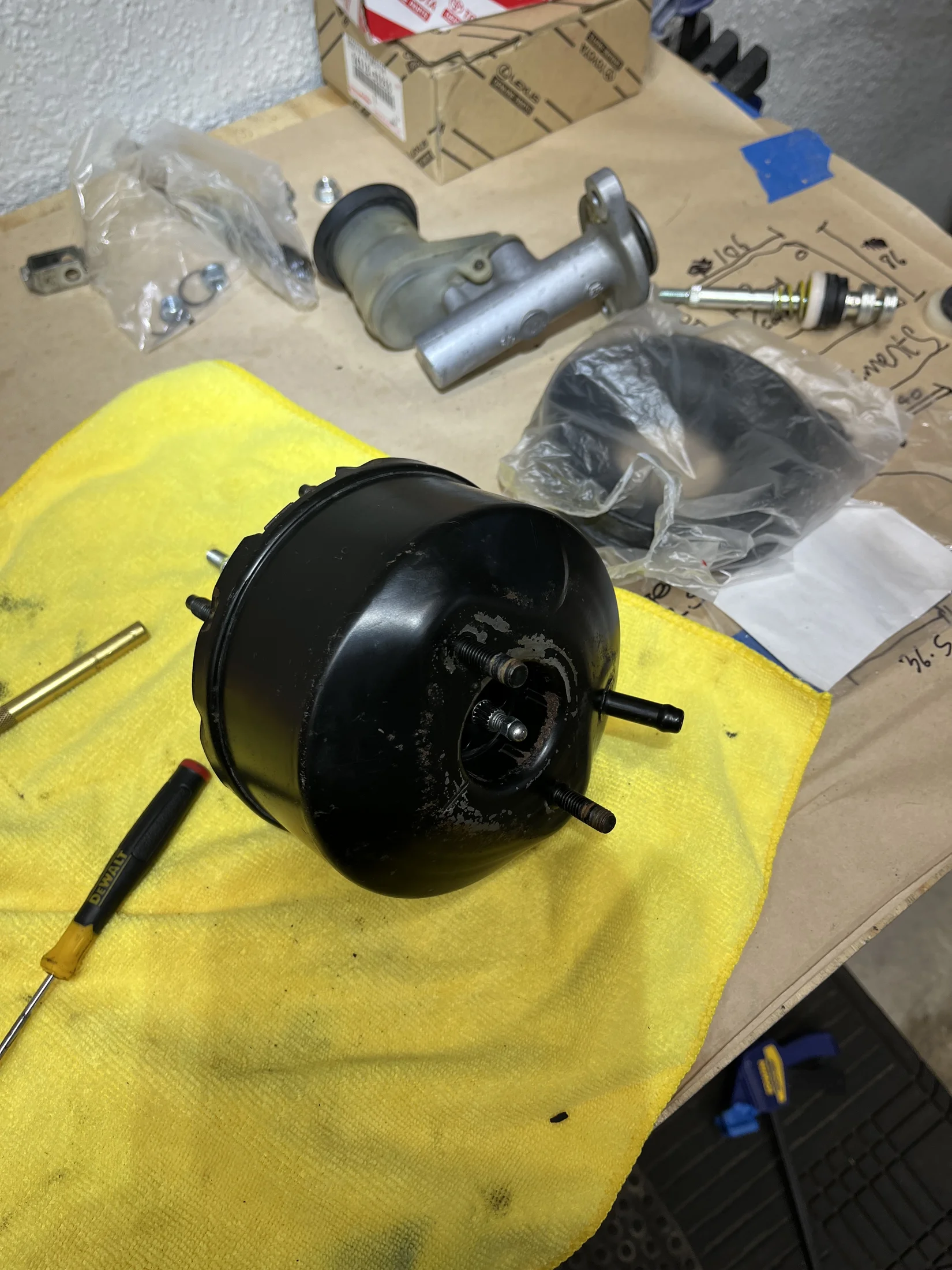

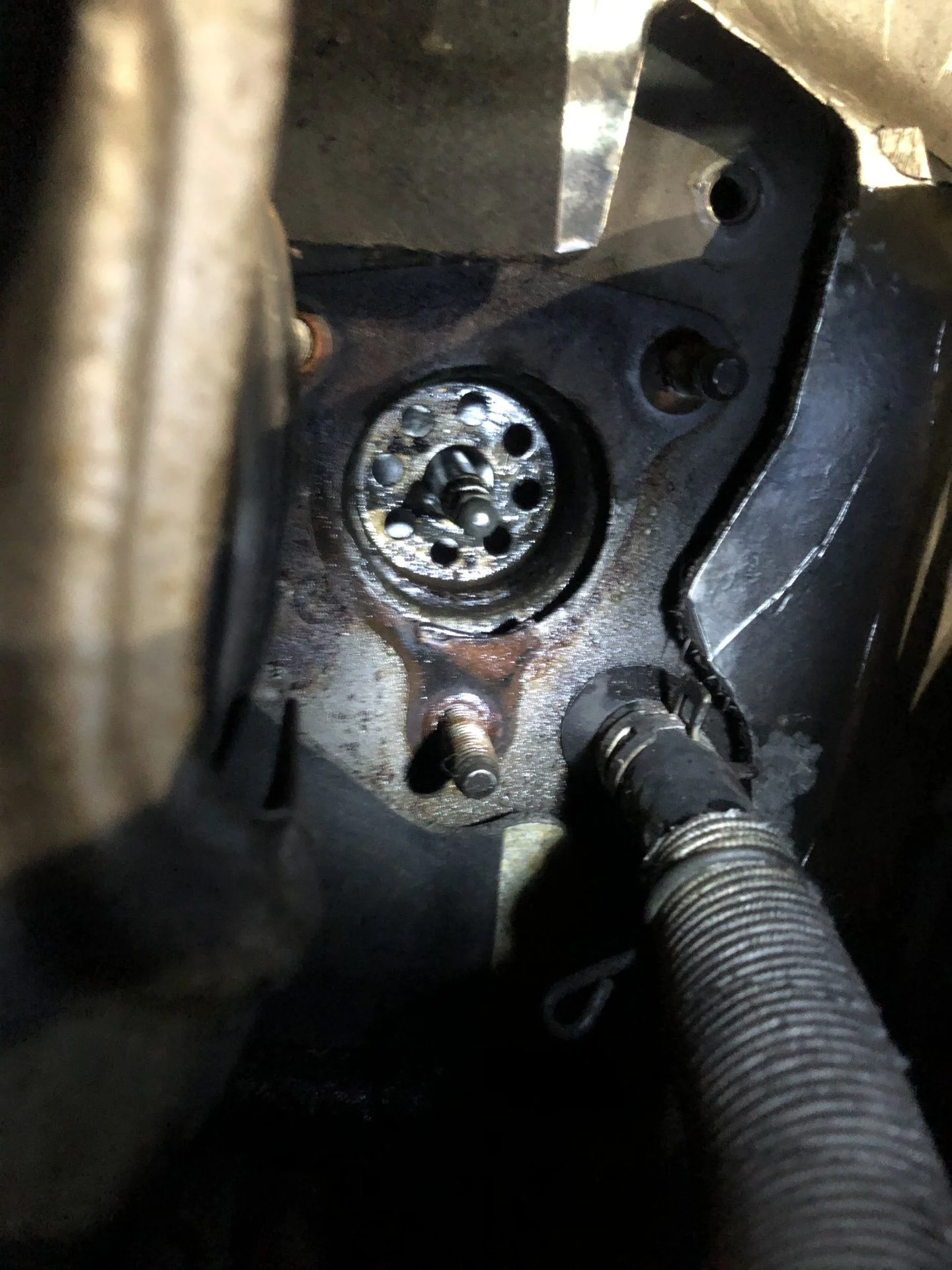

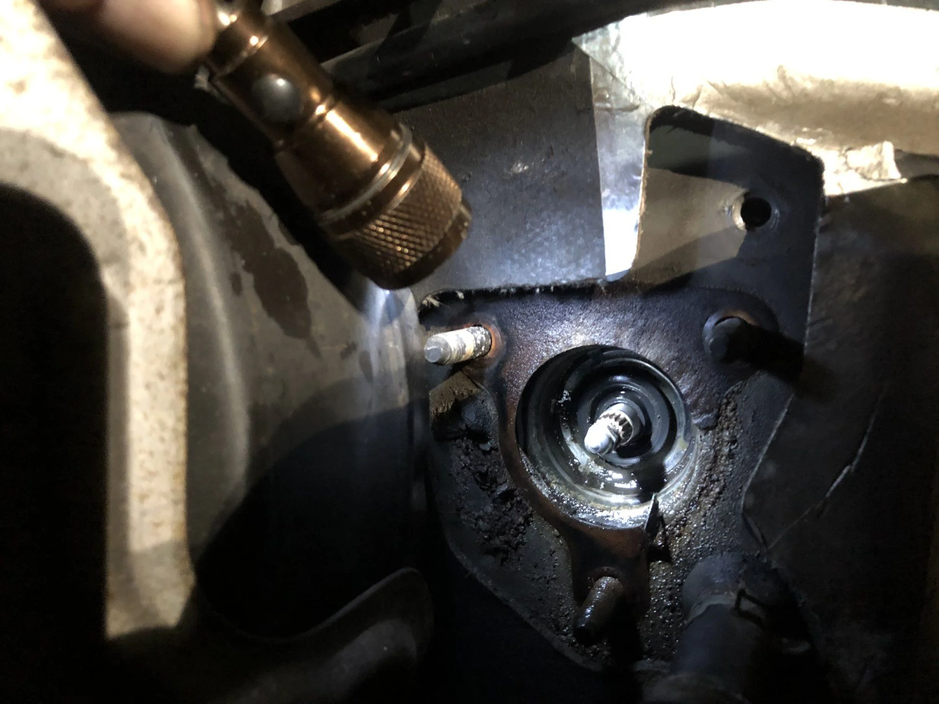

The removal of the clutch master is super simple and not really worth getting into too deep. Remove the heat shield with a 12mm, a 10mm wrench removes the line, a 12mm ratchet with an extension takes care of the two of the three nuts holding the master on, a box end gets the bolt that's behind the brake booster, don't lose the nut, there's just enough space to get the nut off and to slide the clutch master off. It is not attached to the pedal like a normal clutch master, it just comes off. The pedal linkage attaches to the booster, which pushes this little nub into the plunger which simply receives it. This is what you'll see, notice the pile of gunk around the edges of the seal...

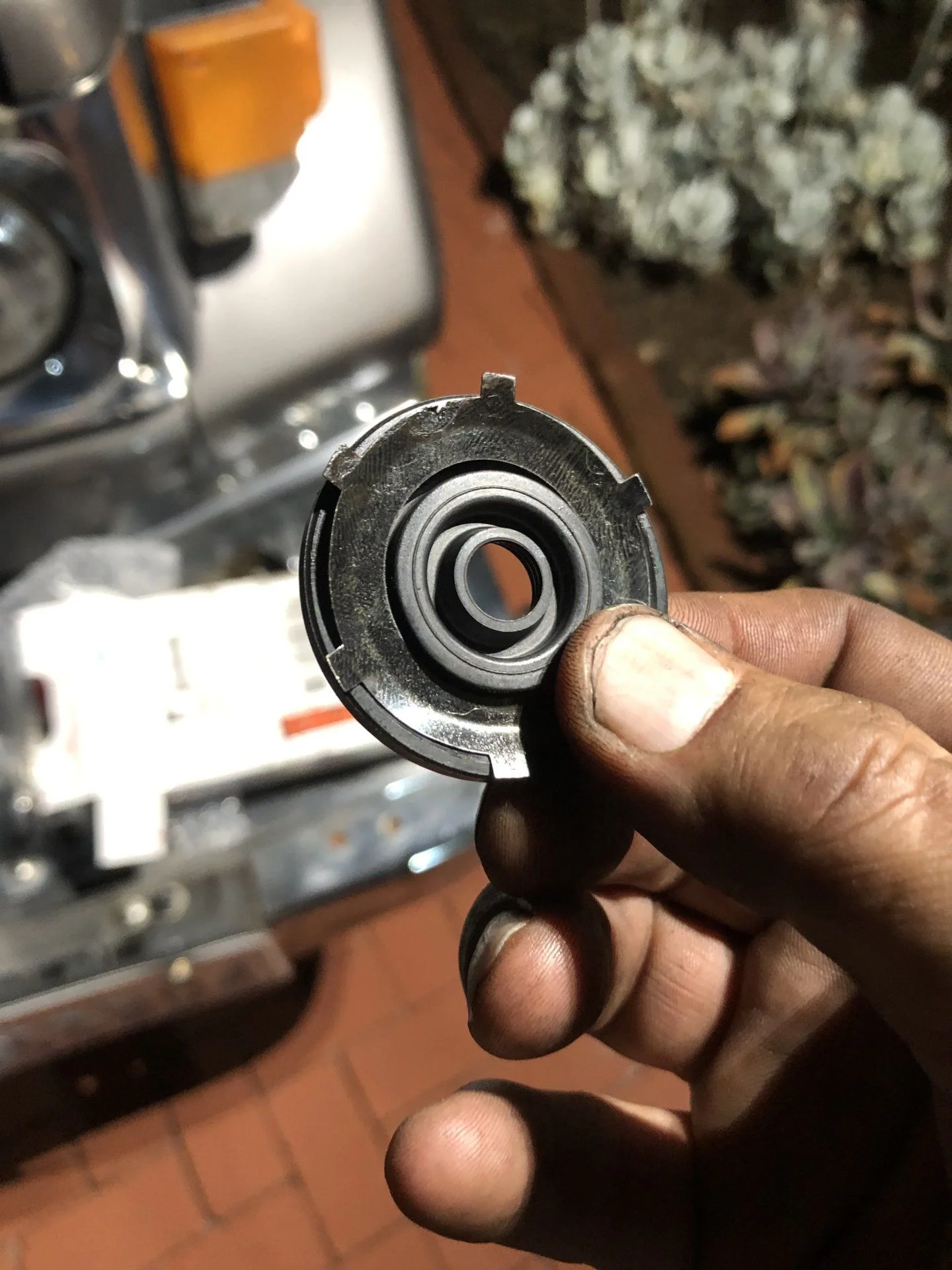

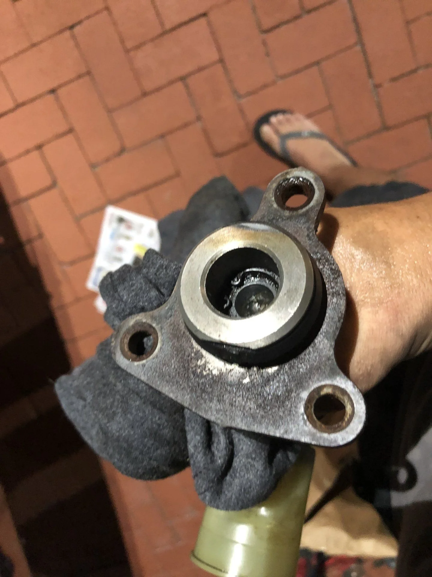

There's a little spring retainer thingy with tabs that keeps a seal anchored back there. During the day the shutoff was working properly after not driving the truck all weekend. At the time the seal was holding a vacuum and even hours after driving there was still pressure in the booster, which hissed when I poked and pried on it with a screw driver. Here's a picture of the retainer and how it sits against the seal, the master is presses onto the retainer.
To remove the retainer, use a flat head to carefully pry the tabs back a little. There is no groove, just the friction of the tabs against the little housing, then work the retainer out without destroying it, then work the seal out using a screwdriver around the edges.

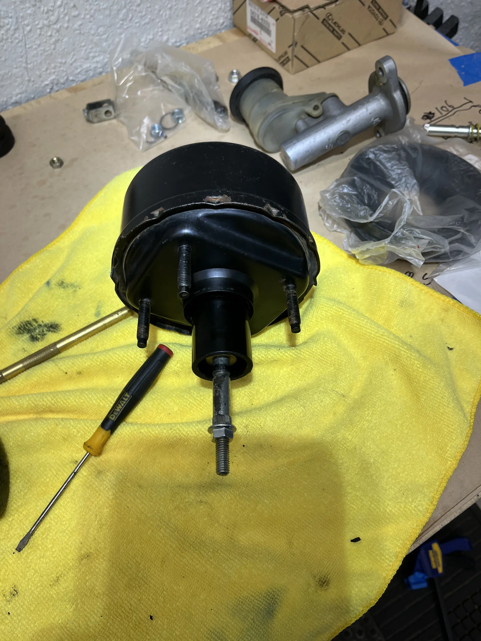

My booster was leaking because all of the crap that had been blown in there from the leaking master was interfering with the seal. This was actually a pleasant surprise. There was years worth of junk piled up in there. It was indeed contaminating the booster, which is where the seepage was coming through on the other side. This has since stopped, so I know the WD40 seeming to create a seal was happenstance. Sorry the picture kinda sucks but you get the idea...
I am a little worried the booster diaphram was compromised by being hosed down by brake fluid, but it seems to have dried out and works just fine. I cleaned housing out really well with a rag. The replacement just gets worked back in. I flattened the retainer with a rubber mallet against the garage floor very gently before reinserting it. You just pop it in there against the seal.

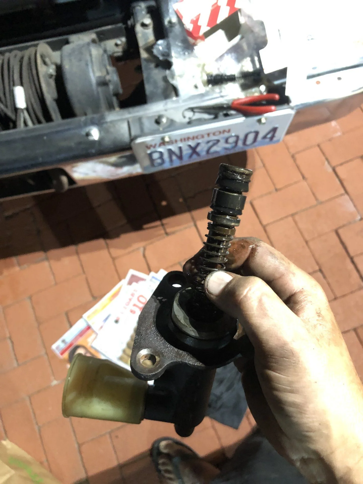

The master rebuild is really simple. You remove the c clip and in mine...... nothing happened.
The plunger wouldn't come out. I looked at the replacement plunger and there was no reason it was being held up as far as I knew. Out of frustration I started popping the plunger in and out with my thumb until it suddenly shot out and hit me in the chest like a chestburster from Alien, praying me in the face with a fine mist of old brake fluid. Problem solved.
There was a ring of hardened gunk from years of grime running through the clutch. I thought it was rust, but after carefully scratching it with a screwdriver I realized it was just gunk and I carefully widdled it away, being careful not to scratch the bore. The master was also full of crap. I used a t shirt on the end of a flat head to clean everything out. Ended up with a good looking bore, so I knew I was in business.
I stuck the new plunger in, reinstalled the c- clip, and bolted the master back up, reinstalled the line and heat shield and bled it. No issues, so far, everything is staying squeaky clean and works like a charm...
