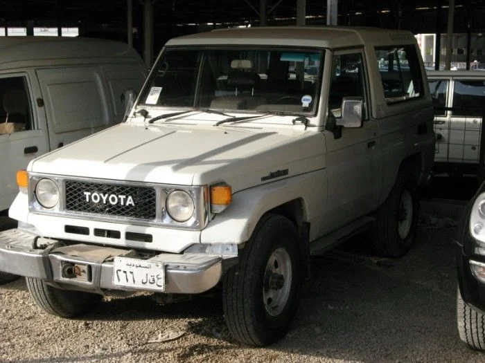

im looking at buying a 1989 bj74. havent driven it yet, the batteries were dead when i went to see it. its got the 13-BT turbo diesel motor, seems loaded(ac, ps, pw, automatic), and it has the factory winch to boot! the overall condition seems fair to good. looks like a great project with huge potential...
is there any possible issues with these(other than the 24 volt) trucks that i should be aware of?
how do i know if it has locker(s)?
hows the mpg compared to gas?
this thing has been sitting on a lot here for 6 months, btw. here in saudi no one wants a diesel..gas is is way to cheap here.
anything to watch for when i do get a closer look and take it for a drive?
any advice greatly appreciated!

Droool, left hand drive to boooot.
Levers for the cables down by your left foot and lights on the dash indicating front and rear lockers.
Fuel economy varies, around 29MPH, I think.
What does something like that go for in your country??

It looks to me as if that particular BJ74 started life as a Right Hand drive, as the wipers are reversed. You might want to look for signs of a conversion and problems that might bring.
Great vehicles: mine has been terrific, but that does not mean maintenance free. Look after it and it will treat you well.
Well spotted,the old hands on this board should have seen that:D The conversion on these is not as simple as many think.
The point of assembly where left and right hand split is a long way back and the cruiser is built around the steering.
I know someone who converted 5 and he said the last one was hard as the 1st one:D

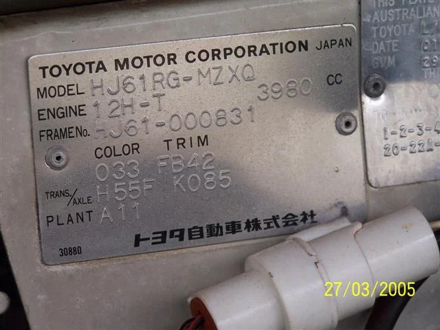

I think maybe the seller got some of the digits around the wrong way . It should read BJ74RV-PNX.
But it does sound RHD
Here is how a RHD aussie spec 61 series plate looks,note is has an extra letter to signify high roof
