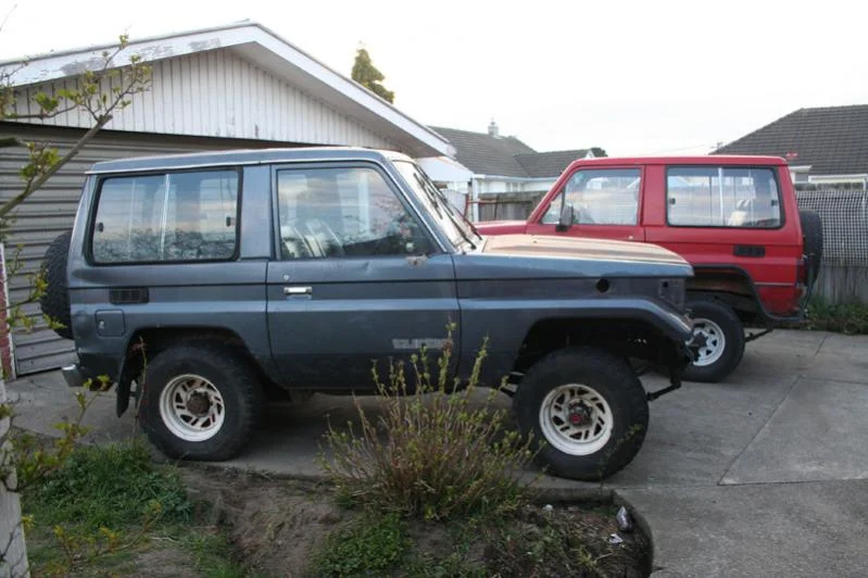

My BJ70 rebuild
Here in New Zealand we're lucky enough to have quite a few 70 series Landcruisers . I've got the best part of 3 SWB 70's , 2 running and 1 for parts
It all started a few months ago , finding 2 BJ70 wrecks. I picked them up cheap and started the rebuild soon after . The first one a 1986 job had been rolled and the other a 1985 with alot of rust
Heres the progress so far
Rolled 1986 Cruiser
NZ new 1985 Cruiser

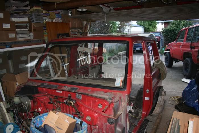

Managed to find a new body in fairly good nick
Meet the family....
Stripped it back
And removed body
New body on
Heres how its looking at the moment
Heres what Im aiming for with the build
Thats a while off yet as I'm gonna be using it as a DD for a while but thats where it'l end up

Nothing much to report from the build
Been busy last few nights stripping the interior out of the 85' to put into the rebuild
Soon she'll be running :D
