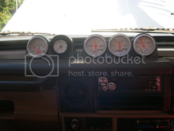

Anyone have a green "condom" for my Isspro boost gauge light? I LIKE dim cluster lights. I find them much less blinding in the dark.
It may pay to fit a dimmer or connect it to the existing dimmer. My gauges were far too bright so I fitted the green condoms and they are still too bright then doubled up on the condoms. LOL.:o On the 75 the rear vision mirror picks the reflection up off the back window of the cab making it worse.:mad: The condoms are available here in green or blue I would expect you guys would have a better range available. A mate sent me green bulbs [no condoms] for the dash lights from the U.S.A. as I could not source them here in the north.

I just bought a 12V equivalent to those peanut light bulbs at Toyota, slipped off the green condom and fitted them on to the 24V bulb that I use in my ISSPRO gauges.

It's already done that way but I still find the boost gauge too bright.

My dimmer [stock Toyota] can turn them down until they are not showing.If its not faulty it may be connected wrong.:cheers:
The stock dimmer works great but because the boost gauge is the ONLY gauge without the green "condom" it's excessively bright.
