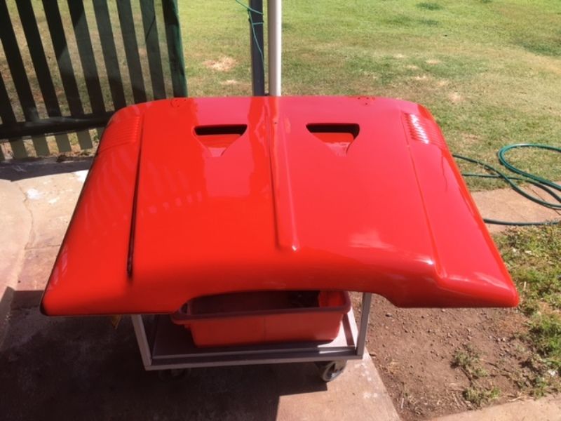

Well time to start a file to share for my BJ42 LX rebuild. I have started to pull a few of the panels off already and preparing them for painting. Roof has come off and has been sanded down. Just ordered a new headliner, rain gutter and windshield cap from CCOT so that the roof can be completed.

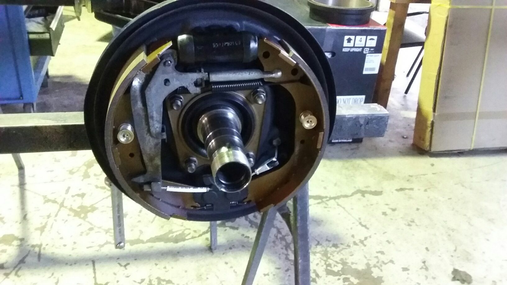

OK been a while since I was here so here is the latest update. Diff have been taken down to Terrain Tamer in Cairns and have had a full rebuild from end to end and inside out. They have been fitted with E-Lockers front and rear. Terrain Tamer suspension kit has been ordered and will pick up the whole lot soon. Tub and chassis have been sandblasted and chassis has been coated with a coat of KBS. I am currently working away for a few months so wont be able to do much of the work myself which is why I am going to sent all the panels out for someone else to respray that way when I get back from out bush I wont be a month or so behind to get the paint work done. I am hoping that Ruby will be back on the road by xmas.
Been a while since I posted on here so here is the latest update. Diff have been fully rebuilt by Terrain Tamer in Cairns and fitted with front and rear E-Lockers. Terrain Tamer suspension kit has been collected and I have put the springs in place just so they wouldn't be lying around. The gearbox and transfer case has been dropped off to Terrain Tamer for a rebuild and the 13B-T should be delivered in the next week or so.
Rims have been painted and diffs have come back. I now have a rolling chassis.

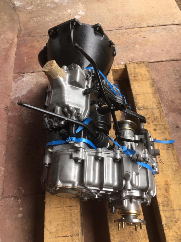

Got the gearbox and steering back from Terrain Tamer in Cairns on Saturday. All fitted up and ready for the engine.
Aren’t you lucky to have one of those rare 40 series 5 speed top loaders. I was very lucky and found one within a week of searching from a man in Adelaide.
