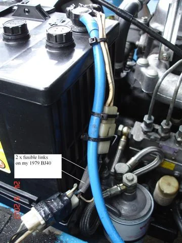

I've got an Australian spec BJ40 which is has a native 12V electrical system rather than the 24V system we see in other countries. I've got no headlights. They went out mysteriously the other day and now the headlights, highbeam and spotlights aren't working.
The blinkers, reverse lights, parking lights, brake lights, tail lights and the instrument lights (apart from the blue high beam indicator) are all working.
Fuses are all good.
Relays are all good.
Bulbs appear all good.
The 40 has hacked wiring. At some stage it had an alarm box in it as well as the old style relays replaced with modern ones. The wiring is not standard but it looks to be a nice, clean job probably done by an auto electrician by the PO.
I don't know if it's related but my 12V cigarette lighter plug is malfunctioning as well. When I was out camping last week I plugged in my 12V laptop power supply to check my email and the 15A fuse in the power supply blew. I replaced it and the same thing - it blew as soon as it was plugged in. Tried 20A and 25A fuses and the same thing happened. Any ideas on what could have caused these problems.
