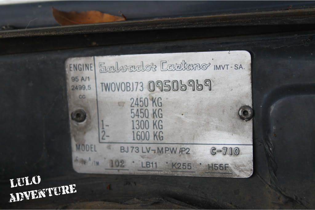

BJ-73 "Made in Portugal" By: Salvador Caetano
Many BJ-73 sold in Portugal & Spain were built by Salvador Caetano in Portugal.
These BJ-73 equipped 4-cylinder engine & 5-cylinder VM Motori
The supports of the bodywork on the chassis are not equal to the supports of the BJ-73 conventional, are handcrafted.
...the remainder is equal ;)

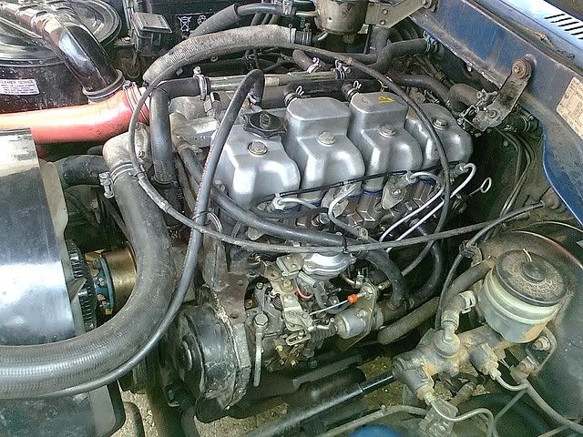

are the engines equal?
In Spain and Portugal were sold BJ-73 units with 3B engines, and BJ-73 units manufactured by Salvador Caetano with Italian engines (VM Motori) 5-cylinder and 4 cylinders (2.500 cc 115 hp)
Check this link and read the info of this engines (VM Motori):
- VM Motori S.p.A.
The reason for making this model BJ-73 in Portugal with VM engines, was the restriction of import of Japanese cars in the late 80's and early 90`s.

You would have to find out which VM diesel it is first. Maybe a HR 492? . You have more chance of getting parts in Spain and Europe than anywhere else
The four cyl is the HR 492 HI, the straight 5 is the HR 588 HT (not intetcooled).
