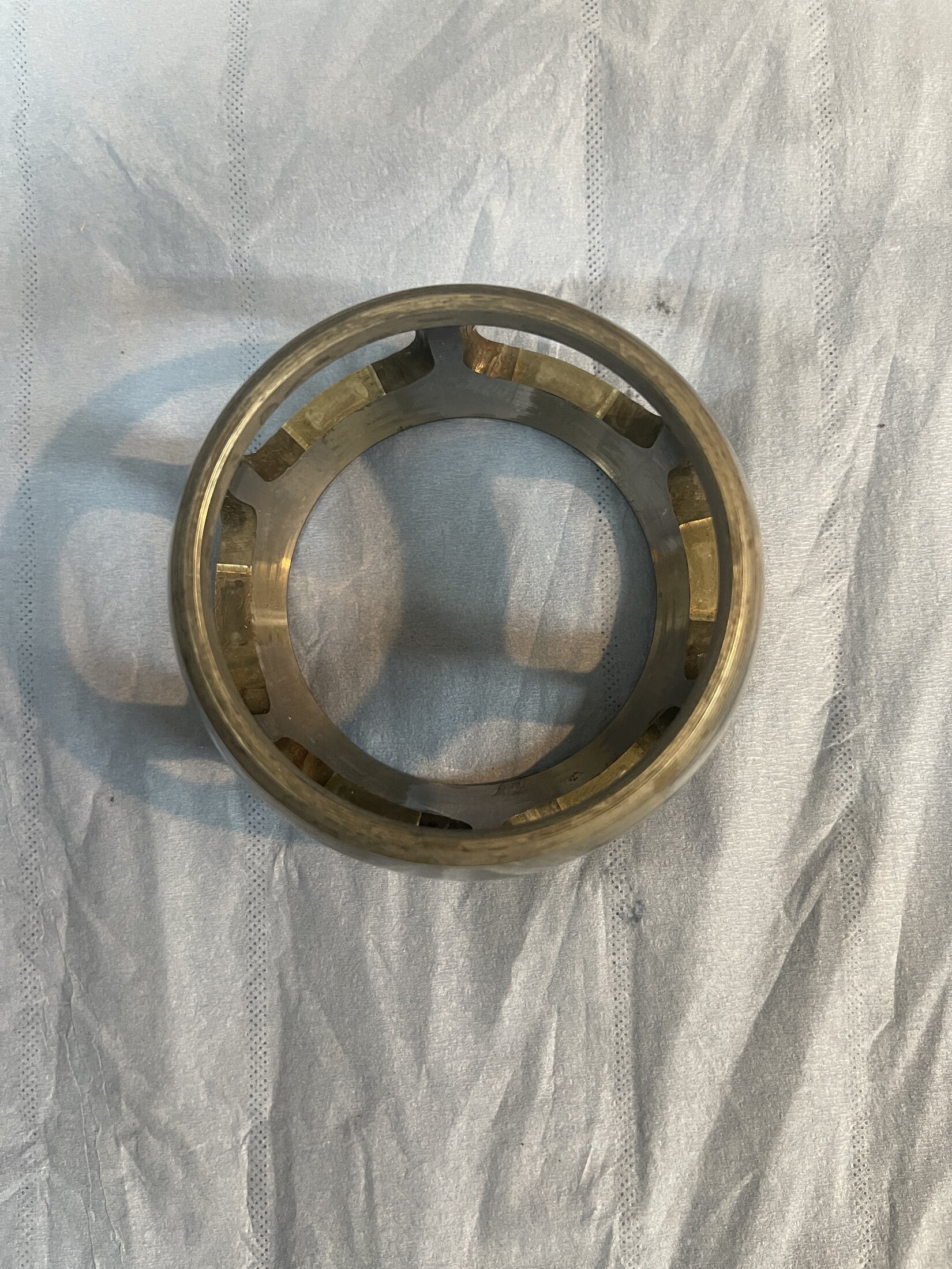

Some insight on birf assembly.
Pro tips- The cage has a flat end and a tapered end. You want the flat end to point down.
The star holes are more open on one side. That is the side you want to point up.
Press/pump grease into the center hole of the bird until you see the grease pumping out around balls
Graduate level BIRF training = thank you Dr. LCP!
