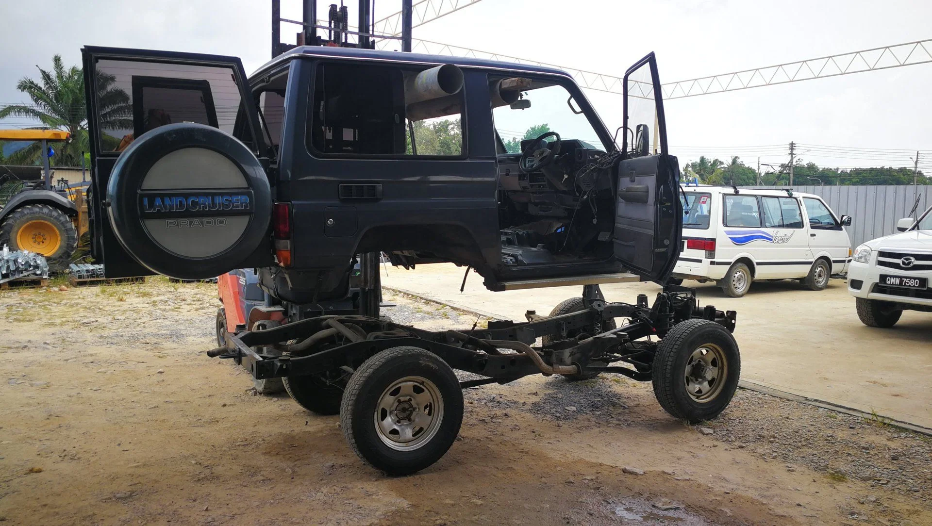

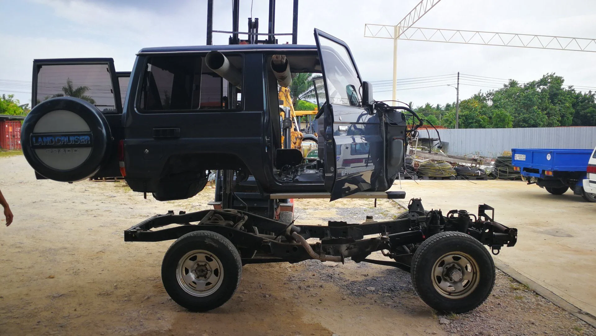

This is my LJ70 when i collected from trailer. :rofl:

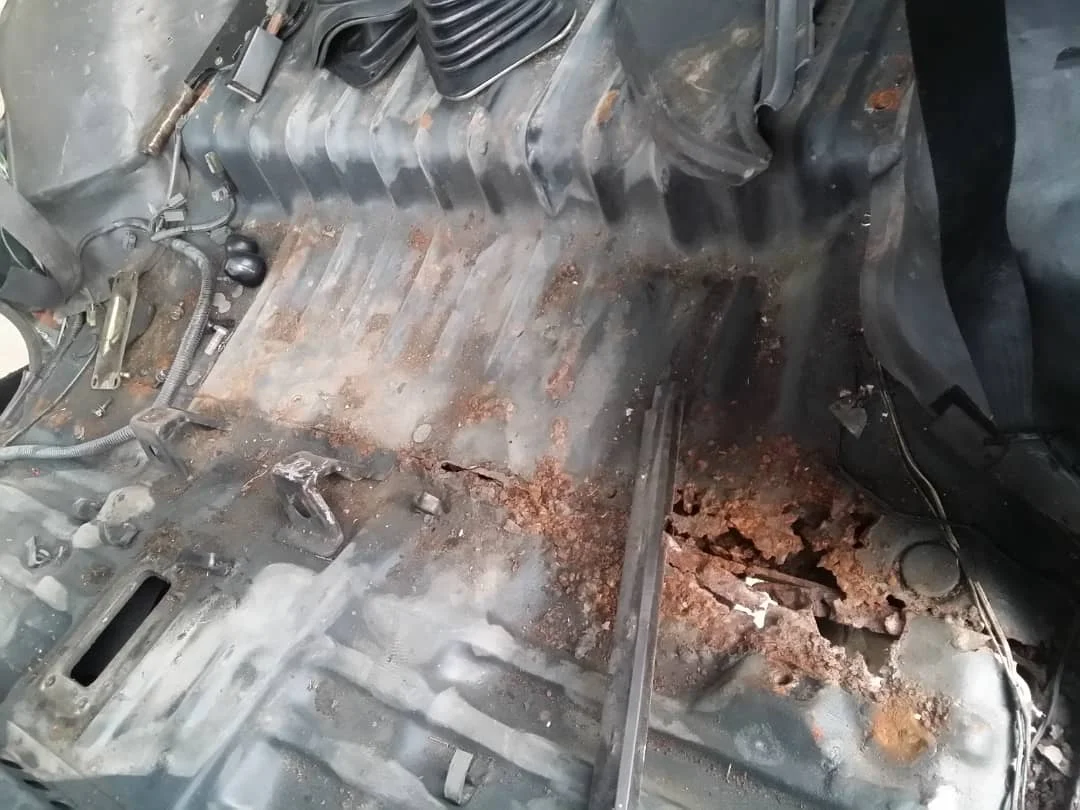

those are the part can see rusted. when i open remove the seat, this is how its look like
the rusted part is passenger side :cry:
Wow, @Rocky Chai , I would definitely take care of that rust prior to doing a lift.

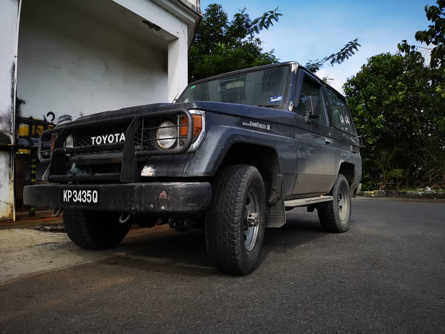

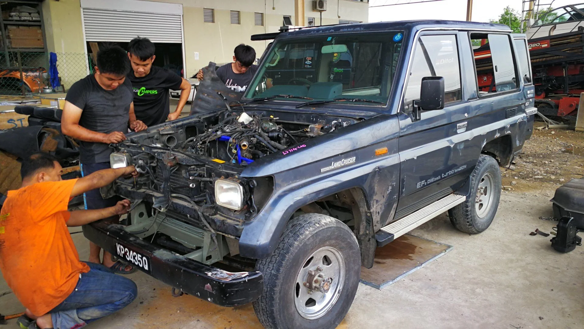

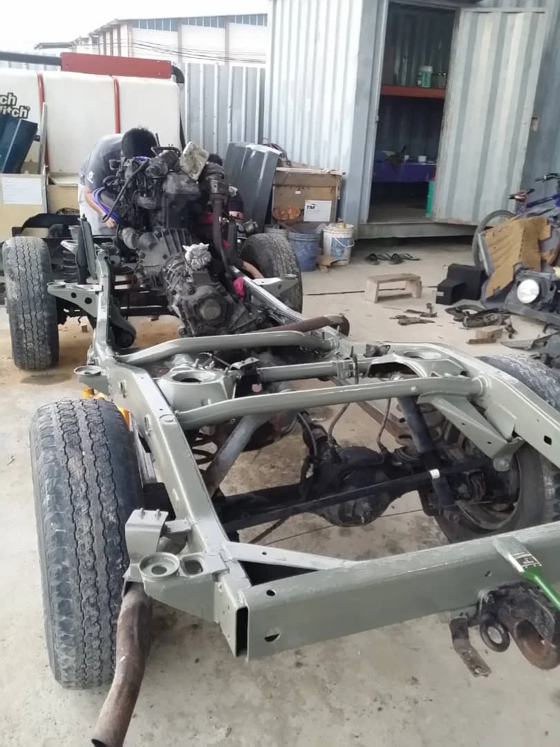

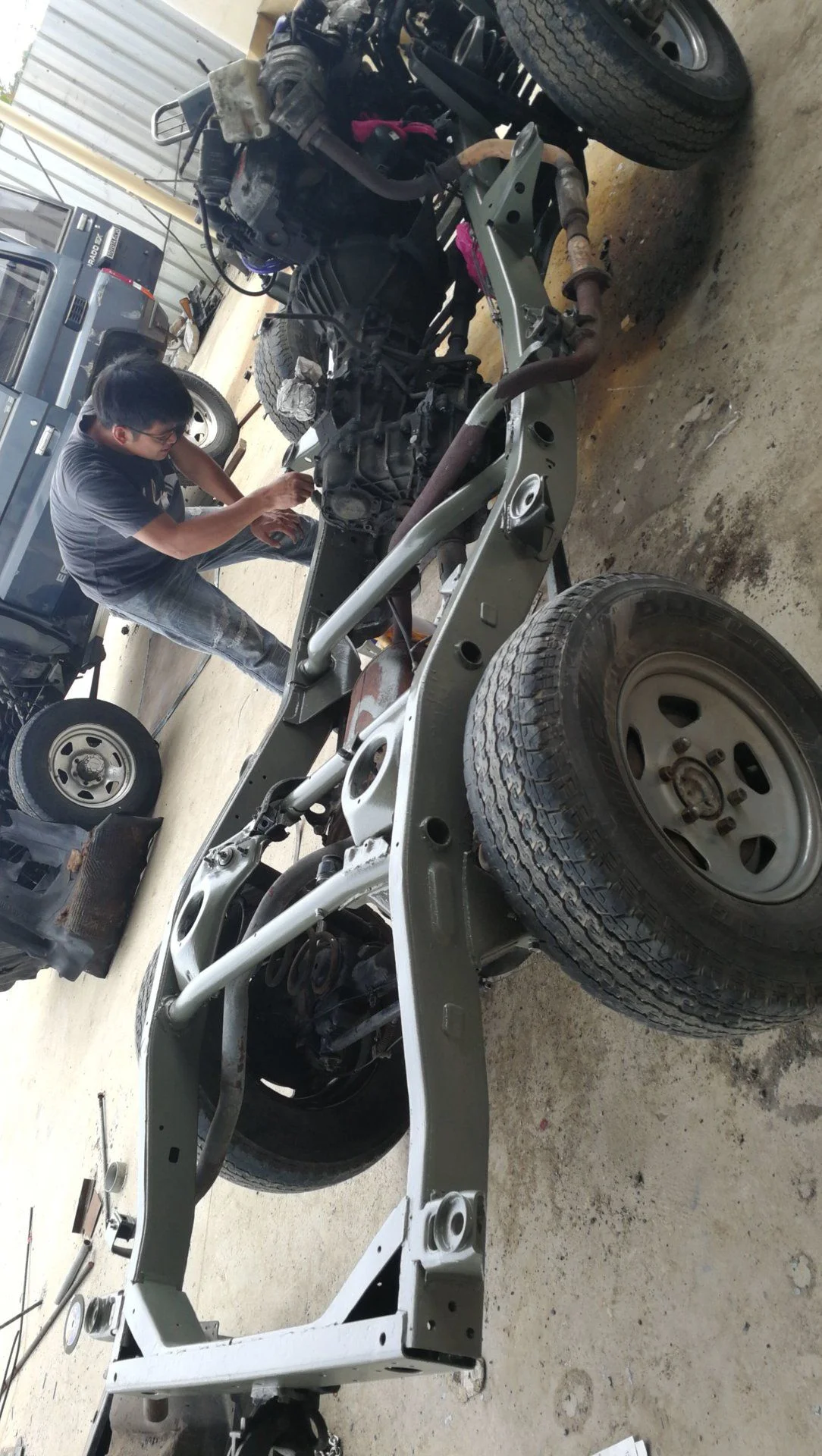

Here are some update for my 70 after refurbished new house
