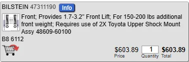

Edit: found the part number. For anyone interested part number is 47-311190 but it seems like it will be 750-800#. The seller is getting me exact numbers from Bilstein
From the seller: Fitment Note : Provides 1.7-3.2" Front LiftFor 150-200 lbs additional front weight, Requires use of 2X Toyota Upper Shock Mount Assy 48609-60100, B8 6112,

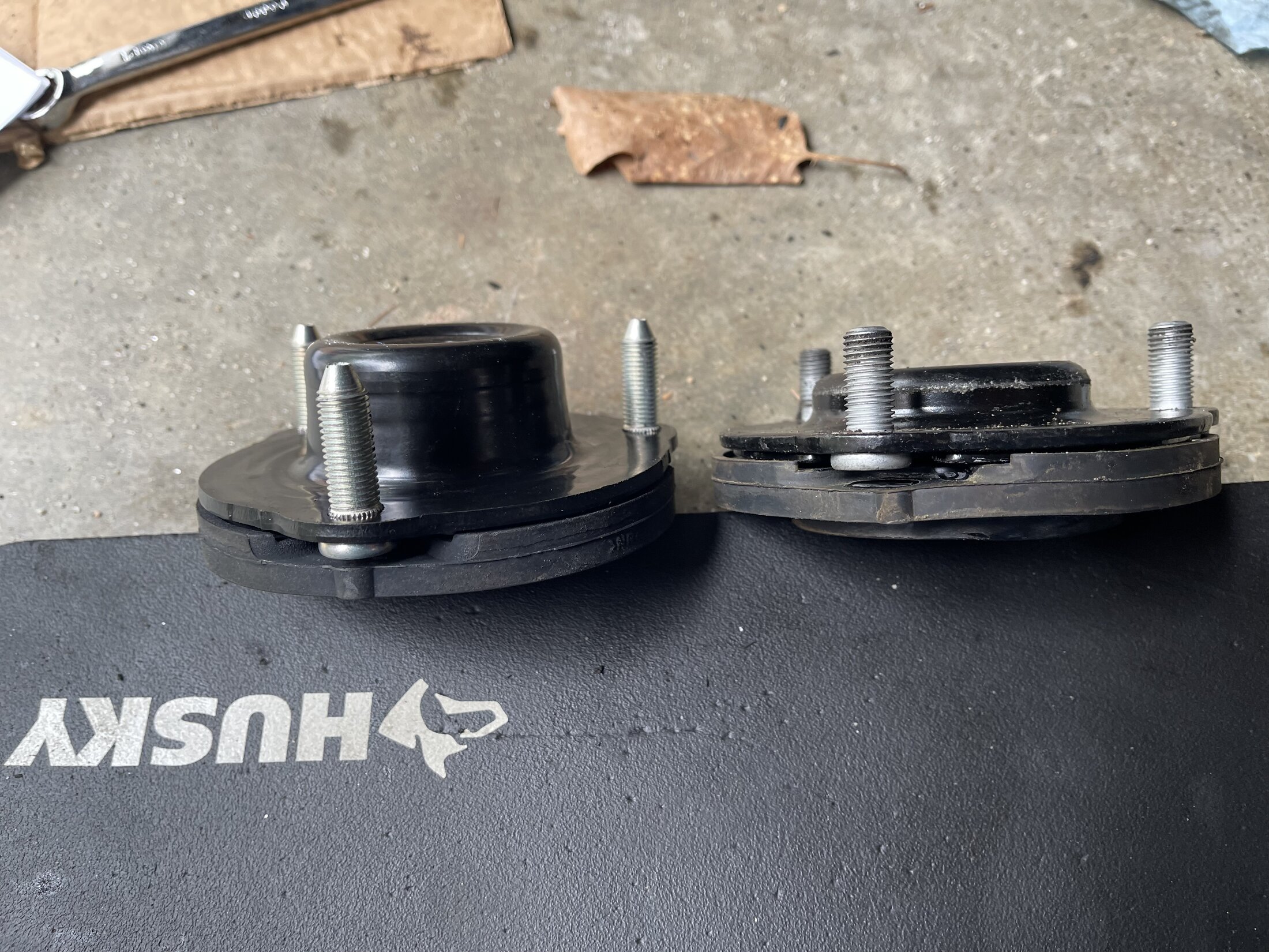

E4-FD1-Y005B46 are the 700lb springs, it’s kit 47-311190. Bilstein def doesn’t describe their kits well at all. And you’ll want those top hats they are taller than the stock 470. I just installed 6112s I’m a little bummed they are leaking at 50k I’ll have to keep my fingers crossed

$604 at RockAuto (+5% off if you have the coupon code)
