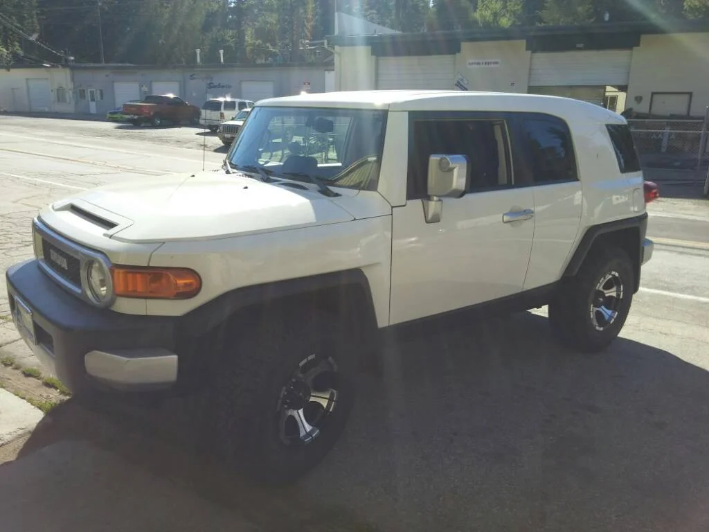

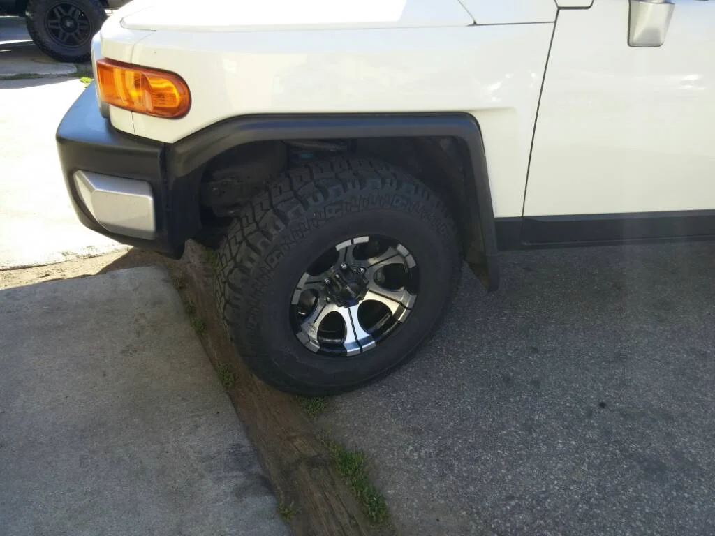

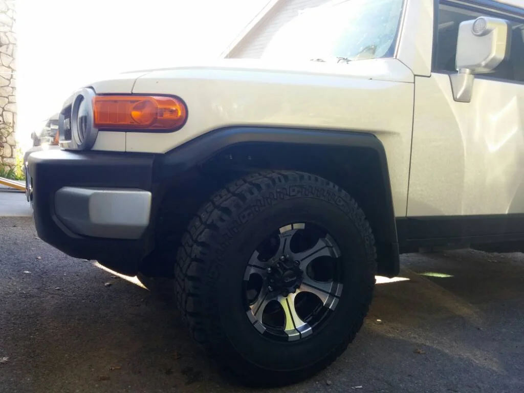

Last weekend I had 5 Cooper Discoverer S/T Maxx 255/80R17 installed on my stock FJ. No rub, no modifications, maybe a little skinny, and right at 33". The ride around town isn't noticeably noisier, but I am feeling a little vibration in the steering wheel around 60 mph. Taking it in today for an alignment, and to recheck the balance.
