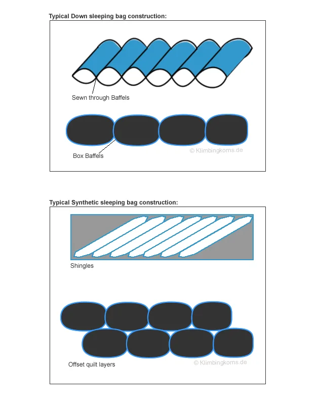

From the Mountain Warehouse website:
" There are three types for down jackets, Sewn Through, Box Baffle or Heat Seamed Baffle.
Sewn Through
This is the most common type of down jacket, most Mountain Warehouse down items are made using this method. Sewn through is just as the name suggests, chambers are created between stitches as the outer fabric is sewn through to the inner fabric lining. No extra fabric is added so the item is usually more lightweight than something using the box baffle technique.
Box Baffle
The box baffle items have small chambers of down, separated by a wall of fabric. Imagine a line of squares next to each other, touching, that is what box baffle looks like. Extra fabric is added, meaning it can be heavier than a jacket using the sewn through method, and because extra fabric is used and the technique is more complex, box baffle items are often more expensive.
Heat Seamed
Heat seamed baffle (sometimes called welded or bonded) is when the outer fabric is bonded together with the inner fabric using heat. Like the sewn through technique, chambers are created between the bonded baffle. However, as there is no stitching, warmth can’t escape from the seams. This can also make this type of down jacket more wind and water resistant."
However, sewn through can be colder because the seams lack insulation.
