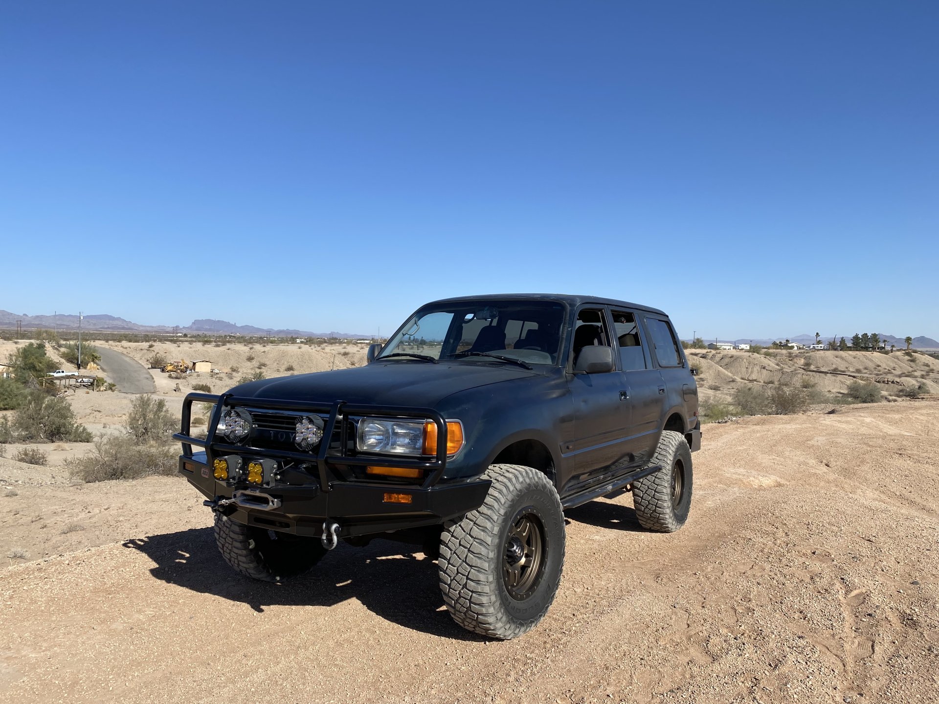

Pic of the 80 when I first got it
First day I got it I drove it out to Parker AZ for Thanksgiving to hangout with family. Seems like a dumb idea now that I think of it but it made it there and back without any issues.

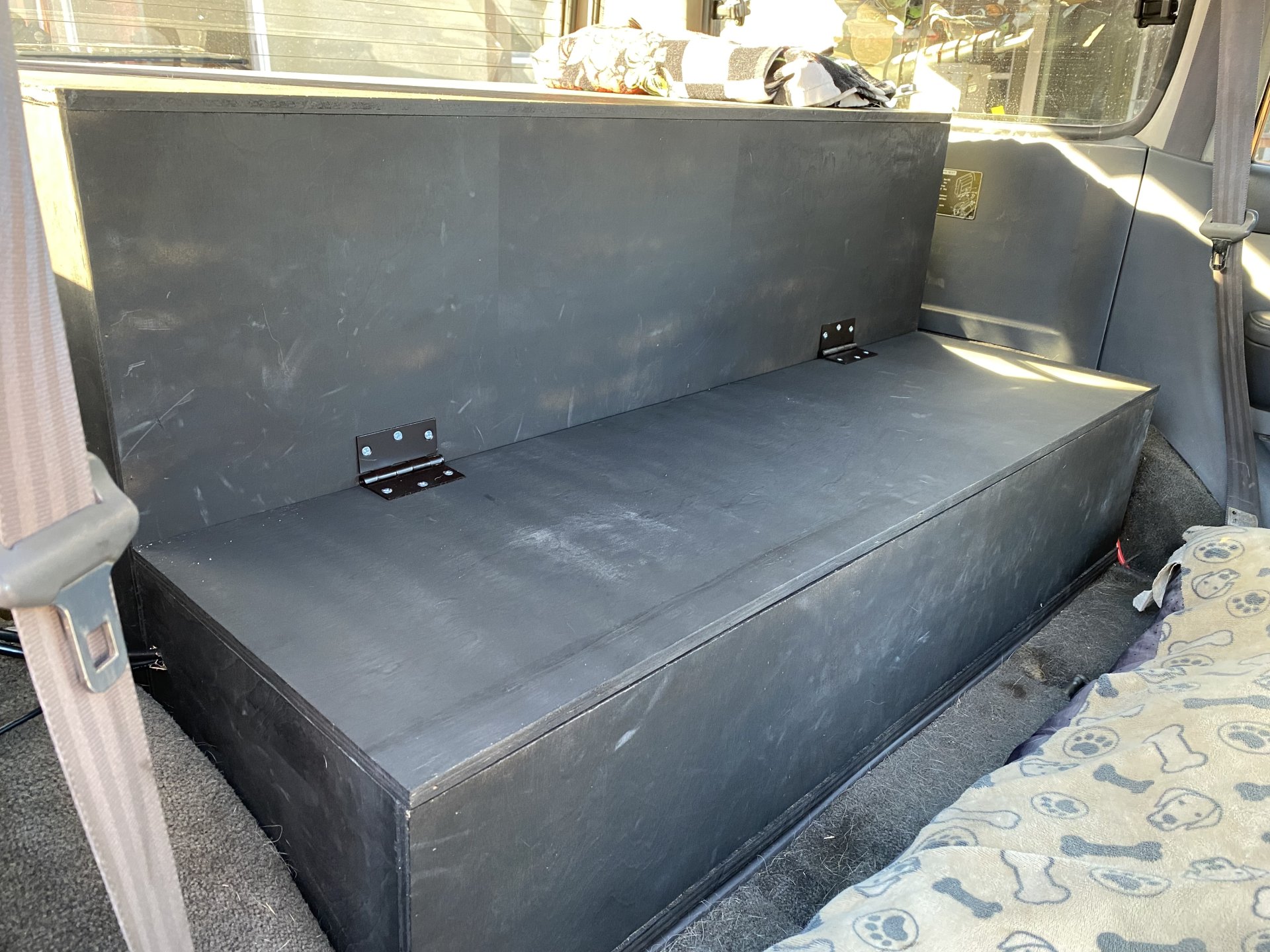

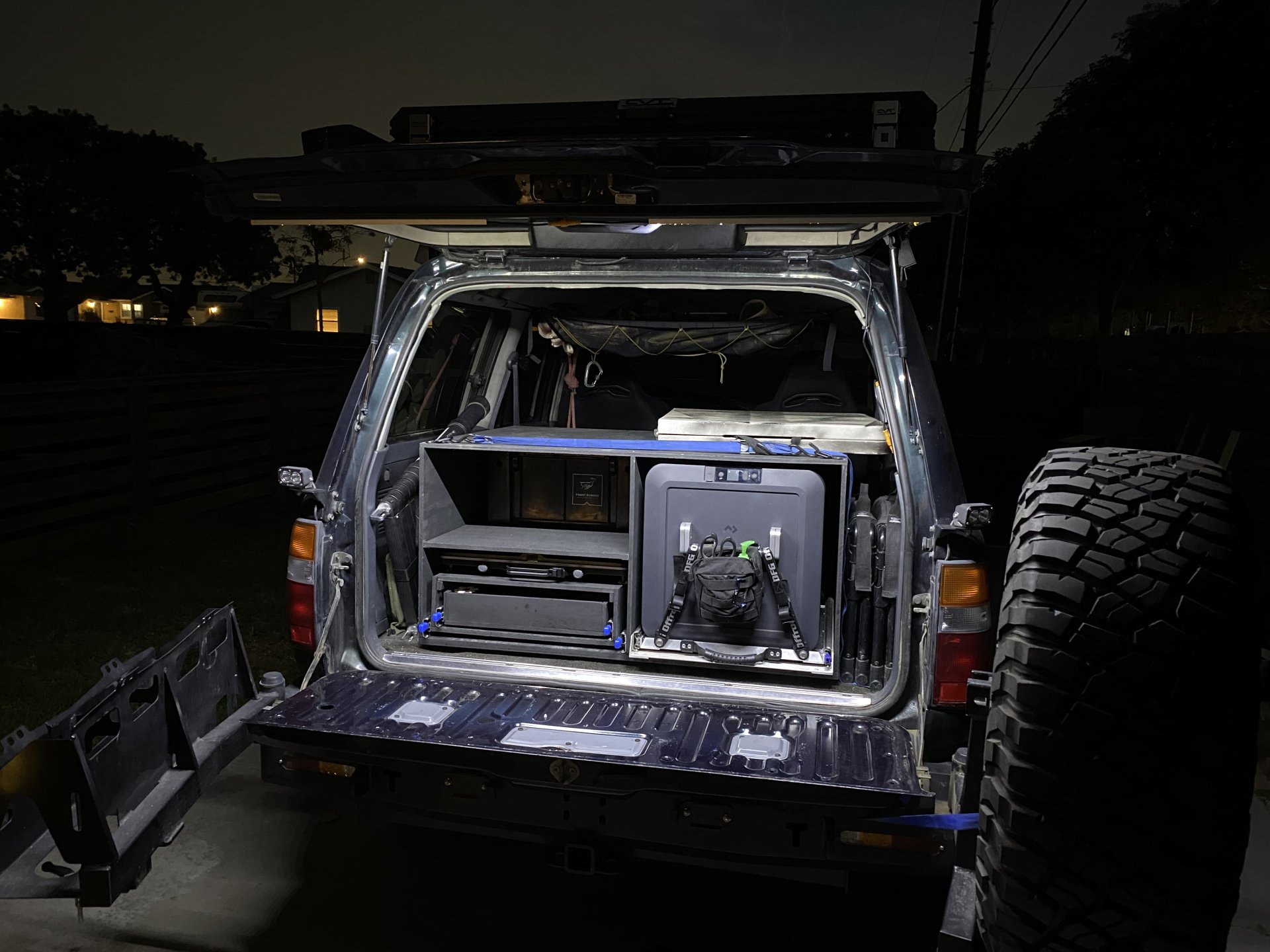

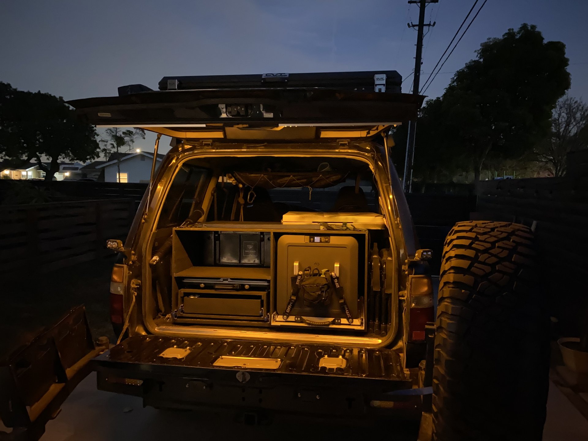

I also started working on the rear cargo/storage system. I wanted one side for the fridge and the other side for the kitchen and storage. The mid area I want to do a dual battery system with space for a compressor or maybe put the compressor under the hood, not sure yet. Might also try to incorporate a water storage system but we will see. Waiting on the slides so I can start making drawers
Finished building the drawers the other day
I have all my kitchen stuff + stove on the bottom drawer and the top shelf can fit two front runner packs. I can also fit two front runner chairs on the side next to the fridge and the ladder to the tent on the other side. Next up will be sourcing a lithium battery for the dual battery set up and installing that in the mid cargo area so I can run lights to the hatch and other accessories

Finished cutting out a cover for the middle cargo area of the storage system

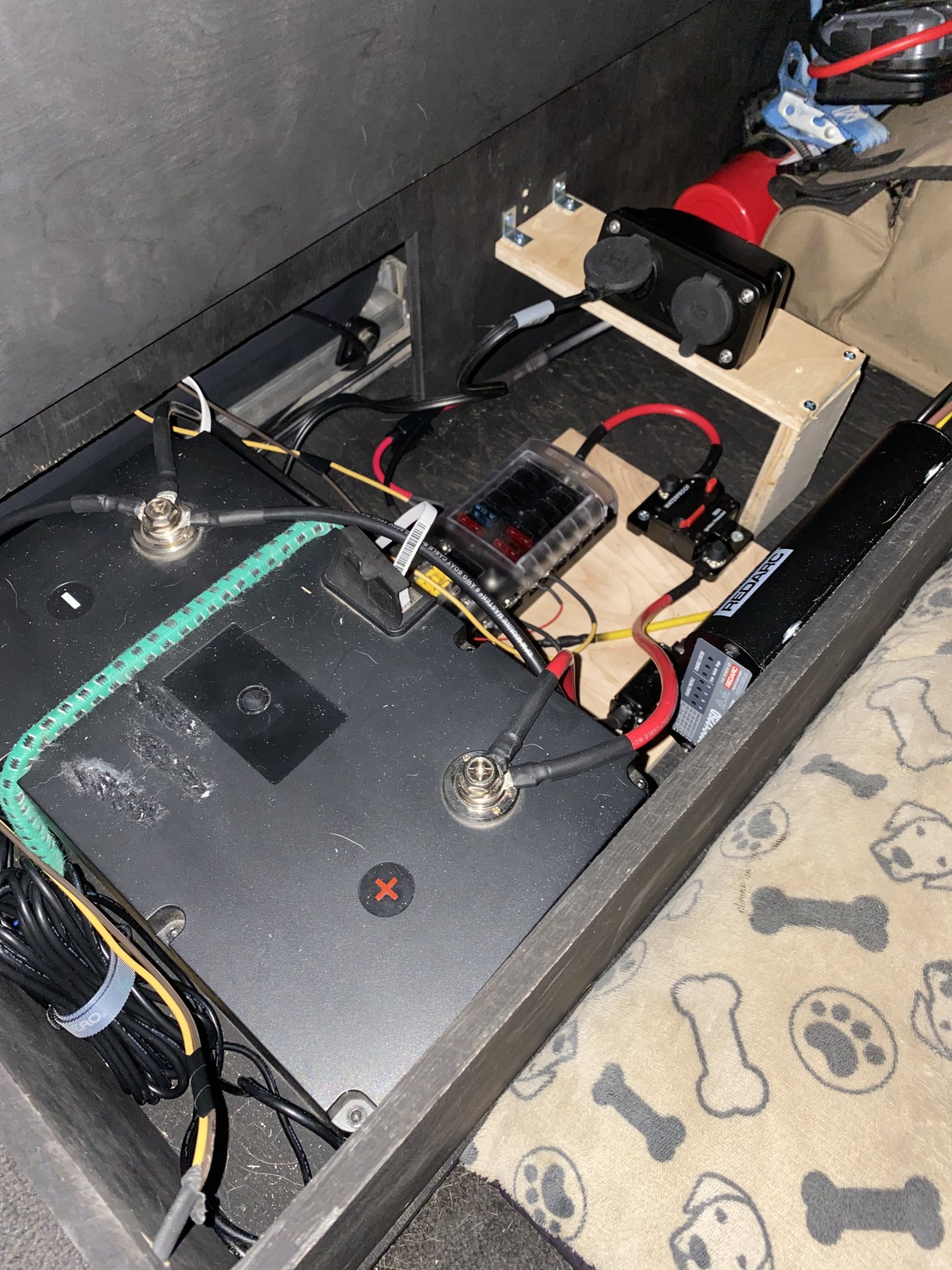

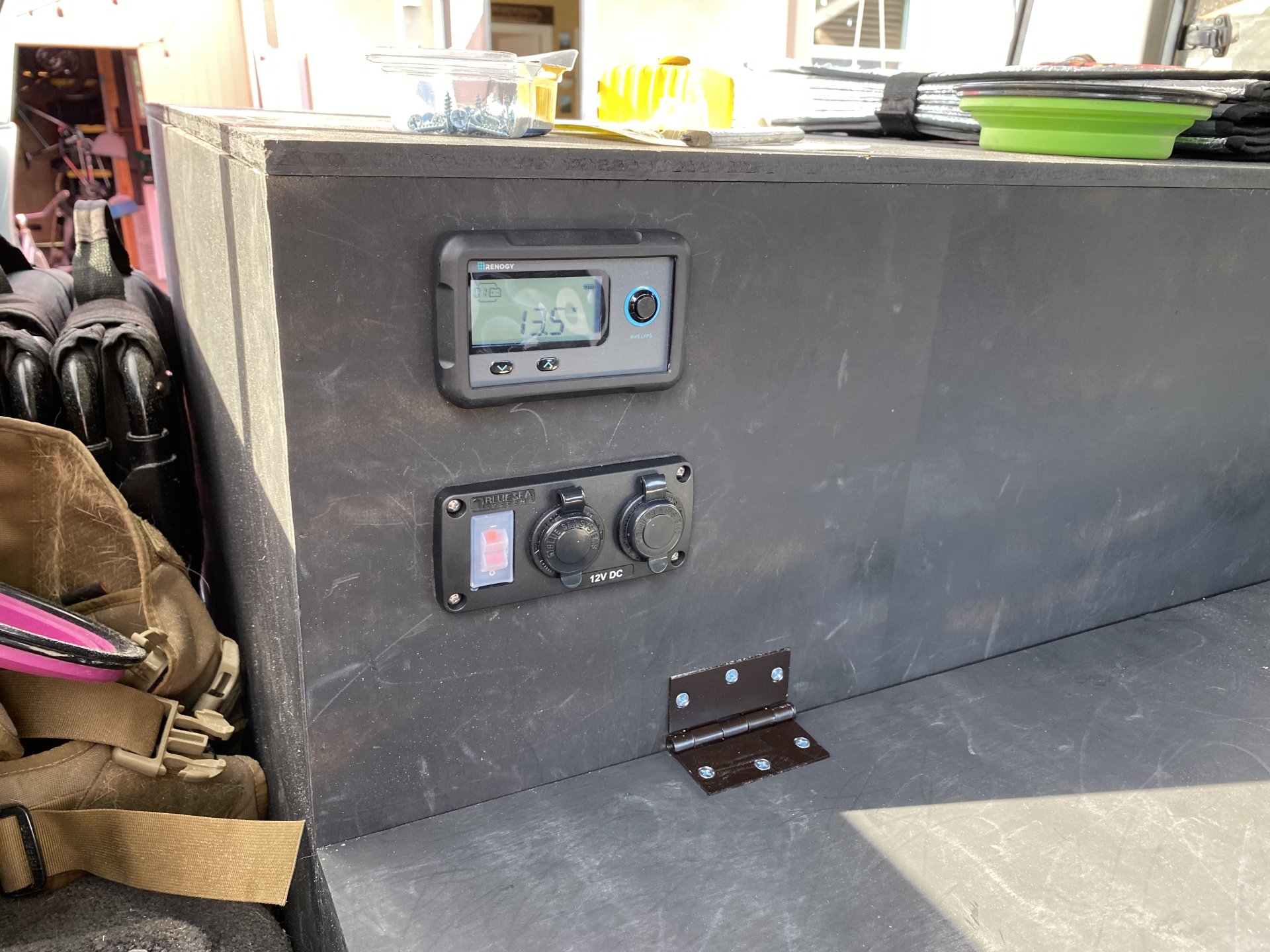

installed renogy 100ah lithium + Redarc bcdc 1225 +blue sea fuse panel
Blue sea inputs (DC and USB)

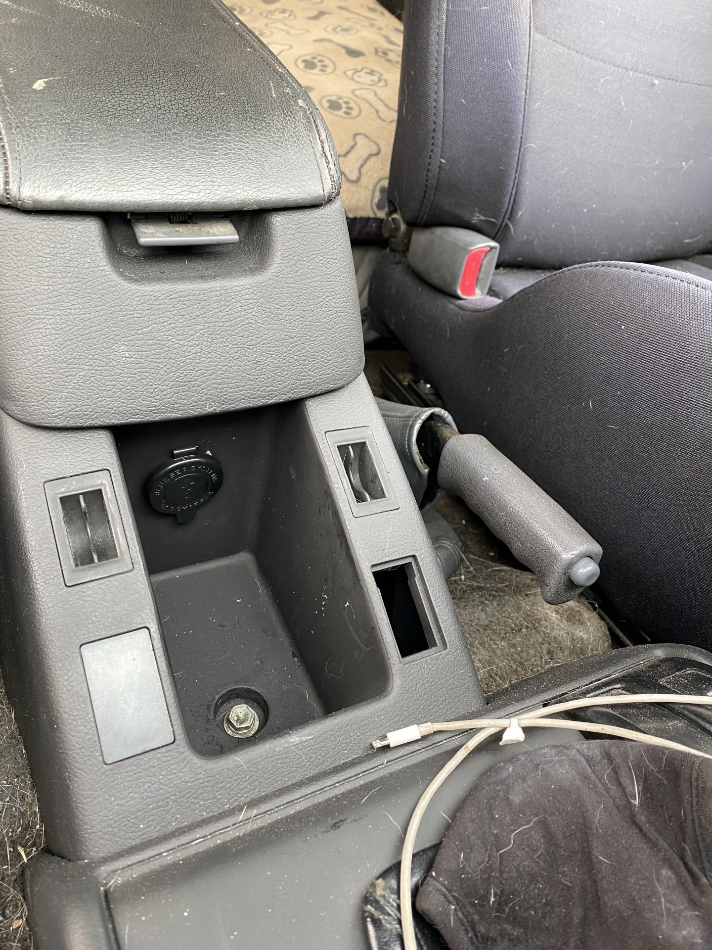

Installed a USB input in the center console
Hardkorr lighting LED strips amber/white
Dual battery area looks a little messy but I figured it would be covered up with the lid and its still pretty easy to visually inspect if I have to do any trouble shooting on the electrical inputs.
Happy with how the dual battery set up came out and now I have hot plugs that run off the dual battery that I can use while camping. I also have a 100W solar panel but its only charging at 2-3 amps peak sun light. Trying to figure out if that's normal, might have to upgrade to a bigger solar panel in the future but the car charges up the lithium battery pretty fast so I am not too worried about the battery's State of Charge going down too low when the car is off and the fridge is running.
