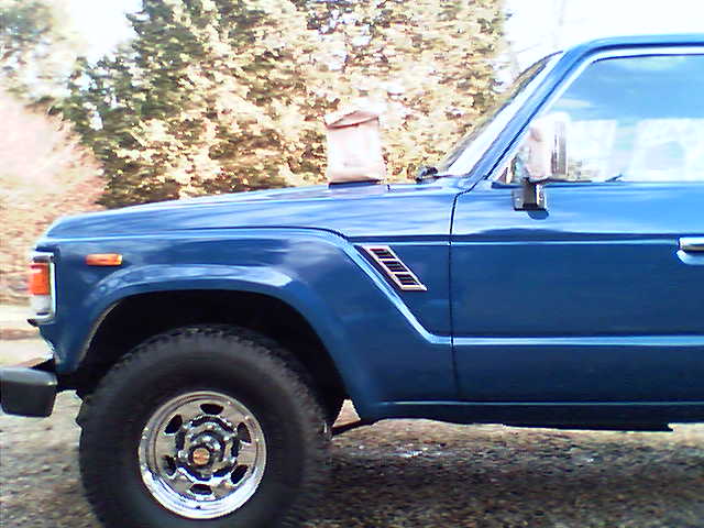

Ordered my second set of four 33x10.50 BFG ATs yesterday at Discount Tire and they are backordered for a month or two. Sales guy speculated that BFG was going to delete that size before long - BFG has already deleted the 33x9.50 MT as I recall. I've always thought the 33x10.50 was the perfect size for the 60/62 set for your typical daily driving and mild off roading. Lighter than a 12.50 or 285/75/16 so it doesn't soak up any more HP than neccesary and fits the wheel well without having to take a BFH to the wheel well. For offroading of any sort, though, I find the Swamper LTB 34x10.50 to work very well - and it is self clearancing!! On road, it sucks!

The fender wells on the 60 series are small and tires like a 33x12.50 on an 8" or wider rim will rub in places. In some cases the wells will tear tread off the tire, but not in the case of Swampers, which will "self clearance" the wells to a new and larger size without any tread loss. :D
:confused: Really? I've always thought 60 series had quite large fender wells, with plenty of "stuff" room, especially for the moderate wheeling that most of us do. There are rigs running 33's stock, as long as the springs aren't to saggy. Like wise, I am running 33x12.5's on 8.5" wide rims, with no rubbing issues.
Perhaps moderate is the catch word. If you haven't experienced any rubbing then no need to argue the point. I've seen 33x10.50s on stock 6" rims that have rubbed the inner walls of the well after twisting it up pretty good. That was with stock springs that, no matter what after nearly 20 years of use, are bound to be a little saggy. I've also seen 33x12.50 tires on an OME suspended truck that rubbed the rear inner wells simply backing out of the driveway . That was with 10" rims. My 34x10.50 LTBs on 8" rims with 3.5" backspacing rub every time out wheeling. In the front, on the leading edge of the outer front fender well and in the rear, the inner fender well shows signs of meeting the LTB's lugs. Nothing major, but that is why I think the 33x10.50 is about max size without problems for a 2.5" lift SUA 60 without some wheel well rearranging.
