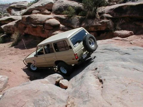

i'd go 4" for 35's, especially 12.5's...here's 33x10.5 stuffed on a 4"
