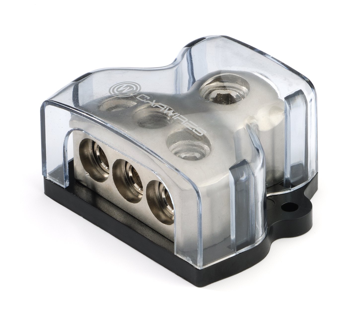

Don't forget also sometime in the future you may want to add LED work lights on a rack in the rear. I'd recommend a Power Distribution Block for future wiring. Bring a 0 or 4 gauge wire direct from the battery (or 2nd battery). You can tap into this for power needs (life a fridge). I have two behind the right side cargo panel (were the 8" woofer is). Makes it easy for power needs. Just be sure and add a fuse at the battery side. This is what I ran for my amp and block... Boss Audio KIT2 8 Gauge Amplifier Installation Kit

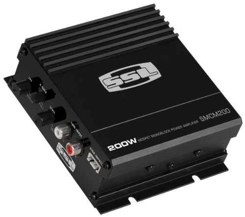

Also -- the cubby hole on the right side is a great place for a rear subwoofer amplifier. A small mono block fits in the easily.
This is the one I'm using for the rear/right sub -- SOUND STORM SMCM200 Mini 200-Watt Monoblock, Class A/B 2 to 8 Ohm Stable Monoblock Amplifier - but any compact amp will work.

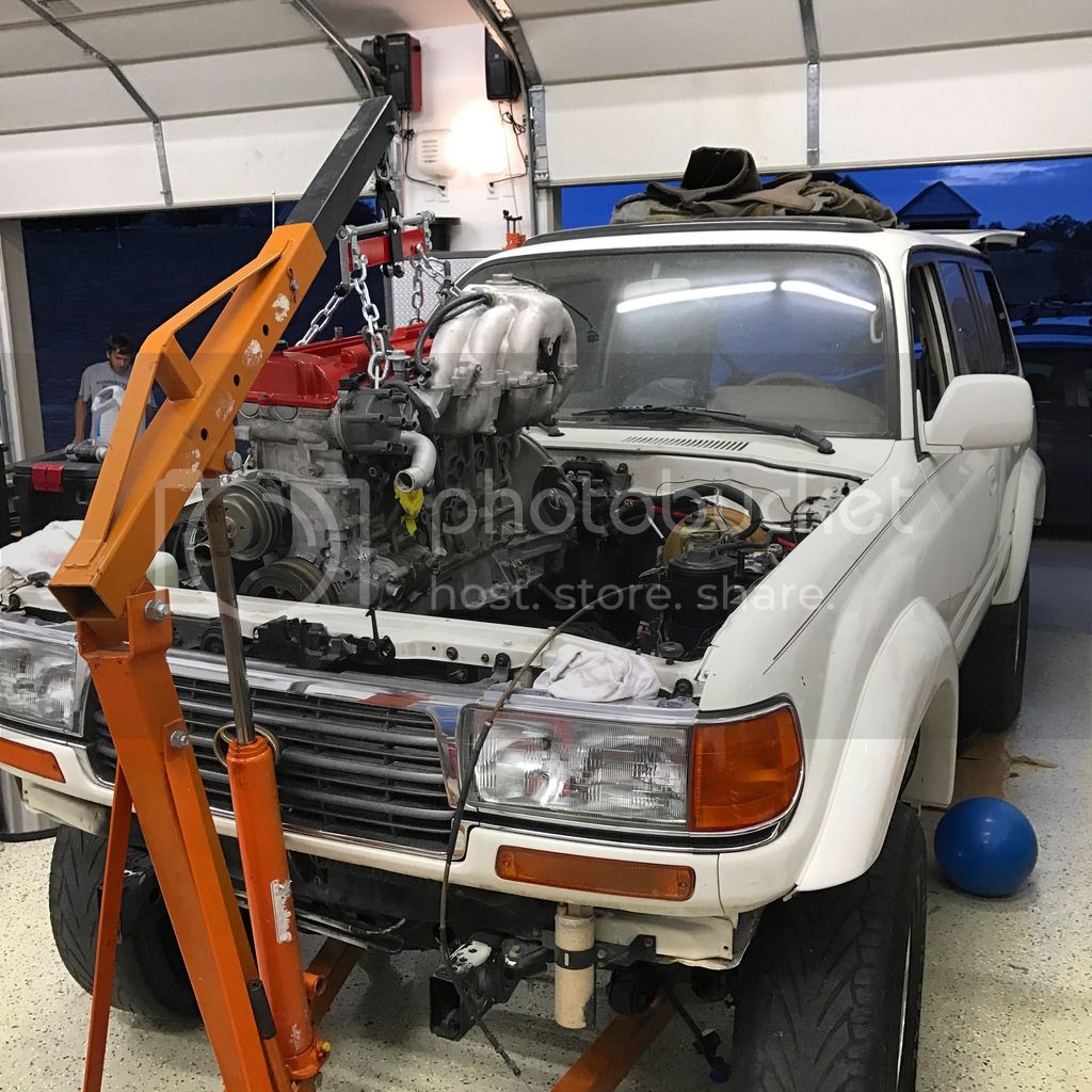

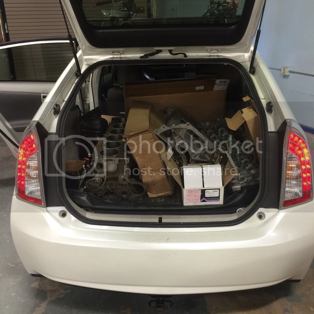

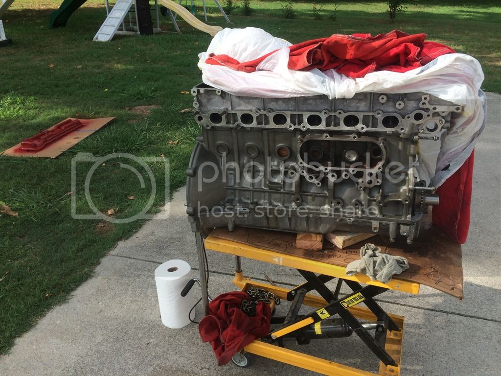

Who would have thought a Prius could handle an Inline 6!

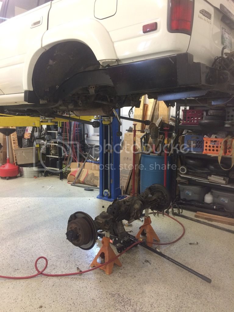

With the rear seats out did you do the fuel pump sock, etc?
Can't believe you left the old busted s/w in the picture with all that fresh dynamat. :flipoff2:
