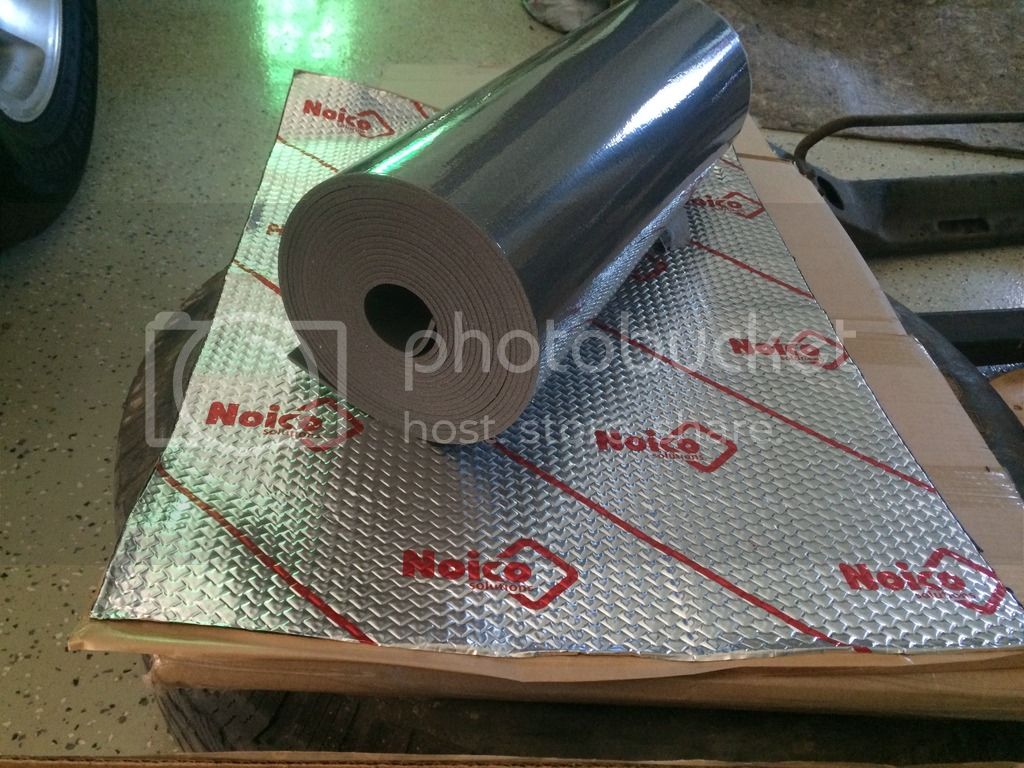

Ok, so a little confusing with the sound deadner that I'm using. The noico sound deadening mat paired with the noico liner. Some people say to put liner first in order to separate the sheet metal but that seems backwards to me. Anyone had any experience with this particular brand/ application?

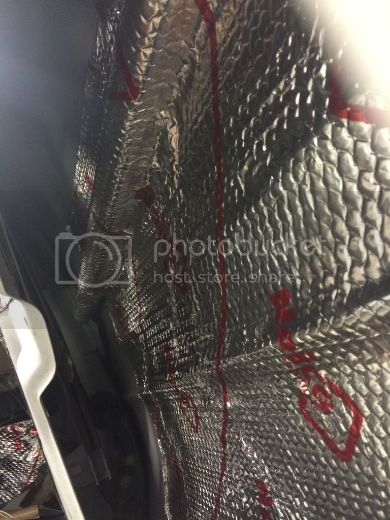

I would definitely recommend this stuff. It's easy to work with and the size is perfect for our panels too. The door panels have plenty of big holes to get access to the door skin in order to dampen it. Worked really well.
While you have everything yanked out Dynamat (or sound deaden-er of your choice) everything you can get to! I did the same thing with my 96. Reskinned the front seats/center console/door arm rests, new carpet, new stereo head unit and speakers.
It's amazing all the years of funky smells that the carpets absorb. Ours now is super quiet (as compared to before the sound mat), and smells like a new car. Wife is happy - so now she's all about more adventures.

Thanks! I can already hear a big difference when shutting the doors even with the door panels off.
Sound deadneros done (besides headliner), making subwoofer mount for side, putting putting in all new speakers, wiring up an under console inverter and adding USB ports to front and rear. Anything I'm missing?
Now's the time to run wires for future use. Extra lights, inverter, etc. Don't forget to wire in a back-up cameras while you have it all pulled out.
Also - CB/HAM antenna cables. Whichever you plan. Now's also the time to put in new speakers in the back over head cargo area.
Also - is you rig wired for towing? Nows the time to do it, and do it right.
