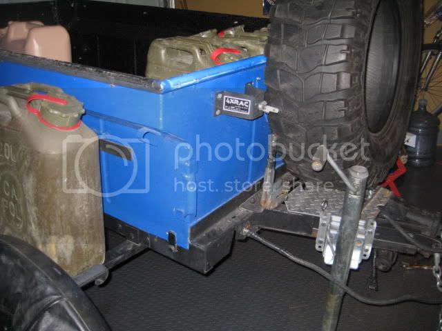

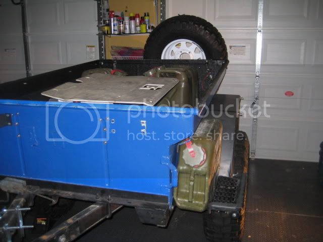

....snip.....So I add some fuel cans to the front to off set the weight of the tire. ......
On the fuel cans..... are those Giant Quik Fist straps? Thanks!
Yes they are the quickfist clamps.

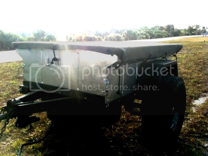

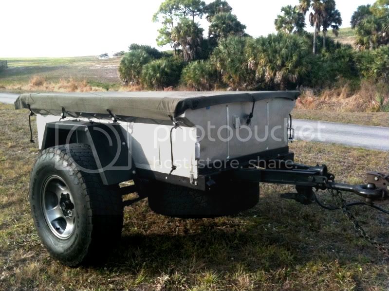

along the lines of the OP's original intent of keeping the rig self contained and tow capable... with any rig.
and in my goal... of keeping add-on weight as low as possible.
and so.... I'm sticking with originality of the military tires.
7.00 X 16's... with future replacements likely to be 7.50 X 16's
This is on my '53 Strick M100... but this method could be utilized with most of the WWII typical trailers and the "A" frame type drawbars
click thumbnails for larger pics.
^ was in progress... so some details are missng in these pics.
The rear is also getting a spare tire mount out back.
At that point... I will be making a basket type, bolt on holder, that can hold fuel/water cans and if goes as planned...
I'll be able to swap that basket/tire to either the front or rear tire mount(s).

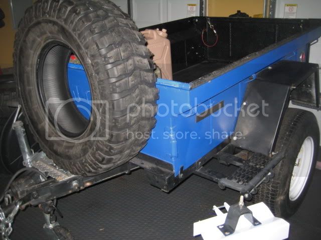

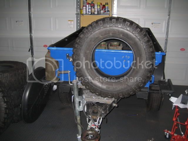

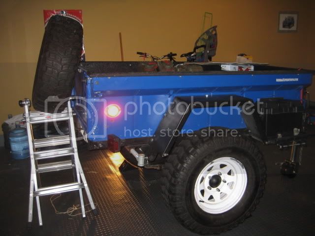

i thought it would be possible to mount the 285s on the front of the trailer sio i came up with idea of using an fj40 tube swingout tire carrier it will also save my tailgate. heres the mock up pic, ill post pics when its done.
it will be on a left side of the trailer but i will balance it with some gas cans on the right.

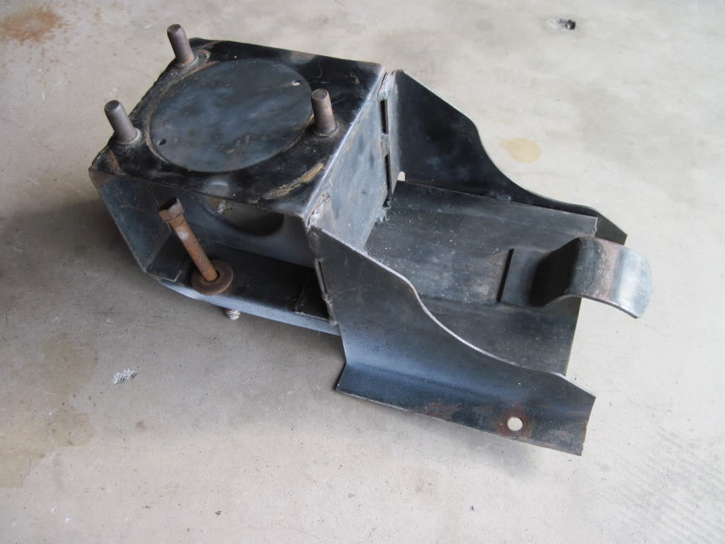

so the fj40 swingout tire carrier came in (thanks davegonz)did a mock up again and here it is , looks like its gonna work. will need a mounting plate welded on it.
my personal choice... is to have the tire's weight centered.
But it looks like that could work, if it's no consideration of yours.
I too like the weight centered. While the gas cans will help to balance what happened once to use the gas.

primary reasons for my choices...
1. ...load balance, (as was mentioned)
I prefer my tongue weight to be a little heavier, when light or unladen
as that helps the trailer track better when light or empty.
2. ...maneuverability and protection
My spare tire is mounted, centered over the drawbars,
doubles as a deflector/bumper when the trailer is jacked to 90* and a little beyond.
Helps keep the side of my junk dent free, as I prefer :)
Should be obvious that my M100's tongue needed to be lengthened... in order to accomplish my goal.
as well a proper rear bumper that offords side protection.
^ this was during mock up... but didn't have any other pictars in a 90*, that shows the final product.
But it can be easily seen in the last pictar, that the spare acts as the 90*+ stop, up against the bumper's side protection hoop...
without anything else making contact, I might add.
And the tire will deflect/absorb some (dependant on PSI)... so making contact at 90* is not a worry...
for most usual duties.
this was the final positioning of the forward ST mount.
and it serves, as was intended :)

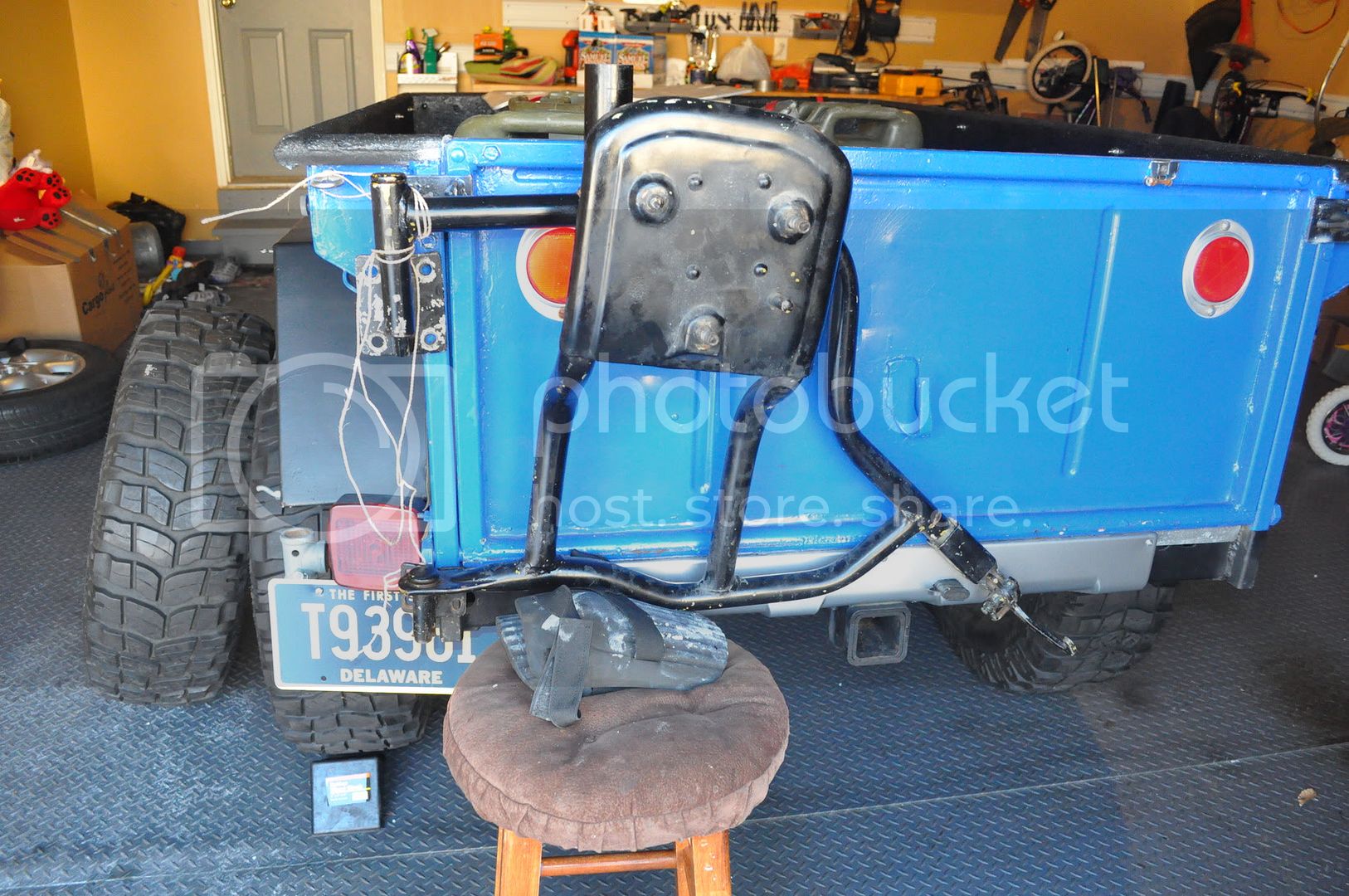

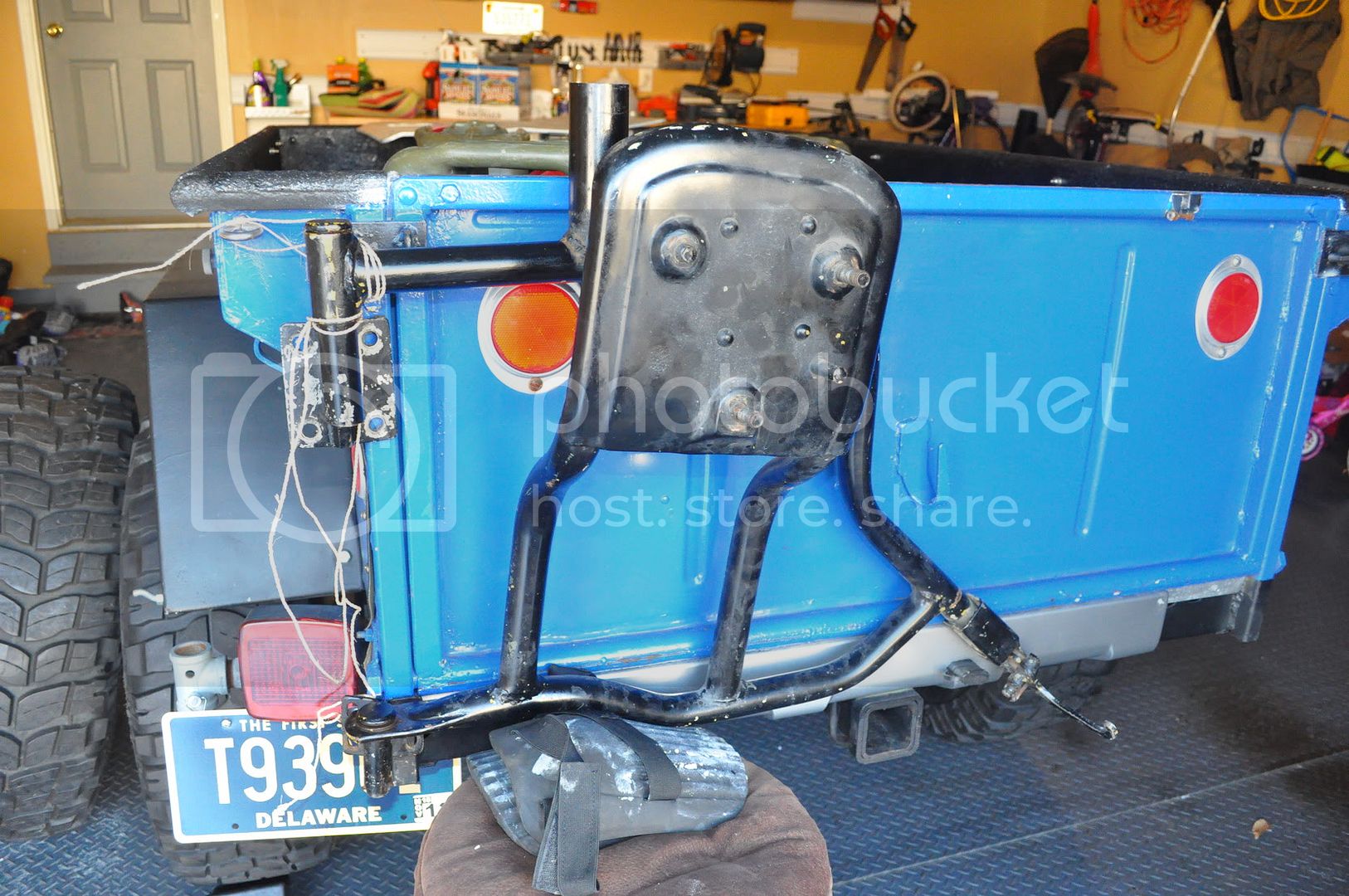

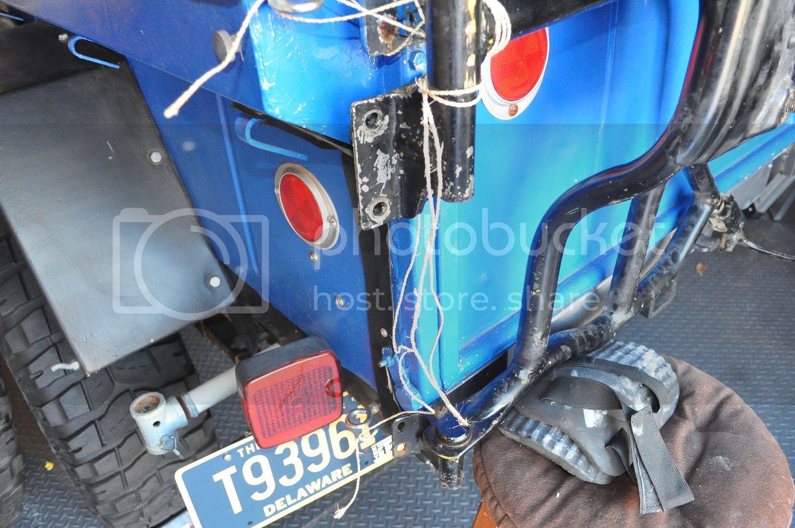

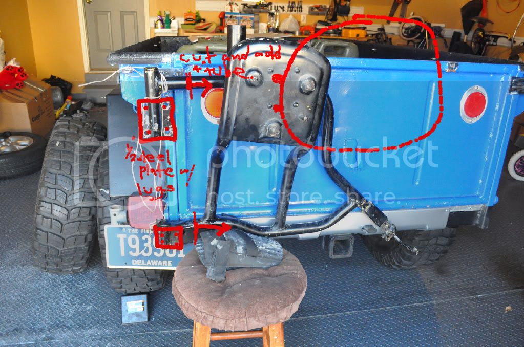

so heres what i came up with
1) 1/2" thick bolted steel plate will be welded /area will be reinforced.
2) tube of the swingout will be lengthened to bring the tire dead center.
3) bolt pattern will be modified to fit my wheels lug pattern.
what do you think guys.
You might want to add some bracing when you extend it. Maybe:
1) top to bottom just to the right of the two hinges
2) lower left to upper right
The less flex, the longer it will stay together. What is the OEM inner diameter? Will you use some tube with that outer diameter to sleeve the joint?
Besides just bracing I would use the rubber cushion the factory used. The hook on the end was designed to the carrier into the cushion so it could help support the weight. You extend the tubes and mount the tire on the end you given it a bunch of extra leverage.
i will suggest the bracing to the welder, thanks for pionting it out.
the inner diameter is 1'' 1/8 , tube will be used . i will suggest to sleeve the joints , thanks again.
all the oem parts will be used , thanks.

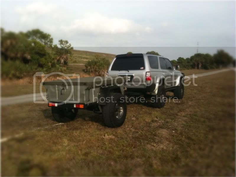

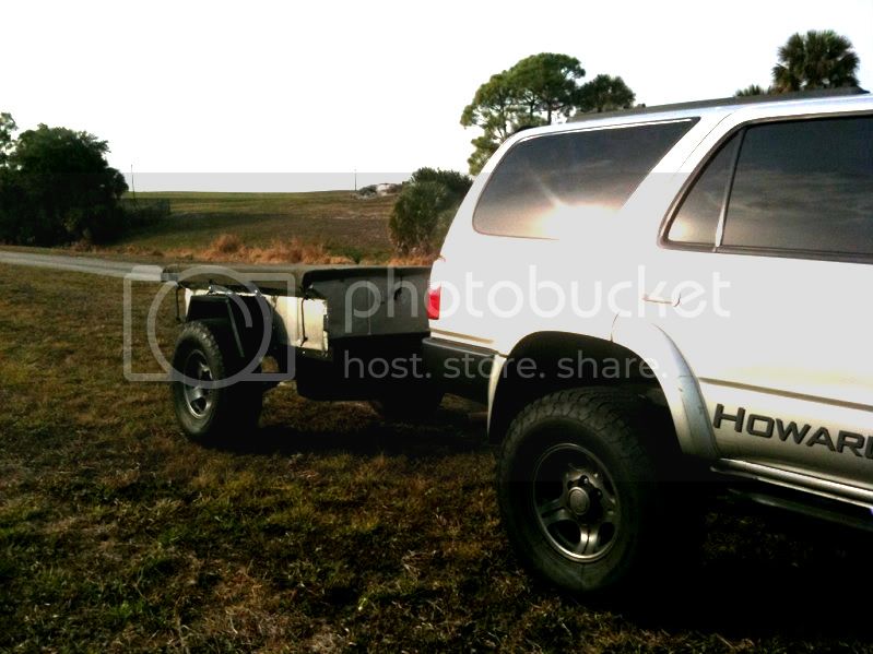

While certainly not the best or most ideal spot to mount the spare I used a 4Runner tire winch. Still running matching 295 Nitto's the spare hang down more than if I were to use a 285 or 255.
A
This is true, the tire hangs lower than the axle. The intention behind this was the trailer serves as a base camp to begin with and will not be following the tow rig everywhere. Since a majority of my travel is from state park to state park with the occasional hotel stop for clothes washing. And like anything else, if it becomes a problem I'll move it.
