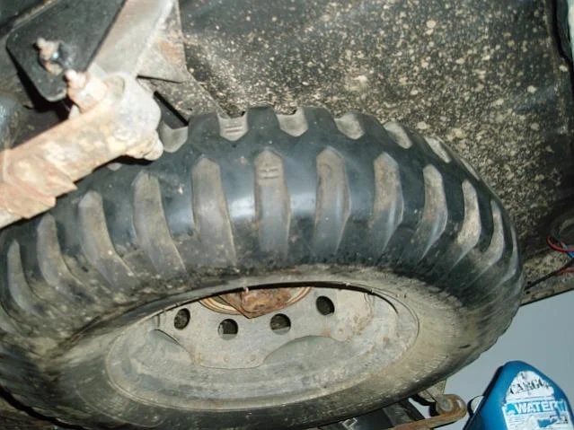

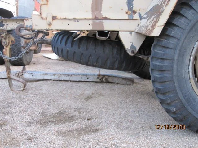

I used an old crank up mount and kept one of the old military tires for the spare.
What kind of crank up mount have you guys used?

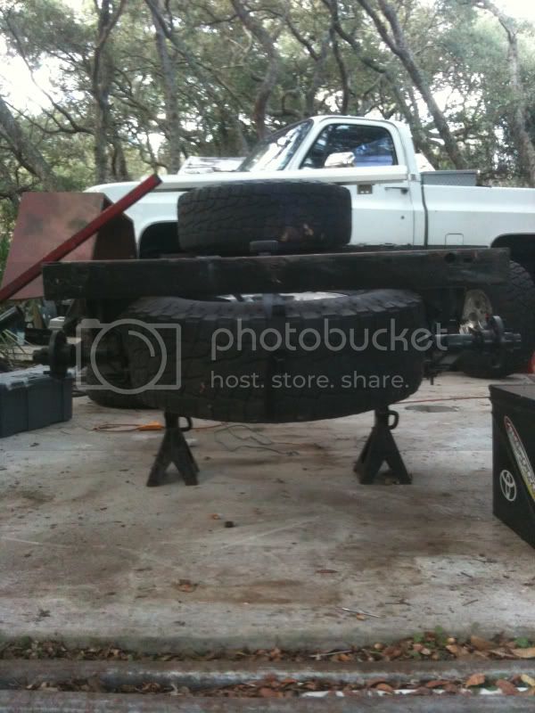

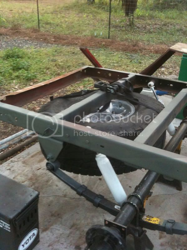

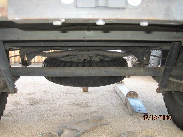

I bought a 4Runner style crank so that it would match my ...well 4Runner and I wouldn't need two cranks. You can fit up to a 295.75.16 aired up in either the front or the rear using the 2nd cross member in as the mount point. This idea hasn't taken shape just yet but I have the tire in position to give you an idea. Yes I know the clearance will be limited offroad, but since the idea for the trailer was to be a base camp for exploration it's capabilities do not have to match that of the 4Runner.
I'll get a better shot next week, but uninflated the tire could be sucked up more (this is how I fit the 295 on the 4Runner in the spare spot underneath).

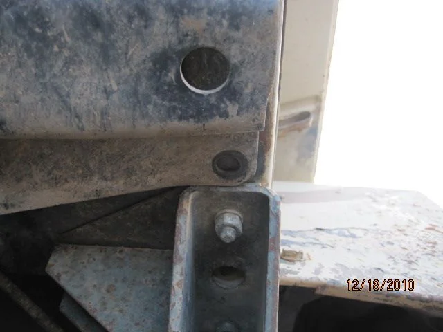

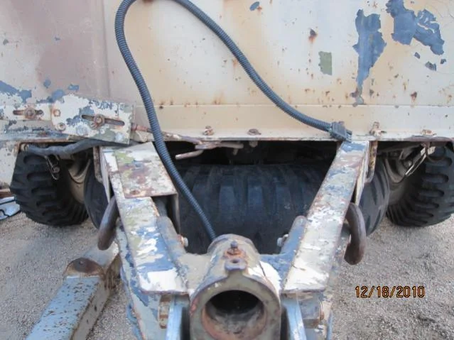

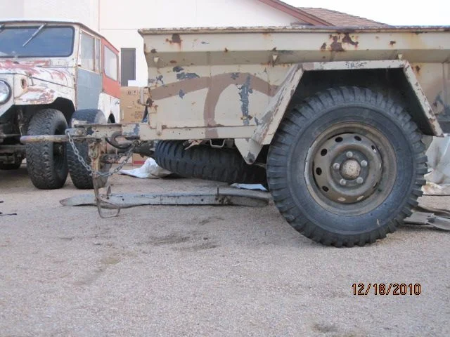

I took a look at the trailer carrier today. The 60 series is a perfect width for the M416 bit it seats a lower than I like. But since I use mine on the highway quite a bit I will probably install it for know. To get it far enough back to clear the landing leg up front I need to unbolt the front spring hanger and had the front bolt spare the same hole as the back hole in the tire carrier. Then shim the other three hole of the spring hanger to match. Then just drill a hole on each side from the front hole in the carrrier. Using the trailer cross member would probably keep it up a little higher I don't like the idea of putting the tire weight on it.

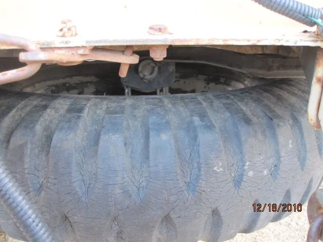

The crank up mount that used came off of a 4runner that had been traded when they were doing cash for clunkers
If you don't need the tongue for extra storage this is a super easy and cheap way to mount it. I have had mine like this for several years with zero problems. It could be mounted even closer to the tub if I did not have the RTT on it.
I just went to Lowe's and bought some threaded rod and some bolts with large washers. Then just lined it up and drilled two holes into the tub.

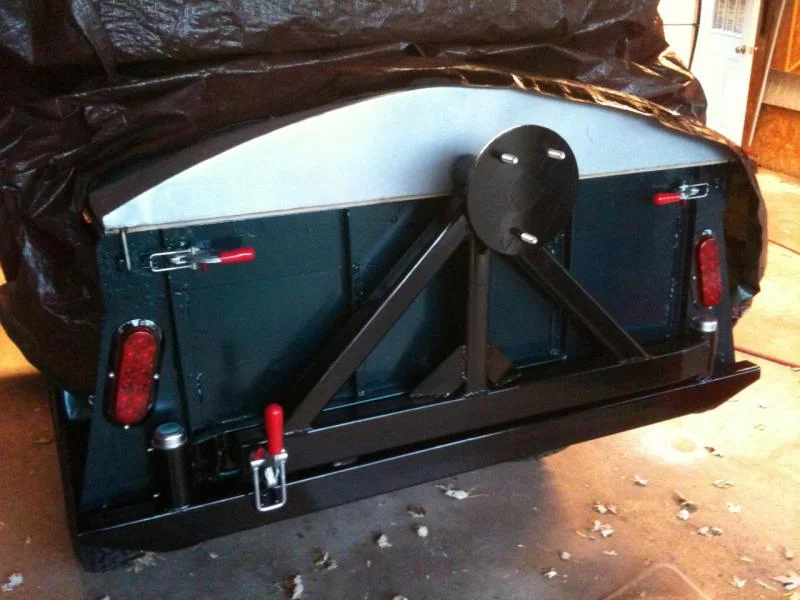

I like mine on the back.
The only thing with the tire on the back is that it made the trailer back heavy. So I add some fuel cans to the front to off set the weight of the tire. (I wanted to do this anyway)
