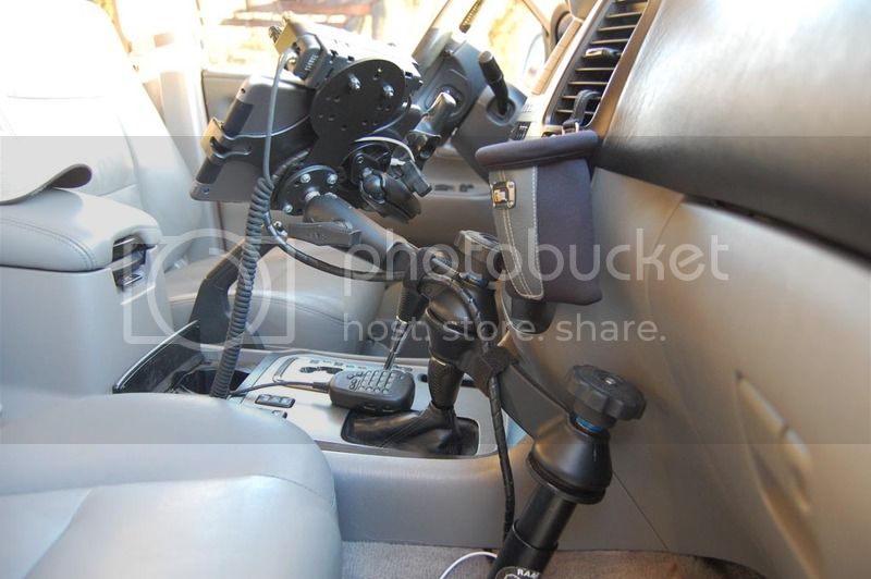

Jotto mount Police, EMS, and fire figured it out

Jotto gives you the ability to do anything up, down, left, and right. Been running the set up in both my 80 & 100 first with a laptop now with an iPad never a vibration and strong enough to sit on. Seen 1000,s of off road miles and still as solid as the day it was installed. Disclaimer both post mounts are custom and more solid than anything bolt in I have come across. The flexibilty will get away from the passanger making it wife friendly.
View attachment 1342313 View attachment 1342314 View attachment 1342315 View attachment 1342316 View attachment 1342317
